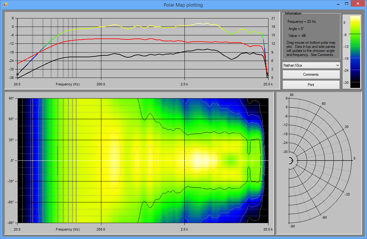

Unfortunately Earl's polar app doesn't show 360°, so any speaker that performs good in the frontal half comes out as a "winner". Hypercardioid, anyone?
I'm wondering how the Nathan 10ca can have such a high DI at low frequencies?

By the way, what's up with the strange DI plot at low frequencies for some of the newer data sets in your polar app?

I think that I said that the DI below the 200-300 Hz point is based on data taken near field and as such is not always correct for the technique that I use to calculate DI. I have had trouble getting a 0 dB DI at LFs to match with the DI above 200-300 Hz and sometimes the software does not produce such a good match. Above 200-300 Hz the shape of the DI is very good, but its actual value could be off by the same amount that the LF DI is off from 0. I don't use the DI data so much for its absolute value as I do to insure that there are no DI aberrations through the crossover. The absolute value of the DI is not important in that case, only the shape matters.

Err, the shape matters? You show a DI that simply doesn't reflect reality.
