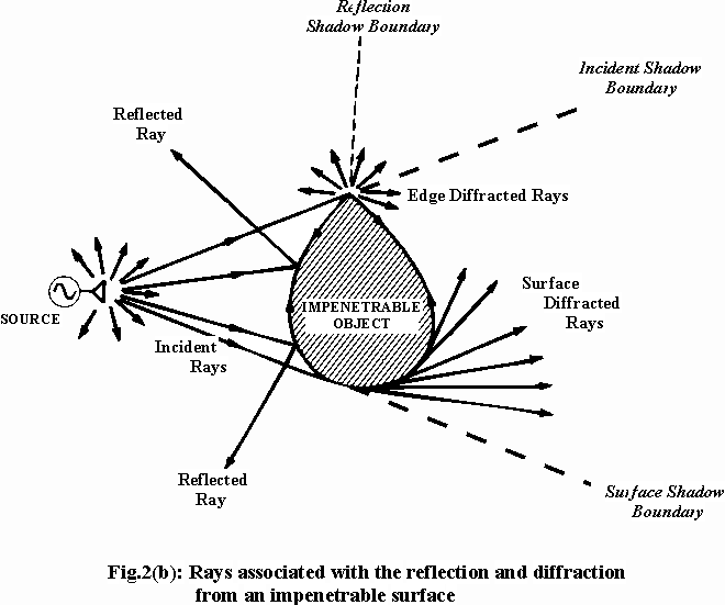

Diffraction Revisited Briefly
a) If the surface has curvature that recedes away from the direction of propagation then ......
b) If an edge (feature with dimensions << wavelength) is presented then ......
WHG
Interesting for me: using OSWG, and if the expectable off-axis angle is about 45 deg, it is quite visible that the angular increment of the horn-wall is relative fast near the horn-throat, and as I understand such would not produce diffraction, so why not to use the same 'principle' on the horn mouth.
regards
ivica
WHG

I'll take a stab at this ... the incident shadow boundary can be represented as a straight line along it's point of incidence with the sources transmission. Lining up at a third point in space (beyond the incident point) puts your "eye" on the boundary when the source, the diffraction point and your eye are in alignment. The incidence shape makes this possible.post7113
what is the difference between Incident Shadow Boundary and Surface Shadow Boundary?
The shadows boundary is less precise and it's boundary path will be dependent on the curved surface of the incidence. The curved incidence shape makes the actual point of incidence less defined.
To me and my understanding, it would be the radius of the curve that would define the shadow boundary. Since there is no clear incidence the shadow boundary will bend along the radius.They both diffract and both have a shadow boundary defined in the exact same way. The only difference is the radius of curvature of the two different edges.
To me the two boundaries are the same thing with different parameters. One edge is sharp and one not so sharp. They both diffract and both have a shadow boundary defined in the exact same way. The only difference is the radius of curvature of the two different edges.
As I understand, smaller the radius wider the diffraction area.
