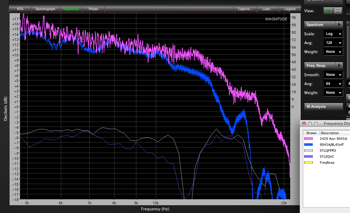

After reviewing some data I have to disagree with you on this, though Legis claim of the 15 degree conical horn in the throat of the JBL 24XX series horns affecting dispersion down to 3-4 kHz is stretching by a bit more than an octave. I think Legis initial parabolic expansion coupled to a conical expansion is doing some weird stuff ;^).
That said, the beaming of tractrix/expo etc. horns he mentions has also been pointed out by you on many occaisions.
I have a comparison below between a JBL 2420 (1" exit) with the 15 degree horn snout on a 90 x 45 conical horn and a 1.4" exit "pancake" Celestion CDX14-3050 on a 90 x 40 conical, with injection ports. The injection ports have little effect, the deep hole in the response of the driver at 12kHz is there with or without the ports.
Both horns have the throat entrance smoothed. The 45 degree off axis trace has been raised by 6 dB in both cases. The CDX14-3050 (STEQ) was equalized (roughly) flat on axis, the JBL is unequalized.
Though the JBL shows a clear narrowing trend above 10kHz, the pancake driver on axis and 45 degree off axis response are within a dB from 12 to 16 kHz. With the general design of the two horns being the same, the charts clearly exhibit that it is the narrow JBL throat that narrows VHF dispersion.

I'd think it would be obvious to you that a narrow throat is a waveguide at VHF, regardless of the horn or waveguide attached to it. The only way to make a narrow throat horn disperse wider than the wall angles determine is to pinch it to as small as the highest wave length, as JBL does in their designs.
My simplistic explanation of the fact that an OS waveguide has a lower DI than a rigid piston in a baffle is a waveguide's (driven by a small exit diameter compression driver) directivity is determined by the wall (guide) angle, a rigid piston by it's diameter. A rigid piston will narrow in dispersion as the wavelength approaches the diameter of the piston, while a waveguide's dispersion (diffraction) will widen when the wavelength exceeds the diameter.

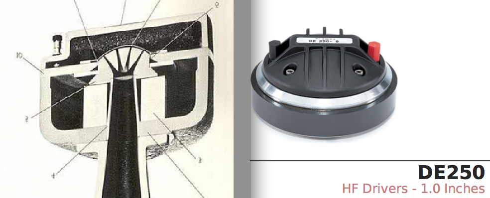

Art - this is simply not true - as I understand your comment. If you mean the wall angles of the driver then I do disagree. If you mean the wall angles of the waveguide then I do agree.
An OS waveguide does (and this is clear from the data on my website) yield a wider directivity than the attached driver's wall angles. That is clearly the case with the DE250 which has an exit angle of 6 degrees and yet has a HF coverage of 45 degrees.
Doesn't that DE250 have something like a 1/2" exit size? I fail to see how you can discount the exit diameter of the device. You are saying the exit size is insignificant but then say a 4" exit driver would drop like a rock at higher frequencies? We are all having some disconnect in how we are communicating here is seems.
Earl,
The DE250 has a 1" throat exit of 6 degrees, but the throat is clearly too short to be a waveguide at VHF.
The JBL 24XX drivers have a 7.5 degree throat of sufficient length to be a narrow waveguide at frequencies above 10 kHz, if you placed an OS waveguide on those drivers, the VHF dispersion will still determined by the initial conical horn section wall angles.
Art
Art
