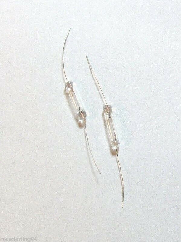

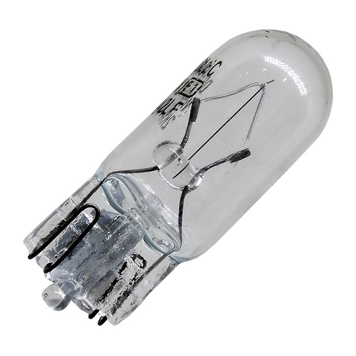

When one of my Carver TFM 15CB meter illumination bulbs went out, I didn't replace them with "factory"...I repair creatively, I measured 18V split in series, so of course when just one goes out it takes the other one with it. A 12v automotive bulb jockeyed into place...24V rated, driven with 18V.
----------------------------------------------------------------------------------------------------------------------------------------------Rick...
I get around that by using lamps off LED strips, and sanding them a bit with 600 grit paper.
Those are 120 degree true angle, and the paper diffuses the light further.
So the effect is closer to incandescent.
You can buy the "frosted" LED's in any color or white.
Also, there are "wide angle" types.
Sometimes, for a standard clear LED, I'll use a Dremel cutoff wheel and cut the top dome off close to the internal reflector to widen its coverage.
Just don't get too close to that tiny wire inside.
Wide angle LED's are like this... I like them.
https://www.mouser.com/ProductDetail/Cree-LED/CP41B-WGS-CK0P0154?qs=D3QG1iK7FqioUoYO9Mm5zw==
For a few, I buy a strip, 90 LED per meter for about 70 cents....and flat top SMD, easy to roughen up.
5 meters strip will give me enough for the rest of my career as a repairman, I do this only for friends and family.
Works out very low, about 1 cent per piece, no variation as in loose LED, and available in many shops.
