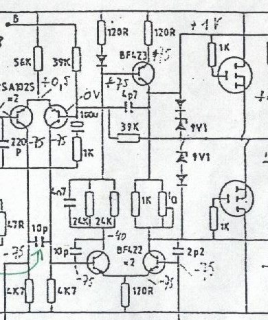

I would expect there are a few reasons for omitting the source resistors.
I further suspect that the designers had considered very carefully how to get a resistorless design to work properly.
If we knew what was in their heads we could try to emulate their design.
I reckon the best we can do is guess and accept the risks involved with our guesses.
Or perhaps just because the source is connected to 'case' with those Hitachi TO3 mosfets.
Or because they are immune to thermal runaway and secondary breakdown.
/Hugo
/Hugo
I don't know about electronics, but from what I read, and my observation on amplifier schematics, it is mainly because of the negative tempco.
About source connected to 'case', this has made me thinking, is it necessary to solder cables connecting the top casing of the mosfet like Conrad Johnson does ? I often do point-to-point so I have been tempted to do the same way, but it doesn't look pretty that way. I prefer a copper bar on topside of the mounting holes.
This might lower the possibility of oscillation...

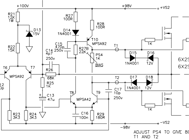

The CXfet ?? this is what I would throw at a good set of laterals if I was rich enough. 😀 I know that it is stable , 700k bandwidth / 75v+/us slew , and I know what it sounds like (BJT's) ... below. easy to source, as well. (10$ board - complete)
You are right , the laterals would indeed make the CX "sing"... 😀

I still think the laterals would sound better. EF2's and 3's can be close , but only with an exceptional input/voltage stage. The 2sk134/j49 , being to-3's, have a unique sound which I believe is 90% of the goldmund's "magic" ..seeing what a "trainwreck" the original goldmund circuit is. A simulation of .03% (goldmund) compared to .001% (CX) is enough of a difference to be heard in the subtleties of soundstages. This also reflects the primitive nature of goldmund's implementation of the basic hitachi circuit. Having actually built the CX and "crippling it" by replacing the VAS cascode with a simple resistor to make it like the goldmund , I have actually a/b'ed these two variations (for real) in the circuit. I am sure the differences would also be apparent after "going through" the laterals , as well. 🙁
Edit: We are only relying on one mans opinion of what "the best sounding amplifier " is. My experience also involves the above TO-3 Hitachi lateral pair. In the 80's a similar amp was produced in kit form and surpassed the 8000$ genesis stealth in it's audio goodness. If I remember right ,it was exactly like the CXfet without the VAS cascode (goldmund like). The only difference was the remaining 4 VAS devices were running at over 20ma and driving the laterals (2 pairs) directly ... like a Otala design.

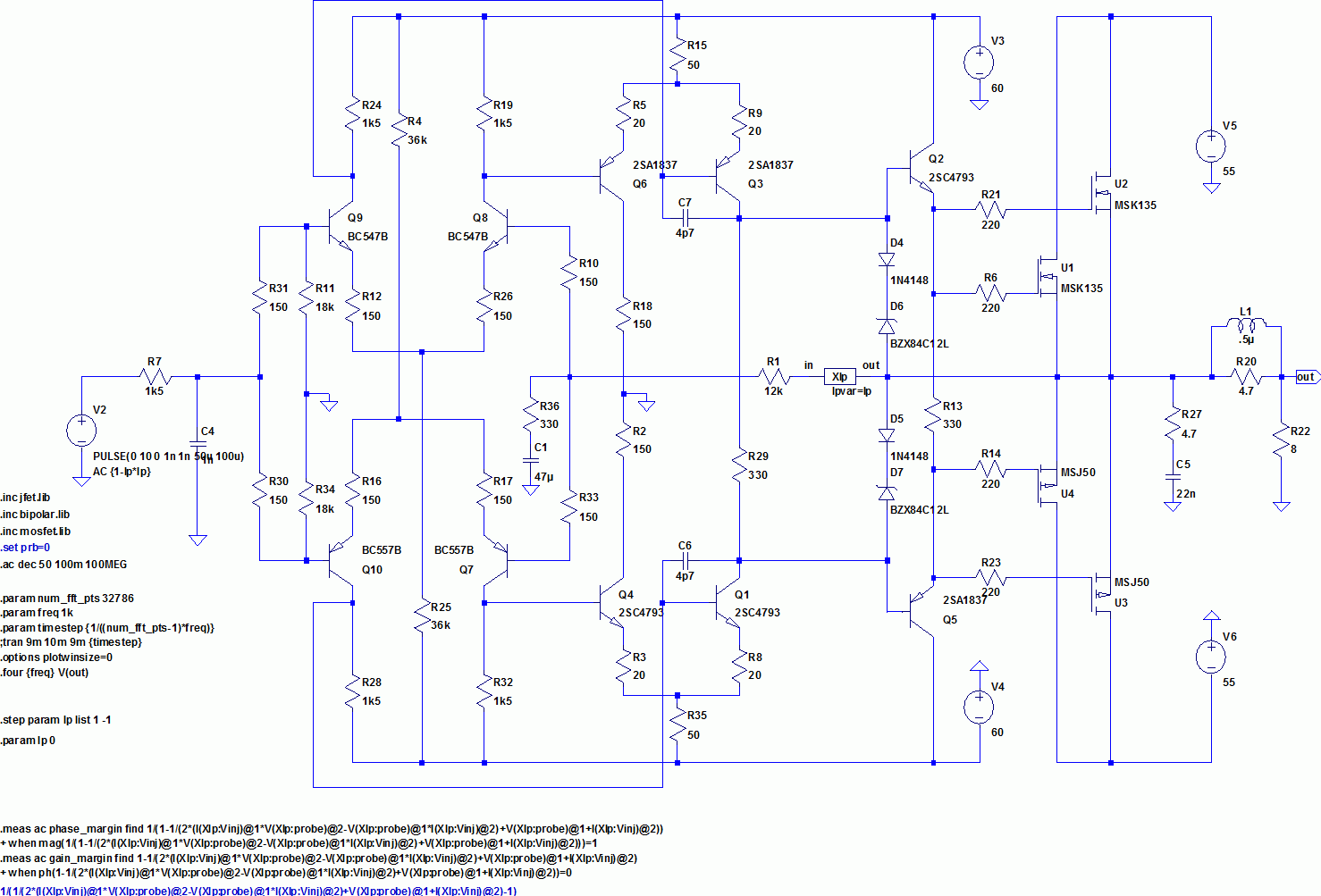

Simulation of both original (Goldmund_sim) and modified (Goldmund_sim_Kmods) schematic at 20kHz results in THD improvement by only 50% (from 0.02% to 0.01%). I fail to see how the 10 fold improvement seen by keantoken in the first post is possible.
I wasn't comparing keen's 2 simulations , I was comparing his best Goldman to my best "symasym" type voltage stage (CX). it's a miracle what 1 more device will do for a circuit (20-30 fold at 1Khz). These are just simulations , but reflect the overall linearity of the circuit(s). The less to correct with global feedback , the better.
The second factor besides the total THD is the loading on the input pair and whether it is balanced or not. In the goldmund's case , the current mirror is "for show" and could be replaced with a diode. (below HH lateral design)

A small issue with the simulation schematic is that the original Goldmund schematic has a 2k7 series resistor in the driver voltage doubler. This will probably drop about 50 volts (assuming 20mA current). This would also imply that the +-80V supply suggested by nagysaudio is higher than what Goldmund originally has. Does not make sense to have lower voltage on the driver rails.
