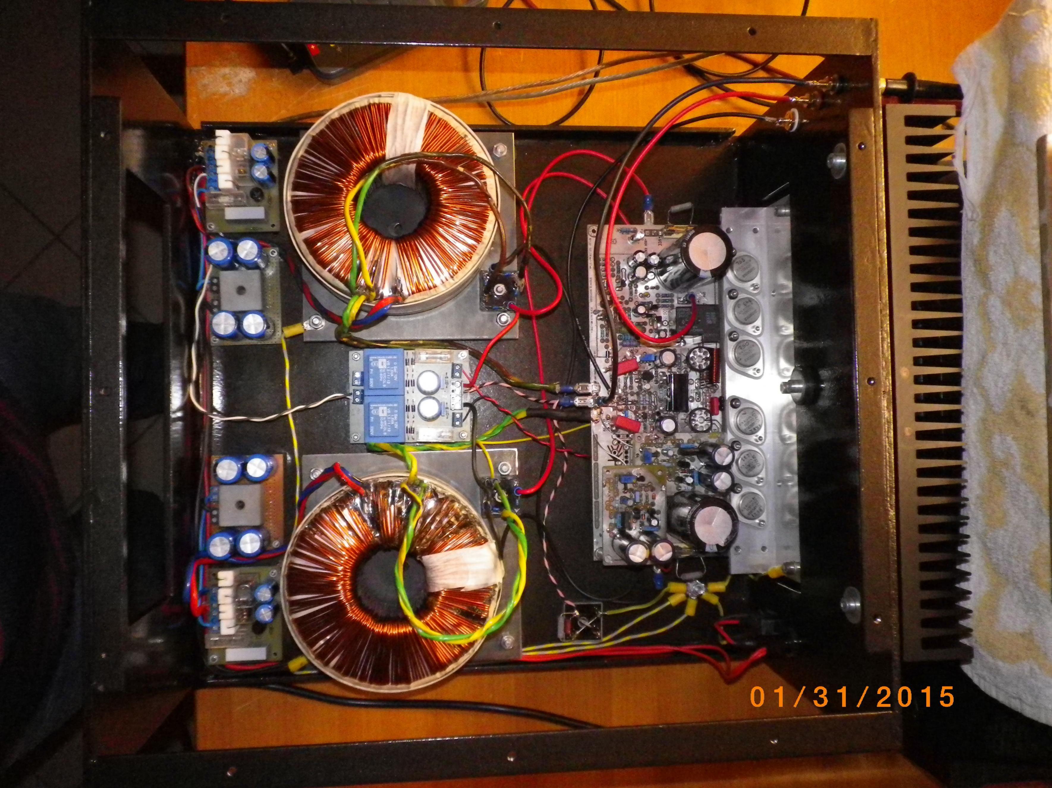

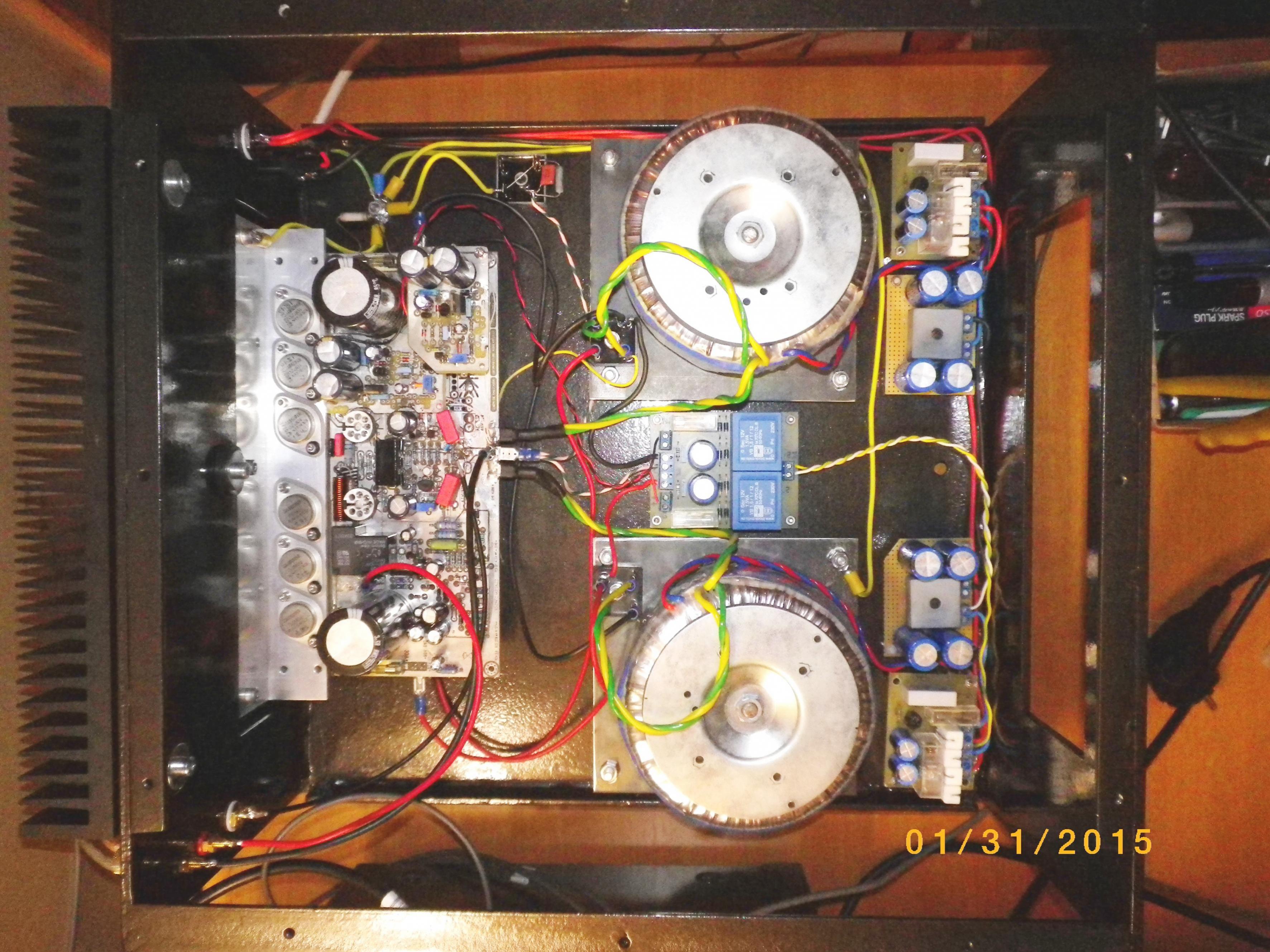

I run my main mosfets at 100-125ma per mosfet..
Hand made all...
600 to 750mA. That's a lot of heat for that L bracket to move to the main heat sink. Have you measured the °C of the MOSFET cases?
I recently measured some TO3's, 126mA quiescent per pair, and they were on what looks like thicker Alu, part of the main heat sink, not a bracket, and they were about 60°C at idle. Probably starting to increase their Ron.

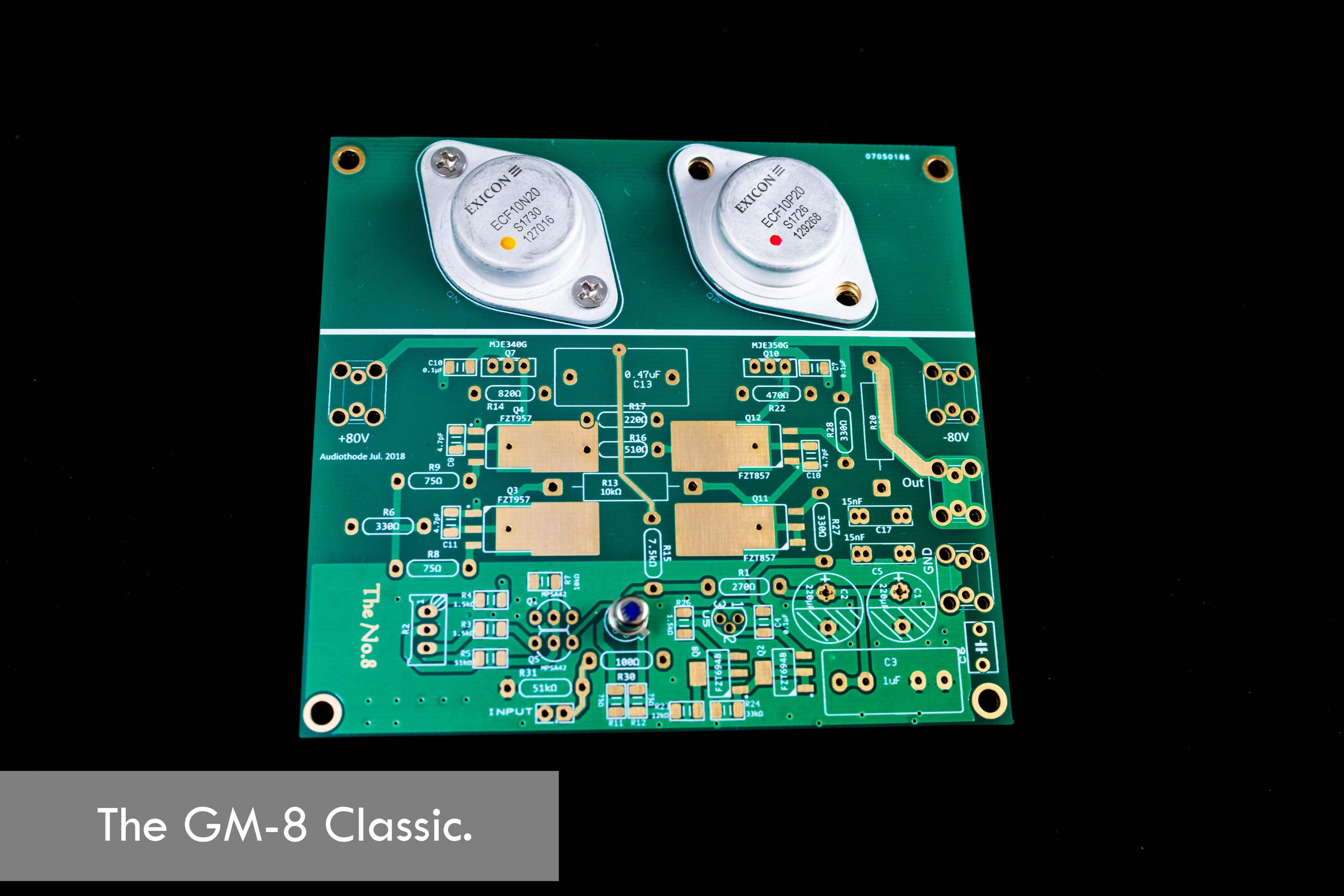

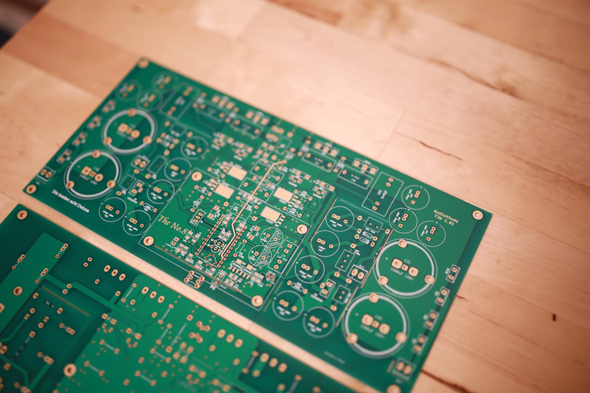

Hi all,
Finally, the two series of my 8th generation GM have already arrived.
I call them GM8-Classic and Deluxe.
The GM8-Classic:
  • 1 pair TO-3 MOSFET
  • mini size
  • gold-plated
  • no exchangeable module
  • no PSU
The GM8-Deluxe:
  • 2 pairs of TO-247 MOSFET.
  • Gold-plated with double thick copper.
  • Equipped with interchangeable module sockets.
  • integrated with rectifier/filtering.
  • Voltage doubler for front-end supply.
Hi Erikovsky, what rail voltages for these amps? I assume around 100watts? Which model are they based on? Do you provide any build instructions and BOM?
Hi Luke,
Thanks for the question. I run them by ~60VDC per rail, 1~2 pair. About output, yes, around 100W, I am using bookshelf speaker so no need for higher power.
The GM8-Deluxe with interchangeable module makes everything interesting. I am going to build a module with 2SK170 pair, without damaging the mother board!
Is anyone interested in Group-Buy of GM8-Deluxe?
I can make some very good quality Gold-Plated, 2Oz-Copper, 2mm-thick PCBs.;)

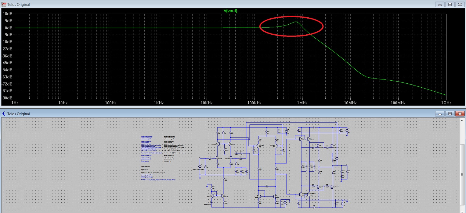

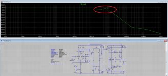

My simulation above uses 2N5566 model, if i use high gain JFET models such as K170 to replace, the oscillation even more worse.
On another hands, DIYers in my country who have tried to clone Goldmund next gen amps. Based on that information of next gen amps, i also tried to sims. Result: still oscillating.
How, how they fix problem?! probably GM sells their amps with oscillation. Is there any mystery?
Use source resistors on the Jfet to match the transconductance of the original FETs.
The simulation models for the MPSAxx transistors may not be accurate. That or they may be from a different manufacturer than what Goldmund uses. As an aside the MPSA42/92 are IIRC terrible transistors for this application when it comes to specs.
What you are seeing in the simulation is not oscillation, it is peaking/ringing. I don't know whether this is present on an actual Goldmund. Oscillation would be a constant sustained ring. Overshoot does not guarantee that an amp will ever oscillate in operation but peaking does increase the likelihood that it will oscillate during transients.
