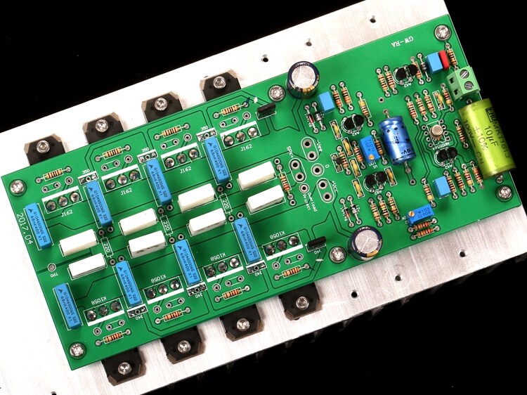

Here a few pictures. Prototype is working fine on my lab power supply, 470ma bias for 6 parallel Mosfets, 78-80ma per Mosfet (Exicon ECW10N20 & ECW10P20, selected part directly form Profusion, UK). This is a low power test, 2 Vac/1Kz into 8 ohms. Output waveforms are prefect, no oscillation, see waveforms. The output stage MOSFET are closely thermally coupled being mounted on a copper block, that is then bolted to the rear heatsink. The original Telos use the same arrangement, but thier copper block was gold plated. Mine is just protected by clear lacquer.

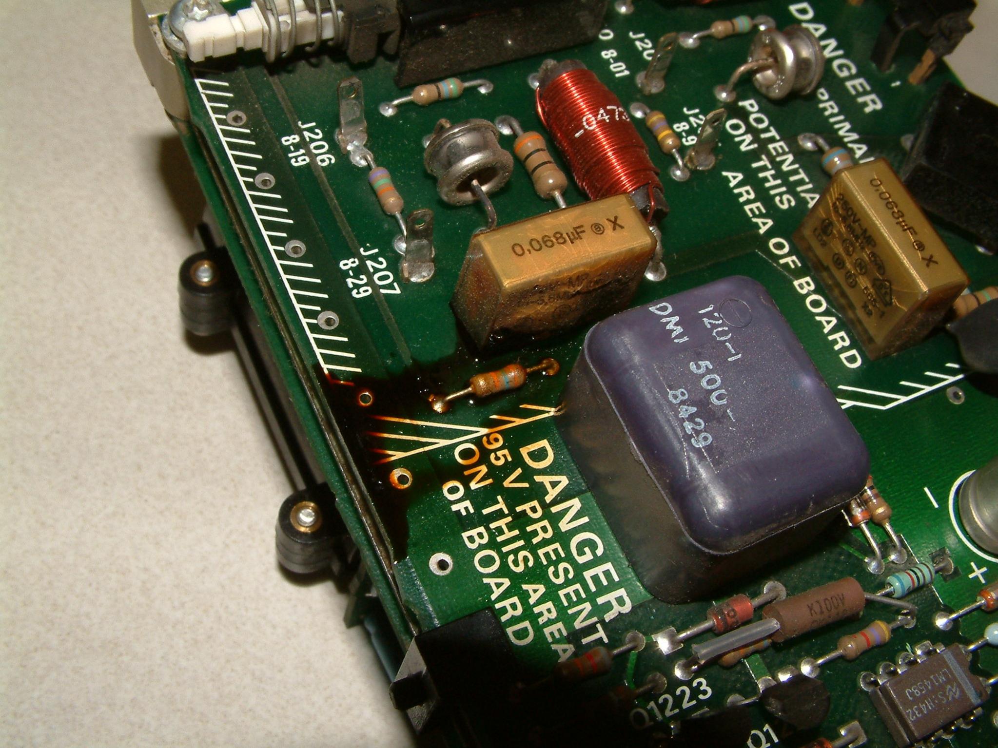

Worked for years in test equipments repair/calibration labs. I used to service these. Nice scope when it is working, a very complex machine to troubleshoot if defective. Mine I got for cheap, was not working. Took me almost two weeks, part time, to fix. Problem was an intermittent transistor leg. All the transistors inside this scope are mounted on pcb pin sockets. This particular one was deep down inside the scope. I had to dismantle the beast a few times just to test, check, and re-assemble to test. Took forever. Being working fine since then... I have two digital scopes, but the analog ones can't be beat to see everything that's happening inside an analog circuit.

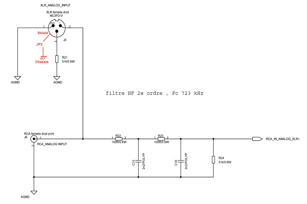

Will you be posting schematics? I am particularly interested in the balanced input and if you have unequal impedances on the + and - legs of said input.
Jam
Jam
Hi. Sorry no I won't. Only the actual GB PCB Set buyers will have access to detailled information.
But for the record the amp input is not a real Bal to SE converter, simply terminated the V- side of the balanced input. Here a partial schematic showing the BAL to SE input... This is the case for a lot of amps that have BAL input, simulated BAL is often the case when the amp circuit is basically just SE. BAL input really makes sense only when the amp is fully balanced to start with...

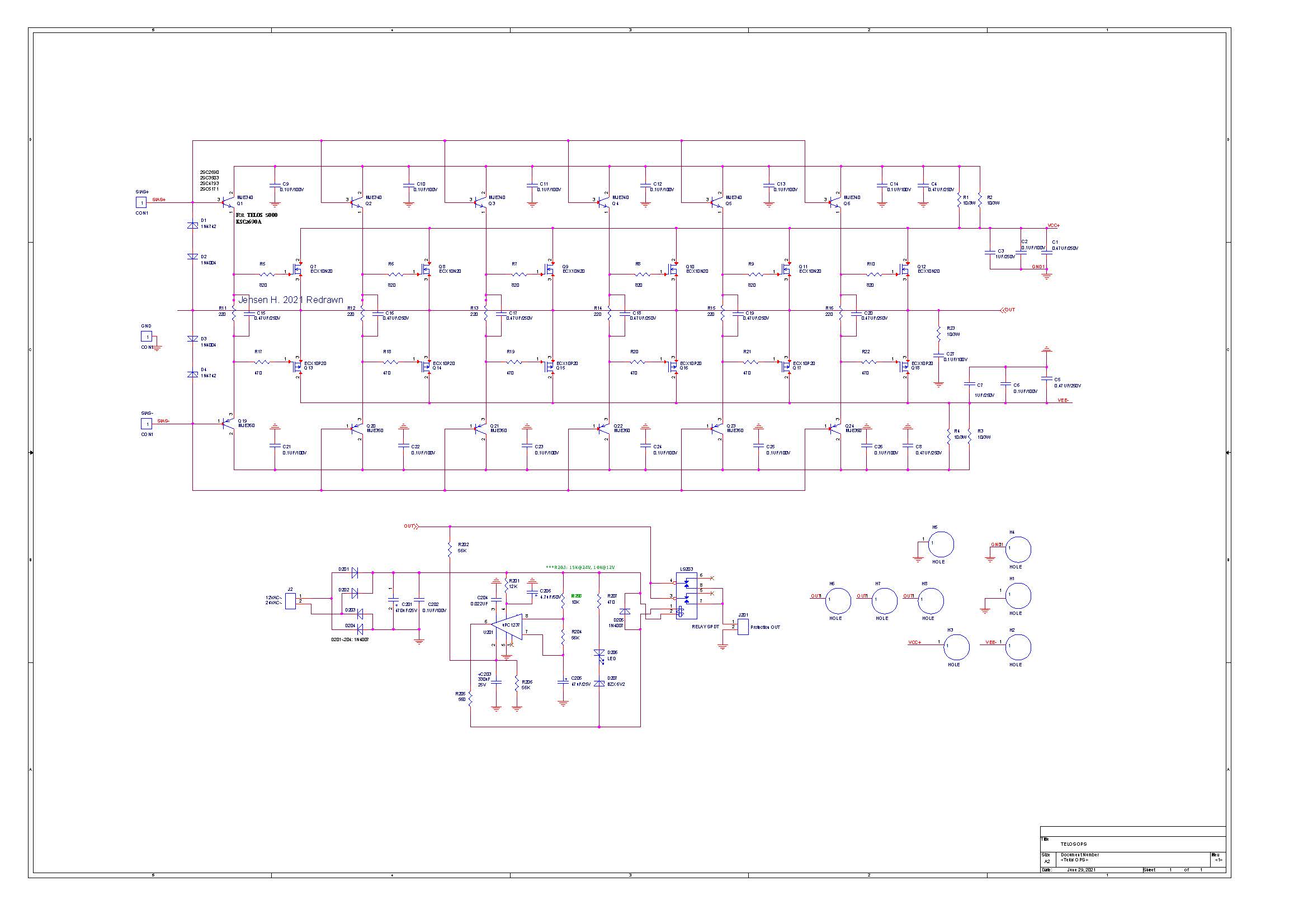

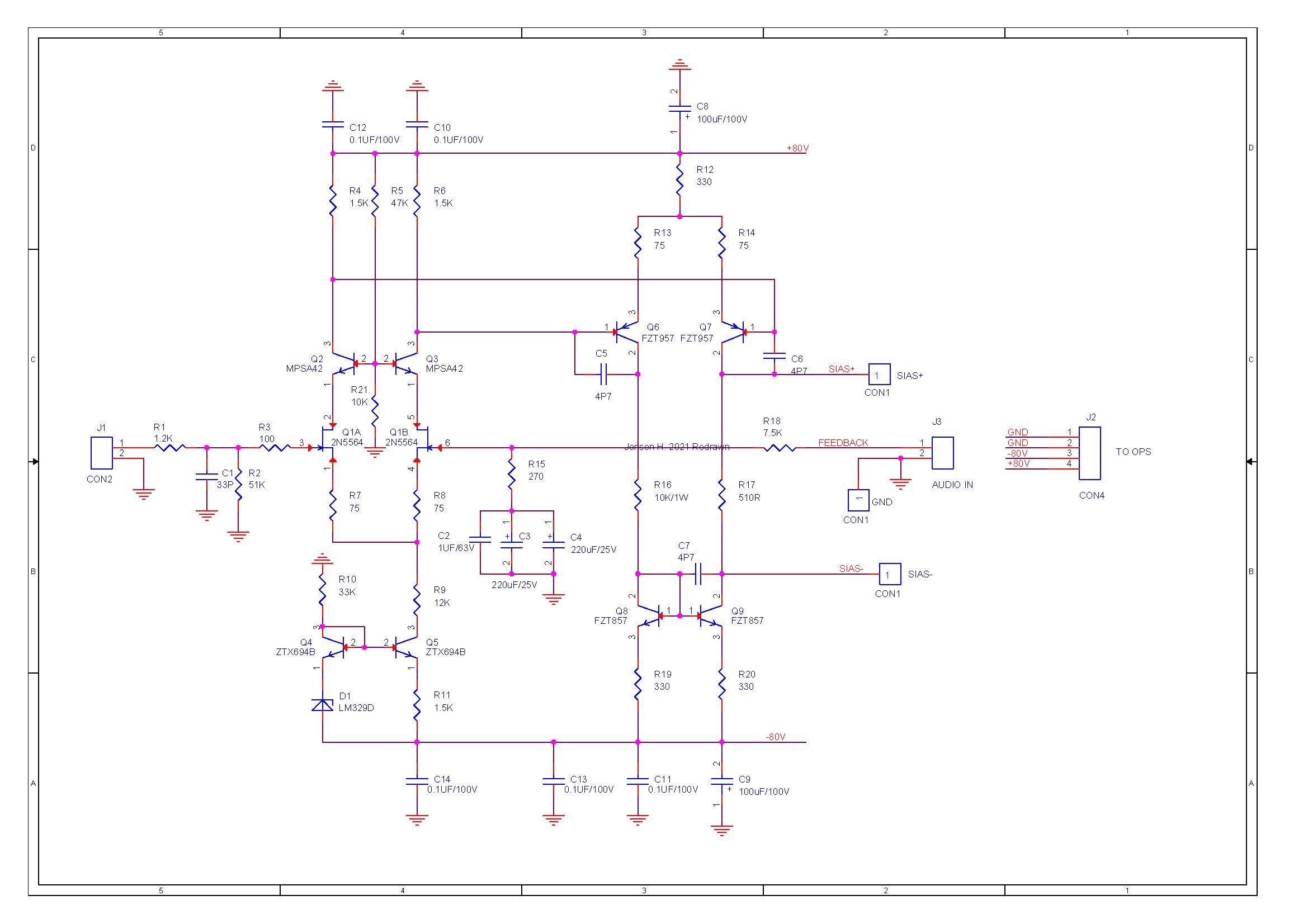

You could without the Arduino, but then you need a softstart circuit, and what would you do for the protection? The protection circuit is quite extensive as I said, and you need to manage the shutdown, control the supply Mosfet, speaker relay, etc...
This is a very close Telos 2500 monoblock clone. it is complex, and expensive to build. If you want just a normal Goldmund amp, without the rest, you're better to get the usual clone pcb... Keep in mind that Goldmund are notorious to be instabled, as some guy experienced with their clone on this forum. You need the correct PCB layout, correct internal wiring and ground layout, and good protection if you don't want to loose tweeters (depending on the huge area of different system, even stranger sometime in the DIY world, strange speaker cables, weird speaker crossover, etc).
I prefer to be safe and have a complete protection with this amp. HF oscillation detection in particular seems a good idea. Simpler DC protection is probably too basic to be completly safe...
And if you don't want anything too strange, build a Pass clone, inconditionnaly stable in any load, and they don't even botherwith protection, for good reason...
