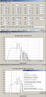

Try this. It is a smaller TH-Spud style horn that still uses two Tang Band W8-740 drivers. An Erse 3.6mH coil helps flatten the response out.

I worked out the folding for this horn. A few things changed due to practical considerations and fitment requirements. The resulting Horn Response parameters reflect the required changes. The exterior dimensions are 11 5/16" (28.7cm) deep X 27" (68.7cm) wide X 38" (96.3cm) tall. Total folded volume is 6.7 cu. ft. or 189.86 liters. I think this is a lot of horn in a pretty reasonable sized package. Panel thickness used is 19mm or ¾”. An Erse 3.6mH coil is added and the Tang Band W8-740 woofers are wired in series for an 8 ohm load. An amplifier capable of 500Wrms into 8 ohms should be more than enough. Its Max SPL level well exceeds THX standards. I'm seriously considerenig building a pair of these once the weather clears up.

Switch the expansion from "CON" to "PAR" for a more accurate sim of a horn folded up into a rectangular box.

I tried your suggestion. It virtually made no difference. I can barely see the difference when I do the "compare previous" command. Historically, my Horn Response predictions have measured very close using Conical sections for the simulation. Is there a significant reason for your suggestion? Did I miss a conversation somewhere?

Expansion in a horn which has two parallel sides (basically almost every horn folded into a rectangular enclosure) is parabolic, not conical. A search for "parabolic" on this forum should turn up the message threads where this has been discussed.

As long as none of the segments are extremely long it won't make a significant difference in your graphs (depending on how you define "significant", I guess). It will, however, make quite a big difference in the net volume reported on the Schematic screen.
I noticed that the specs you used are not even close to the published specs, are they measured specs? If so, what was the Le? 1.8 less than shown?
EDIT - a quick search for your name and keyword w8-740 shows these are measured specs, and Le is 2.8 before adding 1.8 mh of extra inductance, as I thought. I just wanted to make sure I was following what you were doing.

You got it correct.
Edit - Changing to Par only added 0.83 liters to the horn volume. That's not significant in my book.

No, it's not. Usually there's quite a bit more discrepancy when switching from CON to PAR but I guess not in this case. I just use PAR when possible to avoid the issue. I have noticed that the larger the segments are the more difference there will be between CON and PAR, especially if the segments are long, and that's as far as I have studied this issue. For example, if the segment is ridiculously large you can see a difference of 1/3 volume. http://www.avsforum.com/t/1489784/h...e-vs-advanced-centerline-method#post_23714999 - no need to read that, just look at the pictures. And I've noticed a fair bit of discrepancy with regular sized segments too, if the segment is very long like the middle segment in most constant expansion rate tapped horns. And the issue isn't volume alone, but a discrepancy in how the volume is distributed within the segment, since CON and PAR are very different shapes and this can lead to differences in the sim. But as long as the segments are very short this isn't a huge issue, I just like to be as accurate as possible.
