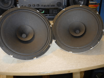

I do not know the model RCA console these came from...
Your 12" RCA drivers are full range (with whizzer cone). Below is what yours may once have looked like:

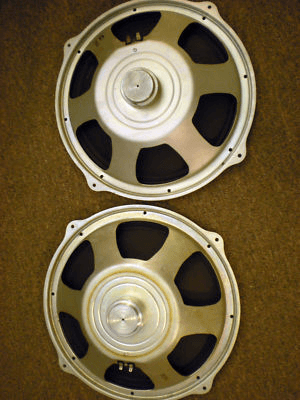

I'd be interested in seeing them from the magnet assembly side. I presume them to have Alnico magnets.
They have smaller round magnets similar to this one.
Like the Alnico magnets on these 15" RCA drivers?
