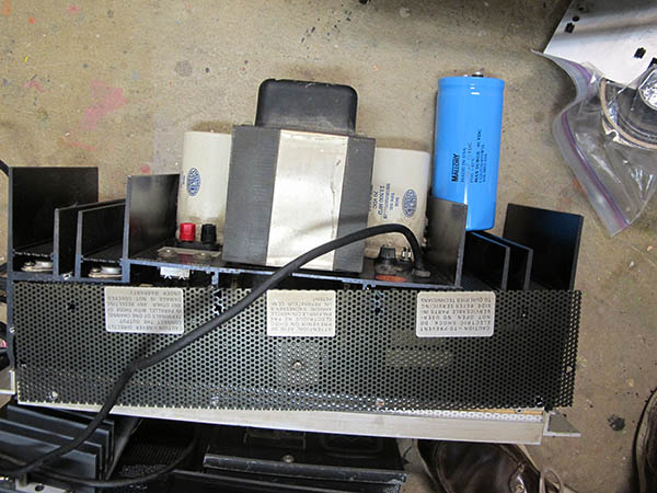

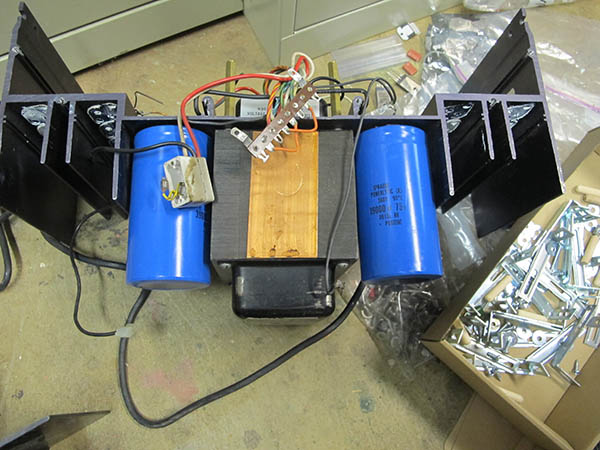

I am really itching to replace those big can caps, both because of the age and because of the dents. I need to get on the phone with Apex Jr and see if he has a pair on the shelf that look like likely candidates. Dunno that 47,000uf like that one guy used is necessary, but i will probably go up from the original 15,200uf.
I have the DC300A manual infront of me -- the caps on this version were 13,000uF/70V
I have some Mallory CGS253U075L 25,000u/75V PM if interested.
I don't recall exactly what the printing on the caps is, but there was a non-zero number in the hundreds place when i inspected them. *shrug*
If the rails are 60VDC, then 75V capacitors are enough. That's a 25% safety margin.
Make sure the replacements will fit mechanically.
I meant the capacitance rating. 13,500uf I think. And rated for 70 volts. So yeah 75 volt caps will be fine. And yeah, it's a narrow area.
You also have to consider the way the capacitors are mounted, using the screw terminals with nylon bushings and shoulder washers thru the chassis without any clamps. Also interesting is that early models had the capacitors on the bottom and the later models were on top, Crown basically just flipped over the chassis/heatsinks. Every time I see a DC300 posting I dream of getting mine back together, sooooo much crap so little time.

The originals on one of my DC300A's were Sangamo's, here's some pix of one (a work in process) with Mallory's fitted:
Yup, I have those white ones, with dents.
Mine are white Sangamos with dents also. Even my xfmr end bell is caved in. I tried to get a new end bell from my friend at Mercury Magnetics but it seems to be an odd size. Are all of these bottom mounted capacitors? Maybe that's why Crown swapped the chassis around on later versions.
Craig
Craig
Craig
Thankfully the bell end on my transformer is in good shape, just the sticker is a bit damaged.
You might try to reform it - I'd try using a 2x4 (maybe trimmed down?) as an anvil, and a short-handled sledge or dead blow hammer.
