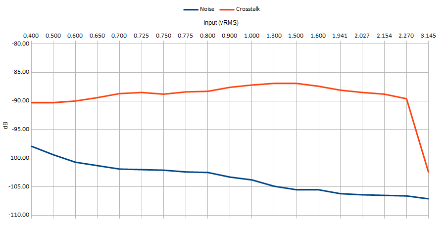

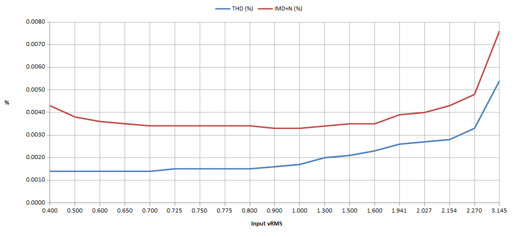

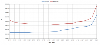

Further to my post #76 on the previous page, I have now graphed the information I plotted.
It can clearly be seen how the input voltage on the 2i2 affects THD and noise performance.
This is with a single ended input only.
Nice! Much easier looking at the graph! Older versions of excell used to be pretty easy to get good graphs. Ever since 2010 version I really struggle!
Tony.
Tony.
Thanks Tony - I ended up doing the graphs in LibreOffice, as I just couldn't seem to get them looking how I wanted them to in MS Office (2007)

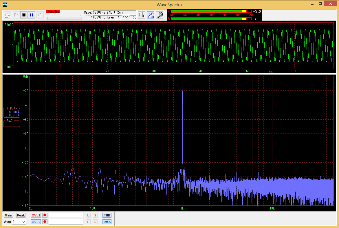

I have been using a DAC as my audio source (instead of the FocusRite output) for my test signal(s) as I find both the noise and THD is lower than that of the FocusRite output stage - it's definitely optimised for recording.

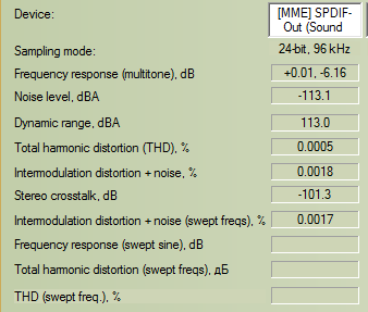

Finally, I recently purchased an Asus Xonar D1 sound card, and it beats the FocusRite hands down for s/n ratio and THD - but the bandwidth above 48kHz sampling rates sucks.
I've added test results for the Asus sound card - easy to see how they beat the FocusRite....

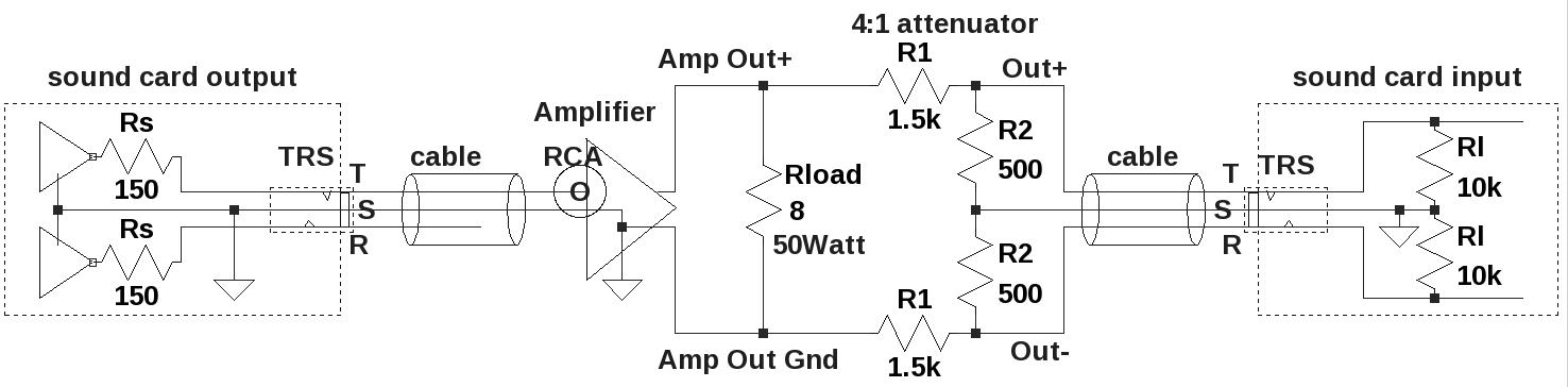

I found this when searching:
https://www.diyaudio.com/forums/att...er-distortion-measurement-unbal-interface-jpg
Here: Balanced Soundcard Interface for Power Amplifier Distortion Measurement
However in my previous setup with unbalanced, I never connected ground to the amp output, only input, since I found both grounds connected created a ground loop and picked up more hum etc. I guess hum would be picked up in this circuit too?
