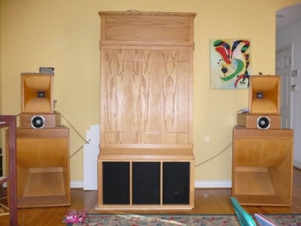

Edgar tractrix horns sound great - sure ALL horns have non flat gain profiles which we call coloration. Use a driver with a rising response or some EQ and it's all good again.
I've been in this hobby for some 25 years. Most of this time (audio-wise) I spent rubbing elbows with Dr. Bruce Edgar. And after having listened to many different designs I can say that when it comes to acoustical music and vocals (the type of music I listen to the most) nothing surpasses Tractrix in terms of fidelity and the least amount of coloration. What I also discovered - after direct comparison - was that square horn (side ratio 1:1.5) sounded superior to round horn of the same flare rate and driven by the same type of compression driver. I discussed this discovery with Bruce and he gave me a good engineering explanation which, unfortunately, went right above my head.
I think my horns are 1.5 ratio flat wall too. Did not know it mattered but thanks for confirming its a great ratio. I use cone drivers in mine like Dr Edgar but take them up to 20k with no comp driver. More here
http://www.diyaudio.com/forums/full...ing-trynergy-full-range-tractrix-synergy.html
![520377d1450679626-presenting-trynergy-full-range-tractrix-synergy-utrynergy-sb65wbac25-photo2.png](https://www.diyaudio.com/forums/attachments/full-range/520377d1450679626-presenting-trynergy-full-range-tractrix-synergy-utrynergy-sb65wbac25-photo2.png)
![520378d1450679626-presenting-trynergy-full-range-tractrix-synergy-utrynergy-sb65wbac25-photo3.png](https://www.diyaudio.com/forums/attachments/full-range/520378d1450679626-presenting-trynergy-full-range-tractrix-synergy-utrynergy-sb65wbac25-photo3.png)
![520380d1450679626-presenting-trynergy-full-range-tractrix-synergy-utrynergy-harsch-500hz-sb65wbac25-pcd-compare-meas.png](https://www.diyaudio.com/forums/attachments/full-range/520380d1450679626-presenting-trynergy-full-range-tractrix-synergy-utrynergy-harsch-500hz-sb65wbac25-pcd-compare-meas.png)
![520381d1450679626-presenting-trynergy-full-range-tractrix-synergy-utrynergy-harsch-500hz-sb65wbac25-pcd-phase.png](https://www.diyaudio.com/forums/attachments/full-range/520381d1450679626-presenting-trynergy-full-range-tractrix-synergy-utrynergy-harsch-500hz-sb65wbac25-pcd-phase.png)
