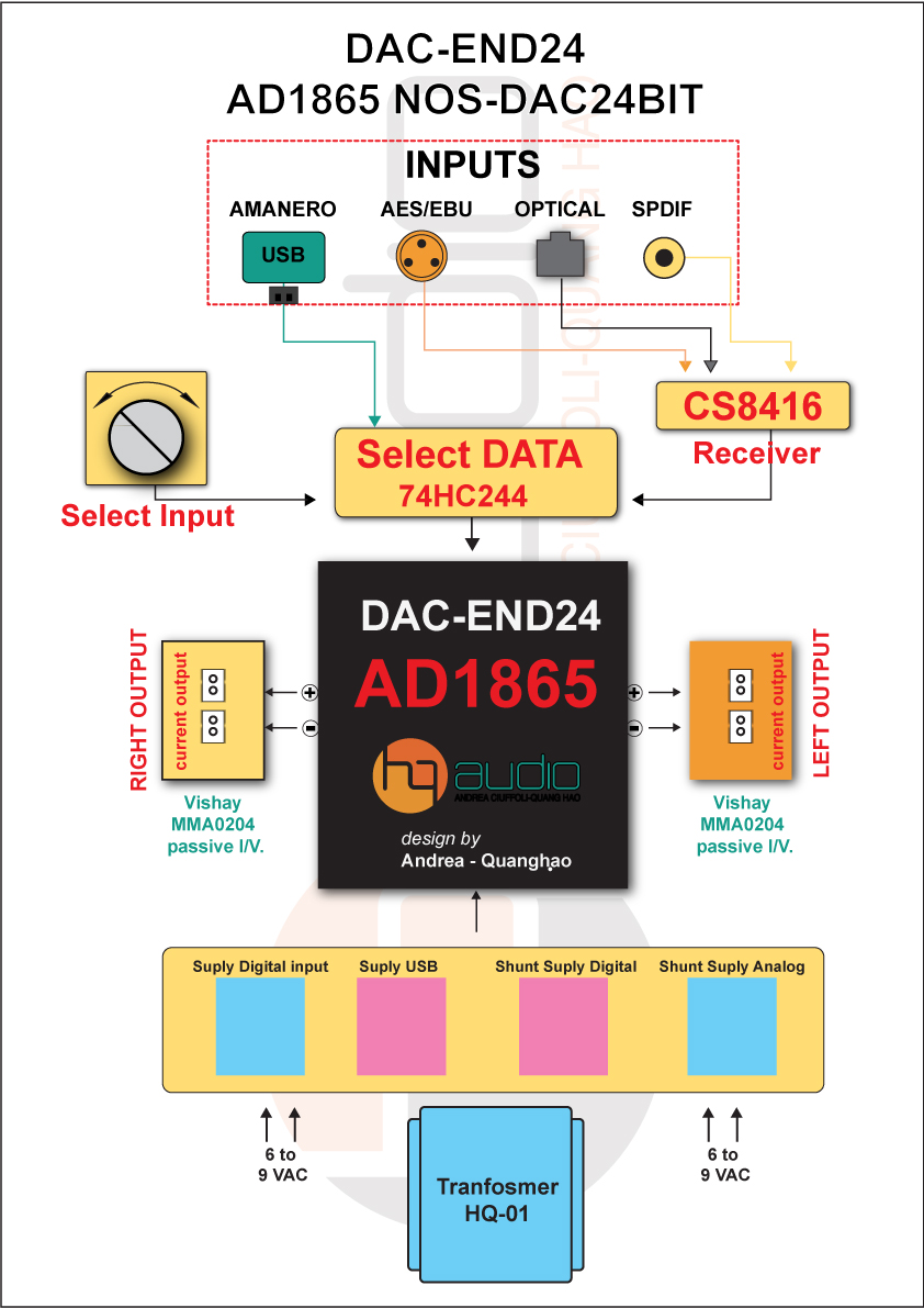

Description:
DAC AD1865 unit accept 192KHz input with operate NOS (non-oversampling) mode.
Structure:
Digital input:
1 x coaxial input,
1 x Optical
1 x AES/EBU- Balance in put
1 x USB Amanero
1 x selected in put
1x Cs8416
1x HQ-01 Transfomer supply: 0-6V*2
Analog output : R IV passive
Digital section :
using AD1865
digital receiver CS8416
Amanero USB
DAC module assembled and tested with all components

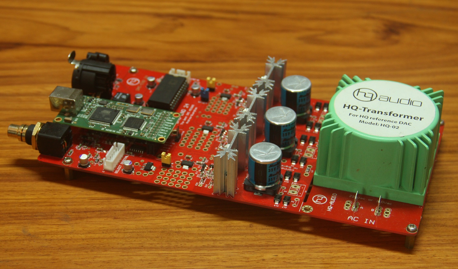

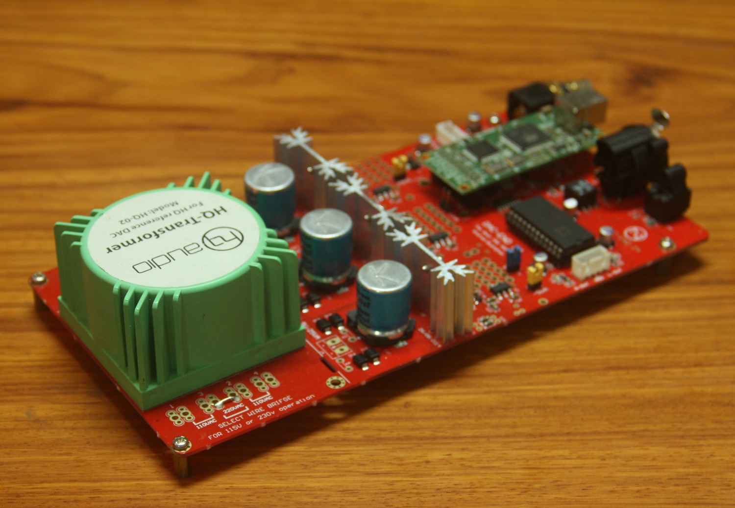

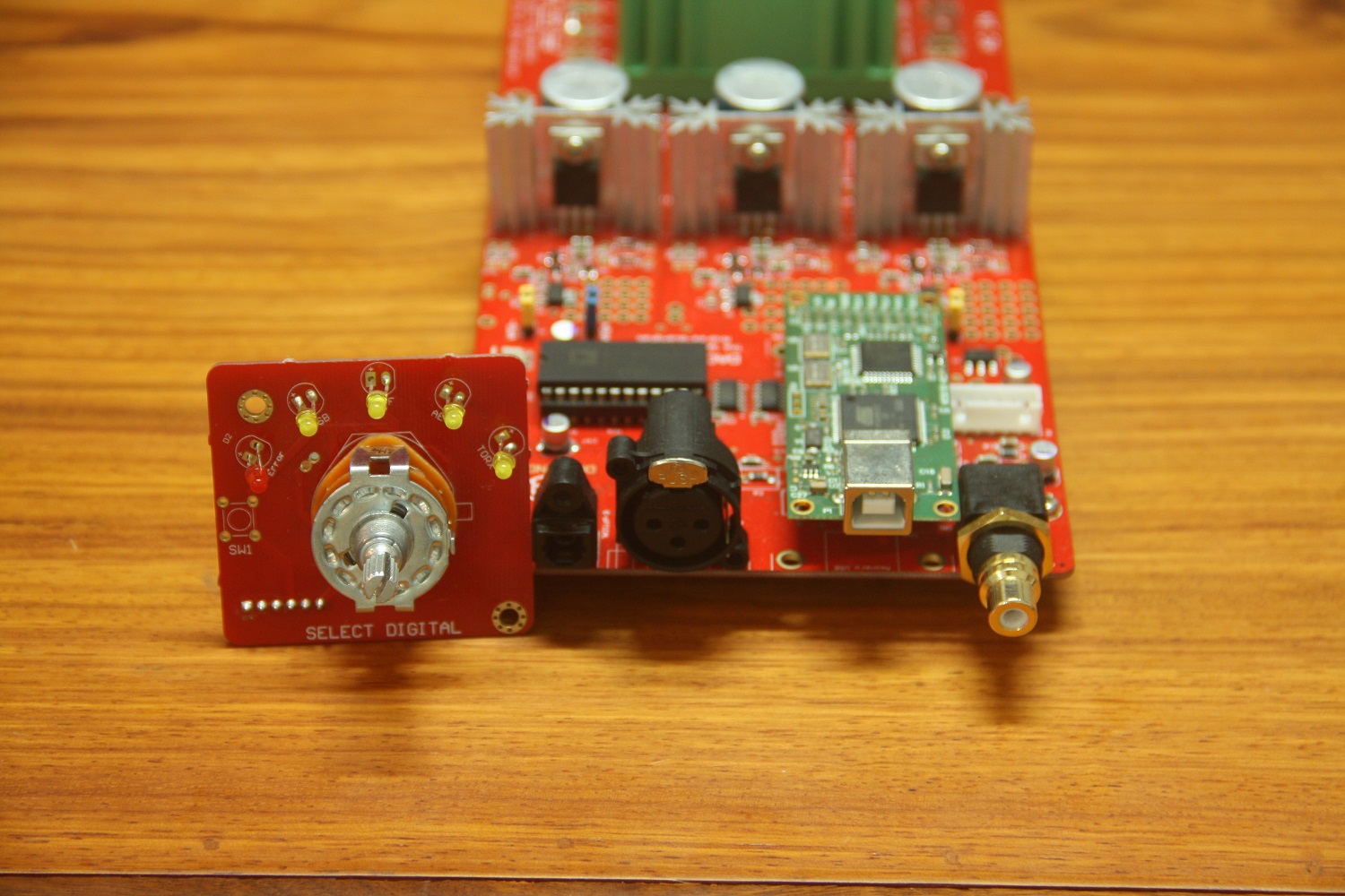

Now, I'm ready 15 DAC end kit as follows:
1. DAC-end kit 24 include:
Kit complete DAC, such as images include:
The connectors, chip CS8416, Transformers power, input switching, no chip AD1865. All are running well, and testing.
Price: $ 250
2. USB amanero: $ 60
3. Shipping worldwide with TNT: $ 50
You are interested, please sign up to your list to help me!
Thank you very much!

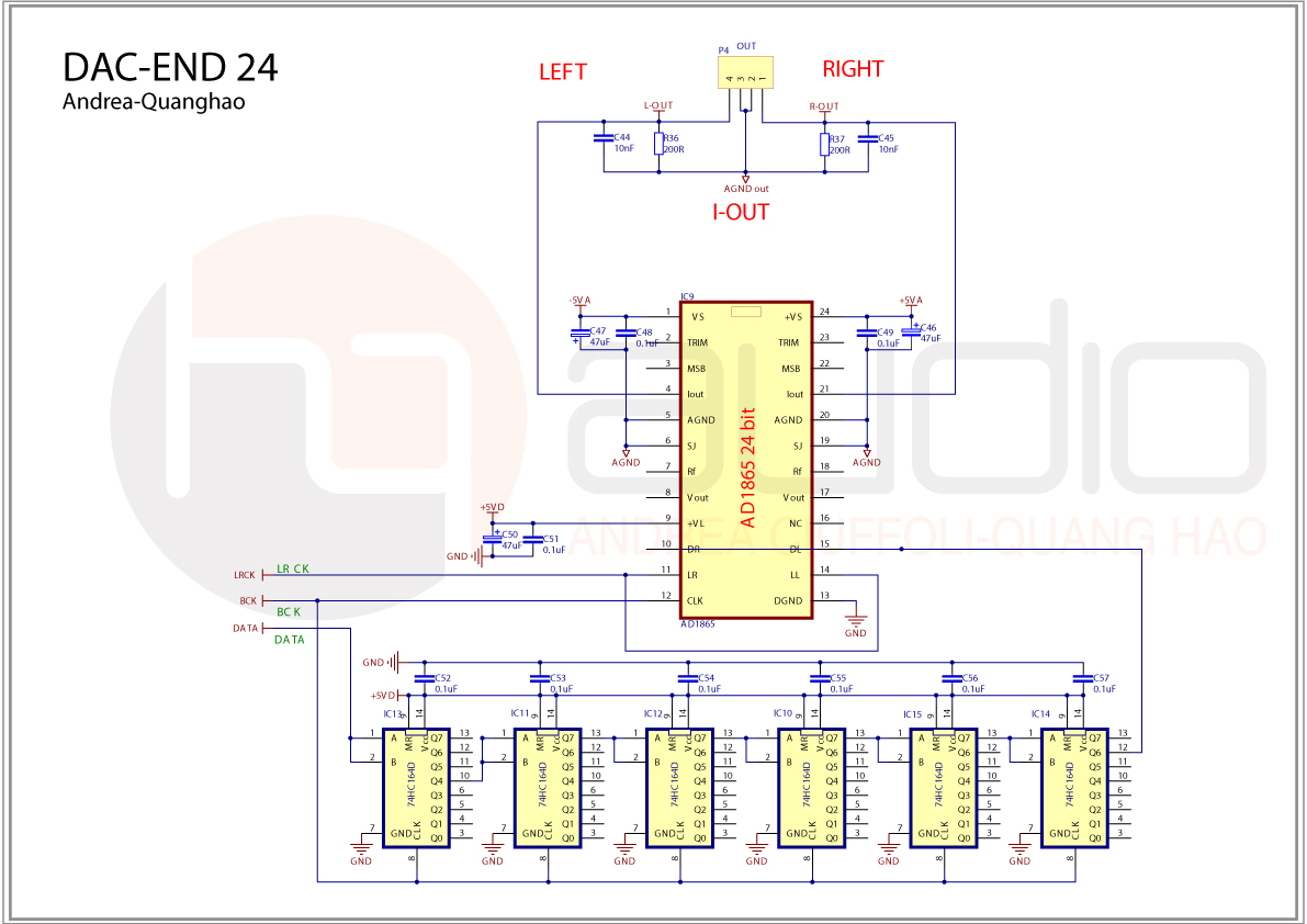

Isn't the AD1865 a 18 bit DAC ?. Calling this unit DAC-END 24 is a bit misleading. Sure, the CS8416 will decode 24 bit data but the AD1865 accepts only 18.
Therefore, the output of the CS8416 must be configurated to send only the 18 more significant bits to the AD1865.
24 bit compatible would be a better name for this kit.
NO!
i use some 74HC164 for bit to AD1865,
Here is the schematic to see, some value is incorrect!
Thank you!
