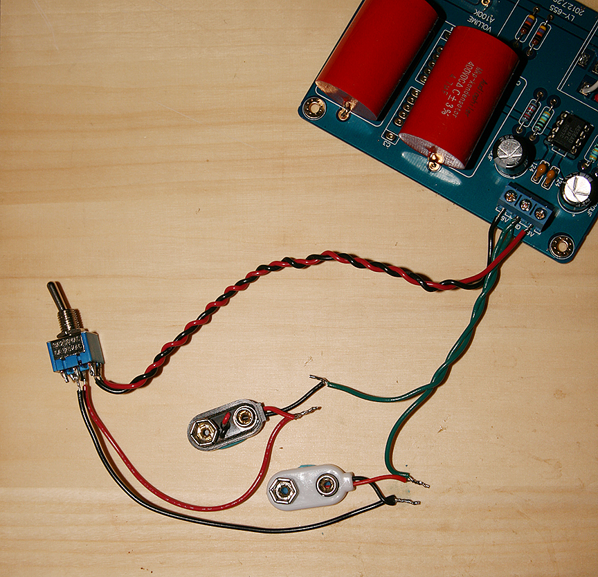

This is how I have it now but I don't think the switch connection is right.
I was guessing you may have wired it up that way, with one (or two) batteries into the PCB +/- terminals and no center ground connection. 🙂
availlyrics' diagram will fix up your circuit. Another is below. You don't use 2 of the 6 terminals on the switch. Their connection diagram on the website is also not clear that the center connection between those two batteries (ground) connects to that common connection of the B, C and "2" parts. There should be a hole on the PCB marked "ground" or with a ground symbol that connects to that point.

I think I have it wired correctly but can't get the switch to work properly. With the 2 wires from the board on one side of the switch it will not turn on. If wired to the other side it will not turn off 😕
Any suggestions?
Any suggestions?
I just buzzed my switch out with a DMM for sanity sake and that should work, sounds to me like the switch is faulty and stuck in one position.

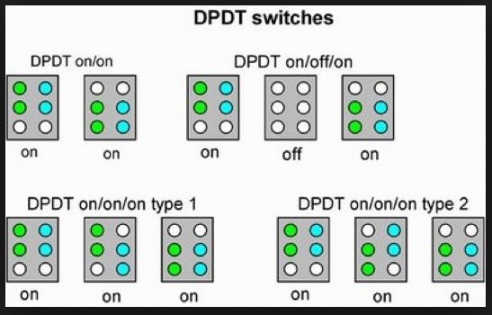

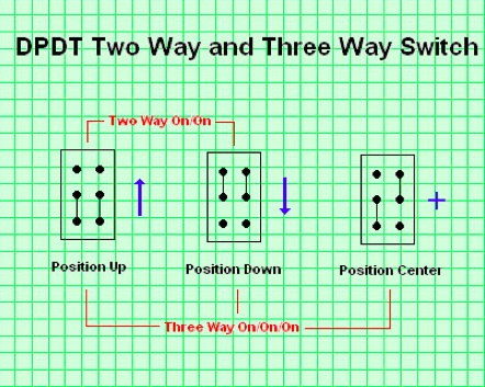

I have been looking at switches and all I can find for the two pole double throw switches are on-on or on-off-on or on-on-on which means that either on side is on at a time or both at once without an off possition. What kind of switch allows you to turn on/off both sides at the same time or is it a different wiring that is required?

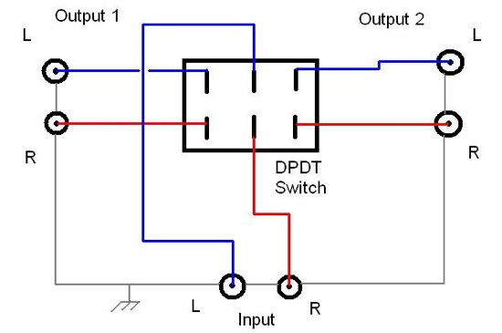

Here are some sample layouts that I found. Have to admit it's rather confusing 😕
The original switch is a two pole on-on type, power in the center pins, depending on the switch position the output is directed to the top or bottom row of pins, if you only connect one row of pins it functions as an on/off switch.
Its a toggle switch basically, then the on-off-on and on-on-on switches have a middle position where they dont direct power to either sets of pins.
Thanks mcandmar- Doesn't this amp require a switch that turns on both top and bottom row of pins to turn on both batteries at the same time and then turn them both of at the same time?
The (DPDT on/on) switch on the top left of this image is what you want, imagine the middle two pins are connected to the battery + and -, then the top row are connected to the + and - inputs on the board. Each column Green and Cyan are separate poles so its basically two switches in one, when you flick the switch both the + and - are being switched at the same time.
