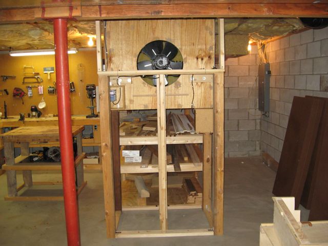

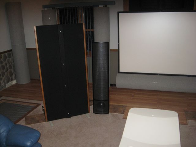

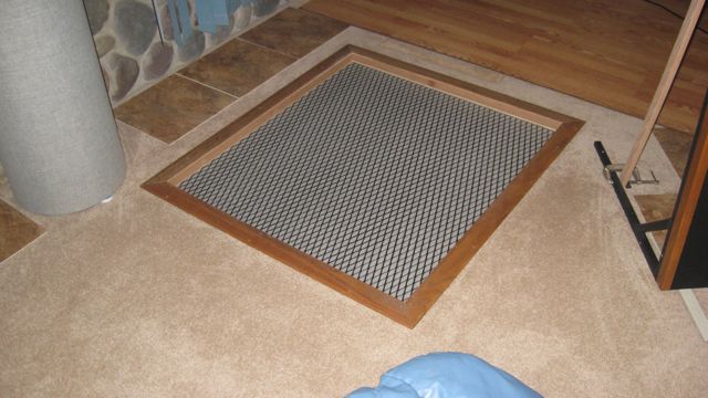

A very interesting post. I have been listening to
very low bass for years with a rotary subwoofer.
Will reproduce bass to below 1 hz and has no
trouble of being overdriven. Transients are frightening and distortion is very low. Many
Blueray movies have content to below 10 hz and
some much lower. Can be adjusted for different
size rooms and is very efficient (matches the impedance of the air). The entire bass range should
be in proportion to this infrasound for realism.
