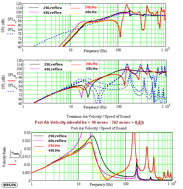

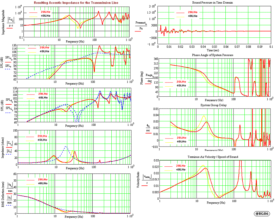

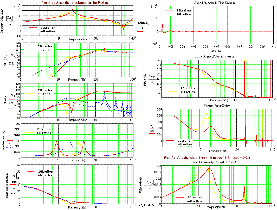

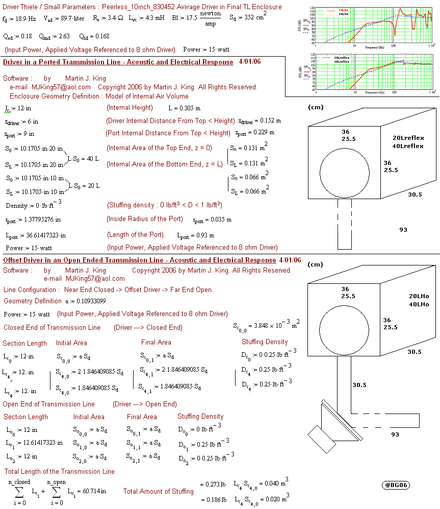

I don't think that software is capable of accurately modelling the Holliman box response. Still not accounting for the effect of the unique loading method.
Hi just a guy,
The plots I shown above are very accurate to what I could hear and also measure when testing and why not involve MJK and discuss the validity of his software for this case, as the infra source is important in the first hand and not the eventually ‘room aspects’ that easily can be handled separated, as usual with speakers?
Quote at text from: ’ MY PERSONAL THOUGHTS ON HOW AND WHY THE HOLLIMAN DESIGN WORKS.doc’
“It is described as incredibly clean, low distortion, very powerful, surprisingly efficient bass that increases in volume as it decreases in frequency.”
The expected result of the so-called unique loading method didn’t show up when I tested, no broadening to lower frequencies but rather some sort of simple band pass action instead, an efficiency loss, with dampening of higher frequencies as a result of my Holliman speaker setup.
I spent this weekend a lot of hours testing this Holliman phenomenon with a real setup (40L box and Peerless XLS 10”) and came to the conclusion that the high efficiency 5 to 25 Hz bandwidth probably is only a myth for this type of infra speaker.
Where is the optimal volume velocity to sound pressure transformer and where is the pronounced effect of the unique method?
Is there an infra seesaw kind of energy action between the speaker volume and the connecting room that obey other laws not yet described in physics or is understood with the good acoustic modeling software I used? I doubt.
I tested with the door hermetically closed (concrete high Q walls in a 6m x 4,5m x 2.4m room) and found no more infra SPL than what also can be expected with a sub with good excursion capability (fs lower than 20 Hz) placed at 2 to 3 m close to a room corner.
Velocity coupled, ok but only benefit for suppression of frequencies higher than the lowest resonance.
The volume velocity plummets rapidly down under 10 Hz as expected, below the lowest resonance and so did the SPL.
This indicates constant low acoustic impedance and when meet with the free air impedance is equivalent to a very low efficiency at the terminus.
There was no ‘bandwidth broadening’ action at all except for a certain flattening of the higher in band frequencies.
Despite I was from the beginning very suspicious and already knew the outcome; I also tested with different port lengths at the terminus side to see if any magical action could take place.
A lot of port noise at higher levels and other artifacts could easily be heard, like high gain modal standing waves caused by driver distortion overtones and maybe because my sub amplifier only has LP LR 12-dB/octave attenuation at 40 Hz.
This was not enough and probably 24-dB/octave could have worked better. I will later test with my DEQ 2496 hooked up, if I have some time left over.
