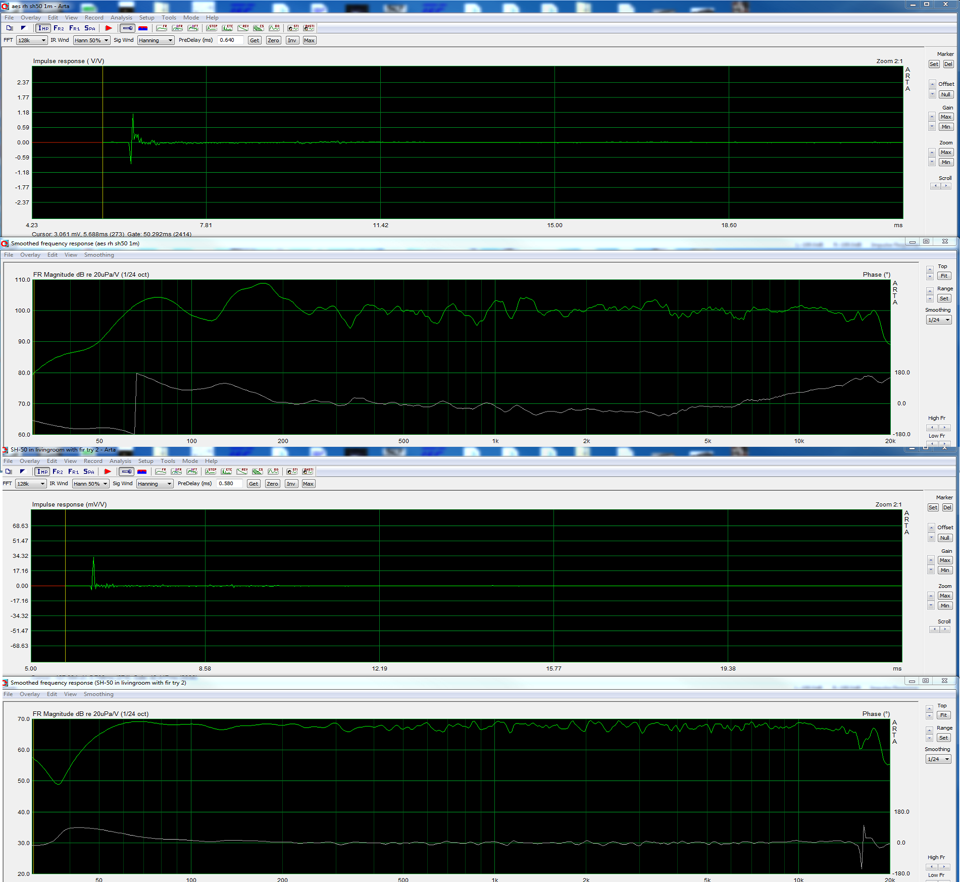

Here are two sets of measurements of one of my RH sh-50 using arta. The first one is “as is” taken at about a meter in my cluttered living room. The especially astute impulse response readers might recognize the reflection of a Ducati close by.
It is not flat as hifi speakers but unlike a flat hifi speaker made with domes and cones, because of he directivity, the measurement at the couch looks very similar. Also, there is no evidence of the phase shift and “all pass” phase shift from high order passive crossovers used in this 3 way system, the point is all the drivers combine into one source in time and space, there are no lobes and nulls in the polar patterns and if you move your head around approaching the mouth you cannot hear there is more than one source floating somewhere in front of you.
Now, cost is an issue, it usually takes three parts for every bump you want to address and when you make a crossover for a speaker that handles that much power, it costs real money. It takes a 780 Watt amplifier with slowly increasing music spectrum pink noise to reach the point where the response shape changes in just one place by 3dB compared to 1W. In other words, they are silly powerful for home use but headroom is your friend . That perception is A real problem in our market where most of the speaker systems are self interfering arrays that maximize the number of drivers, not minimize, here what one see’s doesn’t suggest how powerful it is.
I think these may work as a home product eventually but since the grass is green elsewhere I have not raised much interest at the shop in the home area. There is a recording studio that has taken an interest in trying some tweaked sm-60’s as an in wall main monitor in a new studio so if they like them they will talk about them, well I guess they talk either way.
One thing you can do with these that’s kind’a cool is you can go ahead and do an FIR correction and get rid of the drivers phase and other issues globally. While this is pointless for 95% of the uses at work, this actually makes the speakers I have “invisible” to the ear when producing a mono phantom.
I had saved a shot fooling around with re-phase and opendrc, this was try number two months apart from the raw measurement and a different mic pre setting..

Tom, Thank you for the insight. We have been playing around with FIR Correction and BruteFIR and Audiovolver some time ago, too. Very interesting stuff and in my oppinion one of the "great things to come" in the future.... Even great speakers took a major leap forward in "disappearing and making the box invisible" with the right correction used... Sadly the needed delay for lower frequencies limits the technique für higher bands when used in live-setups.
Your Step-Response looks just great!

Hi guys,
I am not too worried about these initial measurements.
The major dip at ~9-10k is my non-existent handling of the throat of the compression driver entering the horn. I had originally designed this 'insert' as a solution but have not had anything like it made:
I do agree you get some funny peaks/troughs and some of this is due to the poor measurement by me (I don't have ready access to an anechoic chamber). My bass measurement is pathetic as you can see (for example).
I have done some brute-force correction via the DEQX (which has the handy feature of allowing you to disable the drivers at runtime) and there is definitely no audible distinction in the source of the sound down to 300Hz (where it crosses to the bass drivers) - even as Tom has said - with your head in the horn.
So far I have found that a 300Hz - 128dB/oct and 950Hz - 128db/oct is sounding best but this is playing mono until I can carry the other one to be in place. I have also removed most of the measurement smoothing allowing the DEQX to aim for a flat output. My next step is to try some off axis measurements and see how they look - an initial one looked very similar to my on-axis ones.
Ultimately my goal was to produce an extremely dynamic speaker and I think this will fit the bill.

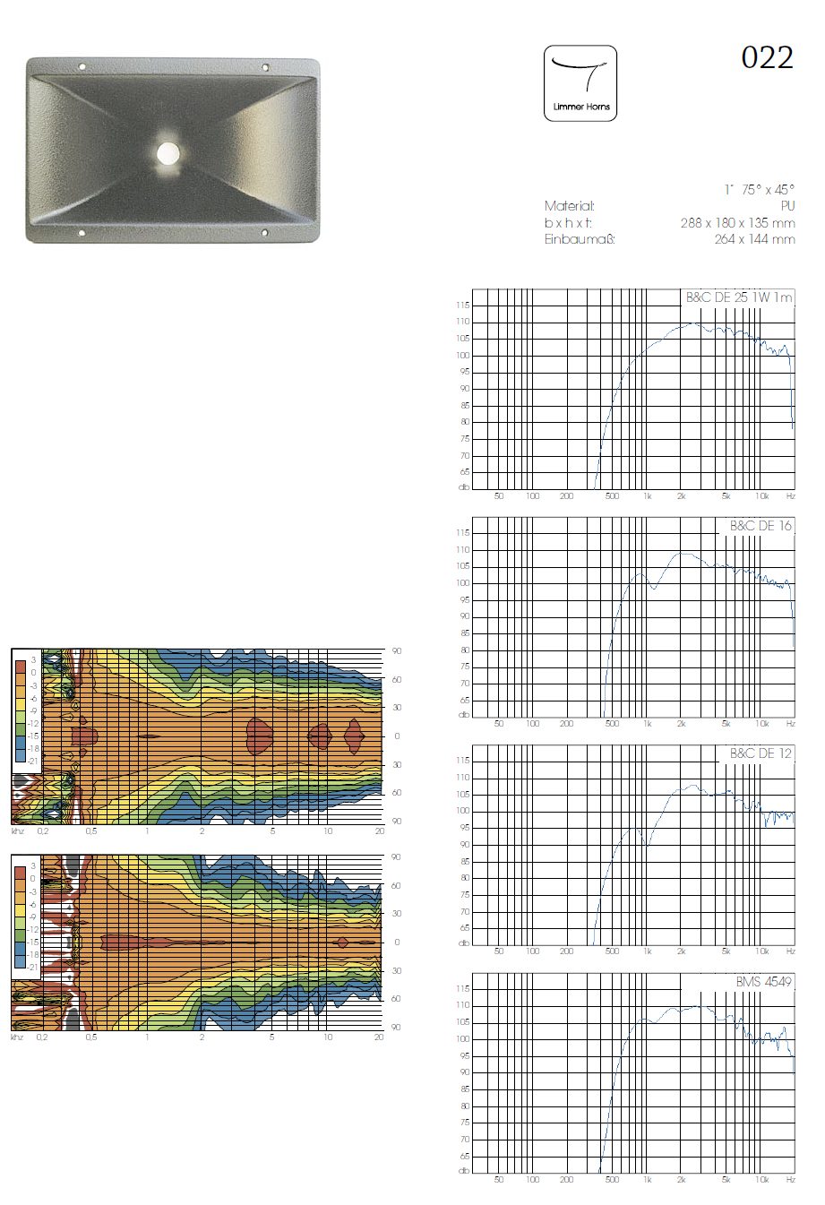

Limmer 022
Price: 75 €
Where to buy: some shops in europe
Limmer Horns is a small german company with high reputation. They have no website. The catalog can be requested by phone. Here is an overview of their horns with datasheets.
Price: 75 €
