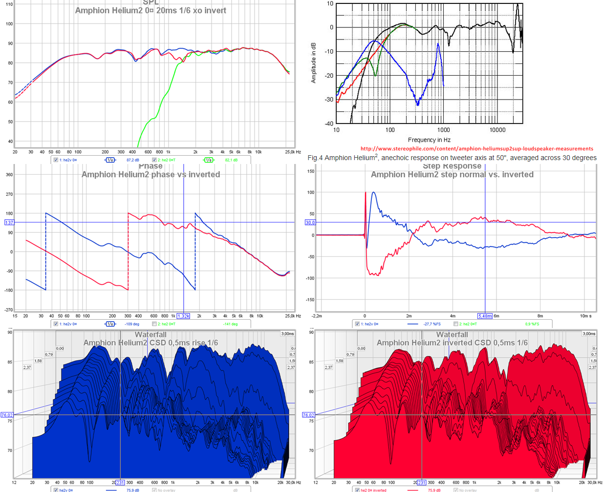

I have measured the Helium with W inverted. Xo is actually closer to 2,5 than 2.2. The form of dip matches LR2. I have accidentally deleted the .mdat.
Amphion Helium2 was a really magnificient speaker. Now 510 is in production.
Is that electrical or acoustic? MFG specs 1.5kHz, several reviews claimed the same. Looks like some sats I built some 30 years ago 🙂

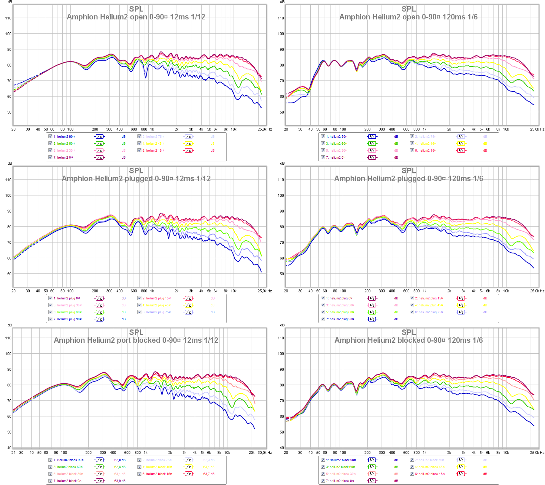

A flashback to Amphion Helium2 - Greebster was right! It has LR4 at 1,5kHz.
My speaker came with wrong polarity, just like the one measured by Stereophile! I don't know if it was some batch or all of them, I couldn't find anything about it at Finnish forums. The red wire was attached to woofer's plus. I inverted it and took new measurements.
Another peculiar feature of it is the rear port's noise at 800Hz. The supplied plug reduces it 10dB and blocks reflex. The port makes the hickup at 800Hz seen in my measurements! hickup at 150Hz is the ceiling and at 400Hz the floor.

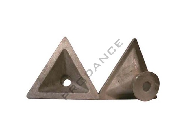

Megaton, Czech production, comprises horns and waveguides, made of aluminium and they publish their own measures
eShop | prodance.cz
They have some interesting shaped horns
attachment.php
Looking at the finish they appear to be molded in the Isengard 😀
attachment.php
Nevertheless I like them. Remains me from the old days when 'high tech' was measured in kilograms 😀

Only thing with Prodance is that ordering can be difficult due to linguistic problem. A friend of mine who has regular dealings in CZ will bring me back some C9090. The prices are more than OK too and BTW, they also have some JBL "inspired" horns...
Yes, they do look a bit rough but as long as the thread hole is OK...Anyway, I've seen articles about comparions made in the 1980s/1990s, between rough surfaces and smooth surfaces inside horns. The former was said to be advantageous in many cases. One can still polish the bits one dislikes, I guess.
