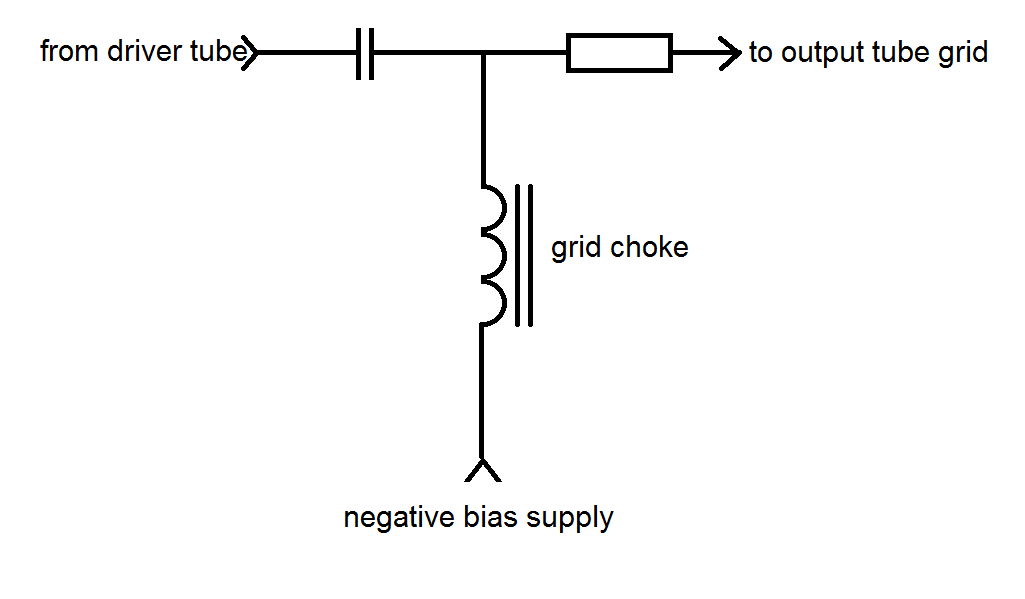

I installed the grid chokes and connected them between the coupling cap and the grid stopper. The grid stopper and the tube and choke created a voltage divider which sapped most of the bias voltage. I can either add resistance between the choke and ground or connect the choke directly to the grid pin on the tube socket. Which is better?

I know this may sound obvious, but from looking at the schematic...
Do you have the grid chokes connected from output tubes grids to *ground* or from output tube grids to the negative bias supply?
They don't go between the coupling cap and the grid stopper. They replace the bias resistor and attach at the junction of the coupling cap and grid stopper.
They are in place of the grid resistor, one end between the coupling cap and the grid stopper the other end to PSU ground.

Is your output stage using fixed bias, or cathode bias?
I thought you'd posted that it's using fixed bias. If that's the case, then the grid chokes need to be connected to the negative bias supply instead of ground. Excuse me if I misread that. It's difficult to keep all the facts straight by looking through a long thread.
Yes its fixed bias. They should be connected to the ground, (positive) side of the bias power supply?
It should go to the output of the bias adjustment pot (assuming that you have one like nearly all amps).

Sorry to be a pain, but I don't see a ground path there? Also in AJT's example the bias pots are meant to balance the bias voltage between the two tubes. Would I have to adopt this bias scheme to make it work?

Path to ground is through the -ve bias supply. Check some fixed bias schematics to familiarise yourself. In your situation all you want to do is replace the grid to -ve bias resistor with the gridchoke. The rest of the bias supply remains.

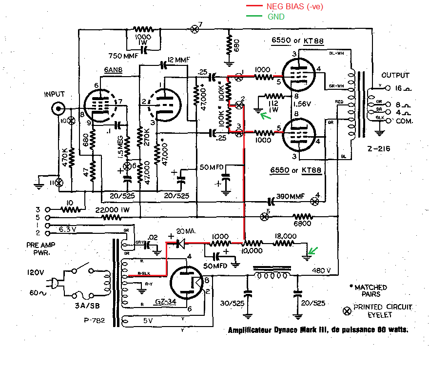

The output tube's plate voltage is positive, its grid voltage in fixed bias is negative, and its cathode is at ground potential (0V).
The path to signal ground is through the cathode of the output tube.
The negative bias supply's path to DC ground is through the voltage divider that adjusts the bias voltage. (The negative supply's reservoir and smoothing capacitors also go to ground, of course.)
Take a look at the negative bias supply for the output 6550 tubes in a Dynaco Mark III amp.
In this circuit, all you'd be doing is replacing the two grid leak resistors marked 100K* with chokes. You should be able to translate this information to the circuit you're working on.
That's optional.
