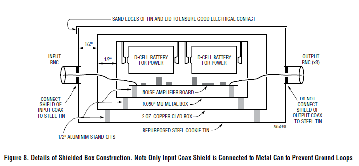

What about one more hole to use a metal standoff to ground to a metal plate/can?
Duke
From Linear Tech ApNote 159:

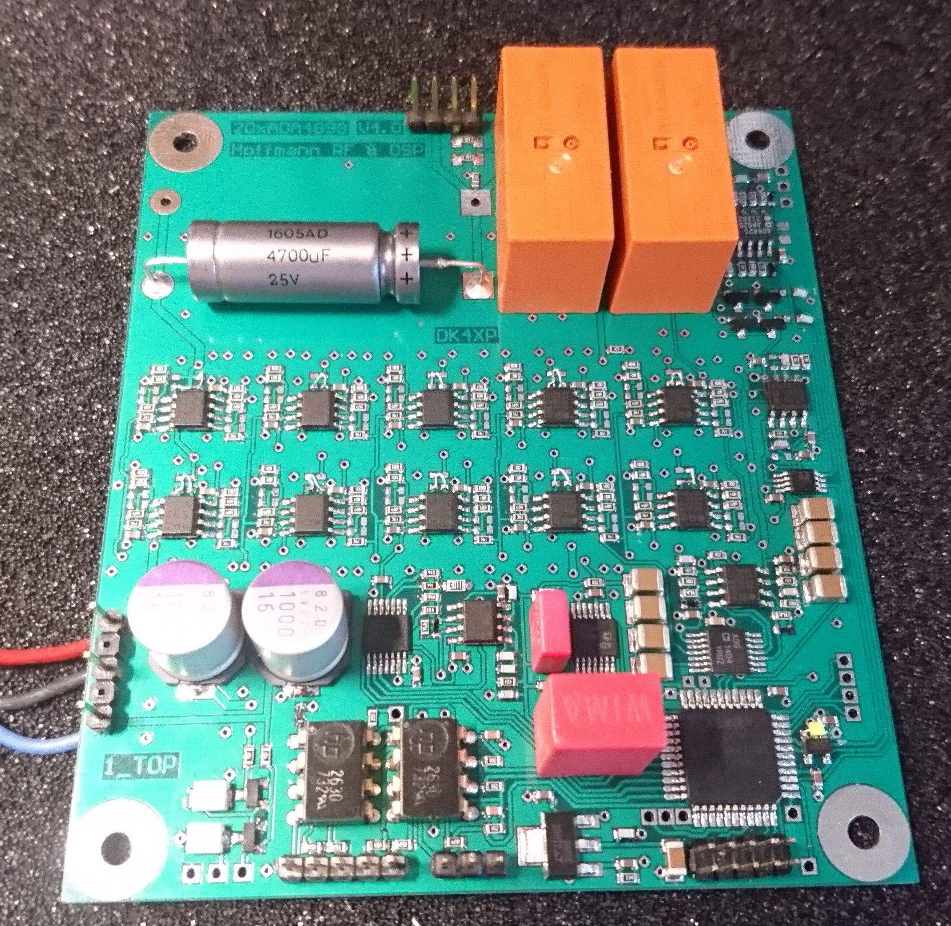

I had some boards recently made at PCBway. That worked out quite nicely. Only problem was German customs in Leipzig who would not believe that the production of 10 boards costs $5 + transport. They gave in when I sent them the URL of PCBway orderering and proposed that for $5 + transport they could have their own shiny circuit boards. It seems they had no interest, but it did the trick.
One of these was a respin of my 220 pV/rtHz preamp. It has now a 2nd input with a AD8620 for browsing with a scope probe; that gives away most of the noise advantage but is convenient and the low pass filter may help. Gain, low pass frequency corners, input selection and protection relays are now controlled with analog switches that are set up by a $2 CPLD that has a opto-coupled SPI-interface to the external world. It is also possible to use mechanical switches instead.
There will be a $5 board respin to remove a bug for the 80 dB gain selection and also an unexpected and intolerable noise increase from 220 pV/rt Hz to 400 pV/rt Hz above 500 KHz. I first had the idea that this was a peaking effect but it wasn't as shown by the network analyzer.
It was just the routing of the input. The 20 op amp inputs were fed by a single U-shaped route and that simply had a rising impedance above 500 KHz. A few Ohms count here. Soldering in half a dozen of wires to connect the left and the right vertical lines of the |_| removed that nearly completely.
Boards of this and the next iteration are/will be available. I don't need all 10 of them. They are based on 10 ADA4898 op amp pairs.( plus some as post amplifiers)

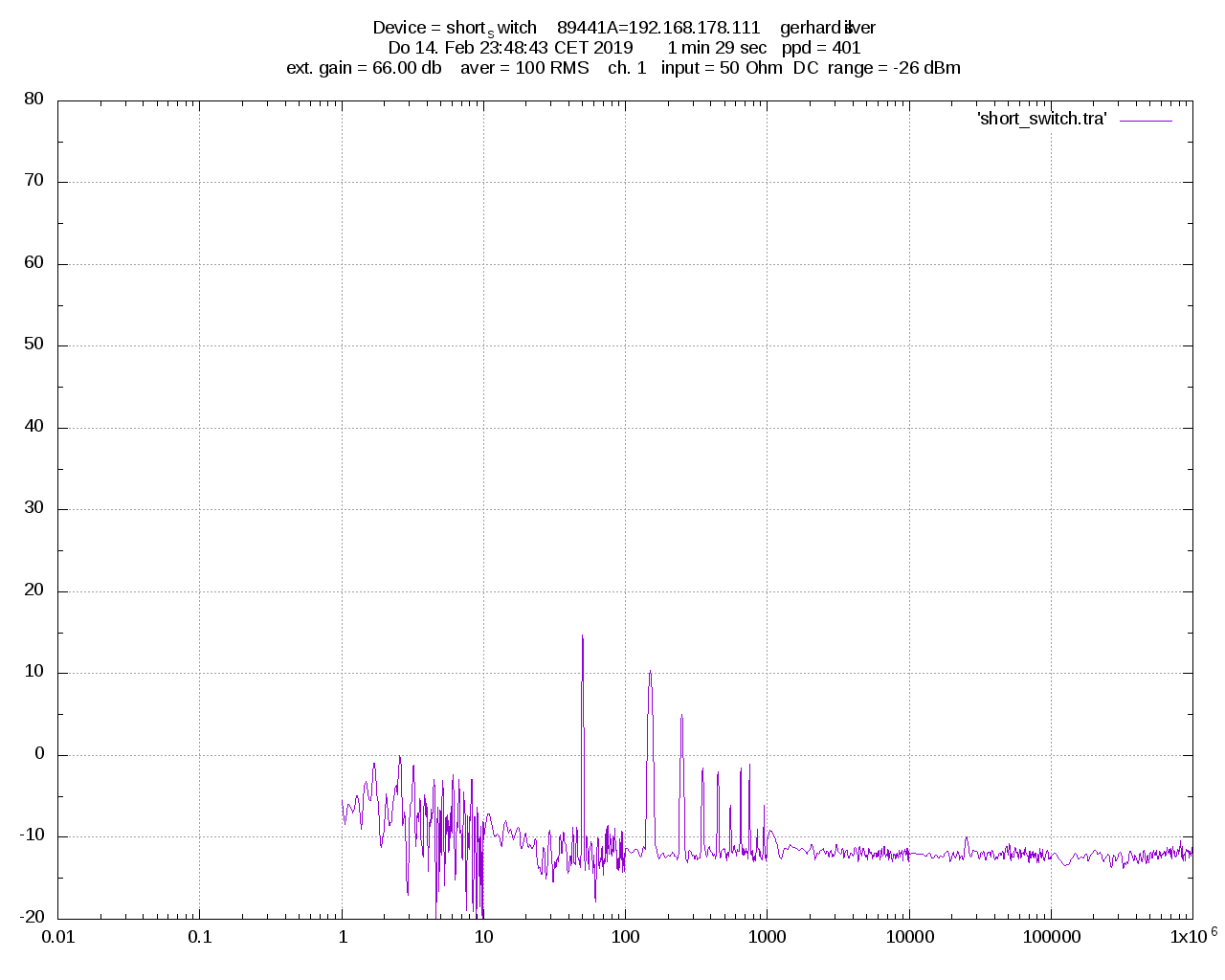

Pics: 1 nV/rt Hz is about at +2 dB (60 Ohm resistor), so the own noise is abt 14 dB below this.

I'd propose the old version with mechanical switches and foil capacitors in the input. The current version has the ado with the CPLD that must be programmed and is transitional with a newer version due in 4 weeks. The main problem with the old version are the many yet still not enough foil capacitors. The new version there has a wet slug tantalum 4700uF / 25V there. That is much better for noise below 50 Hz but comes with a shocking price tag. But, as a first impression, good quality Al electrolytics seem to work. Maybe I was too easily impressed by Jim Williams and the metrology crowd at EEVblog.
The write-up is in < http://www.hoffmann-hochfrequenz.de/downloads/lono.pdf >
Disregard the layout with the ceramic capacitors in the input, although that seems to work the board has never been fabricated. Some more material is in < http://www.hoffmann-hochfrequenz.de/downloads/lono_v2_dist.zip >

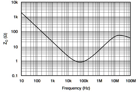

Proof of the fact that the op amp output impedance is negligible compared to a feedback resistor of 999ohm: the closed loop gain variation across the amp closed loop bandwidth (200KHz or more) is very small. The open loop output impedance usually varies significantly with frequency (see attachment), while the loop gain is constant in the closed loop bandwidth. The attached example is for OPA211.
BTW, it should once again mention that your 20 x ADA4898 LNA has an input current noise of 10pA/rtHz (typical, low and high limits are not provided in the data sheet), which makes it usable for a source impedance of lower than 6-7ohm (otherwise the input current noise multiplied by the source impedance can no longer be ignored compared to the input voltage noise). 6-7 ohm source impedance limitation is appropriate for measuring batteries or power supplies only.

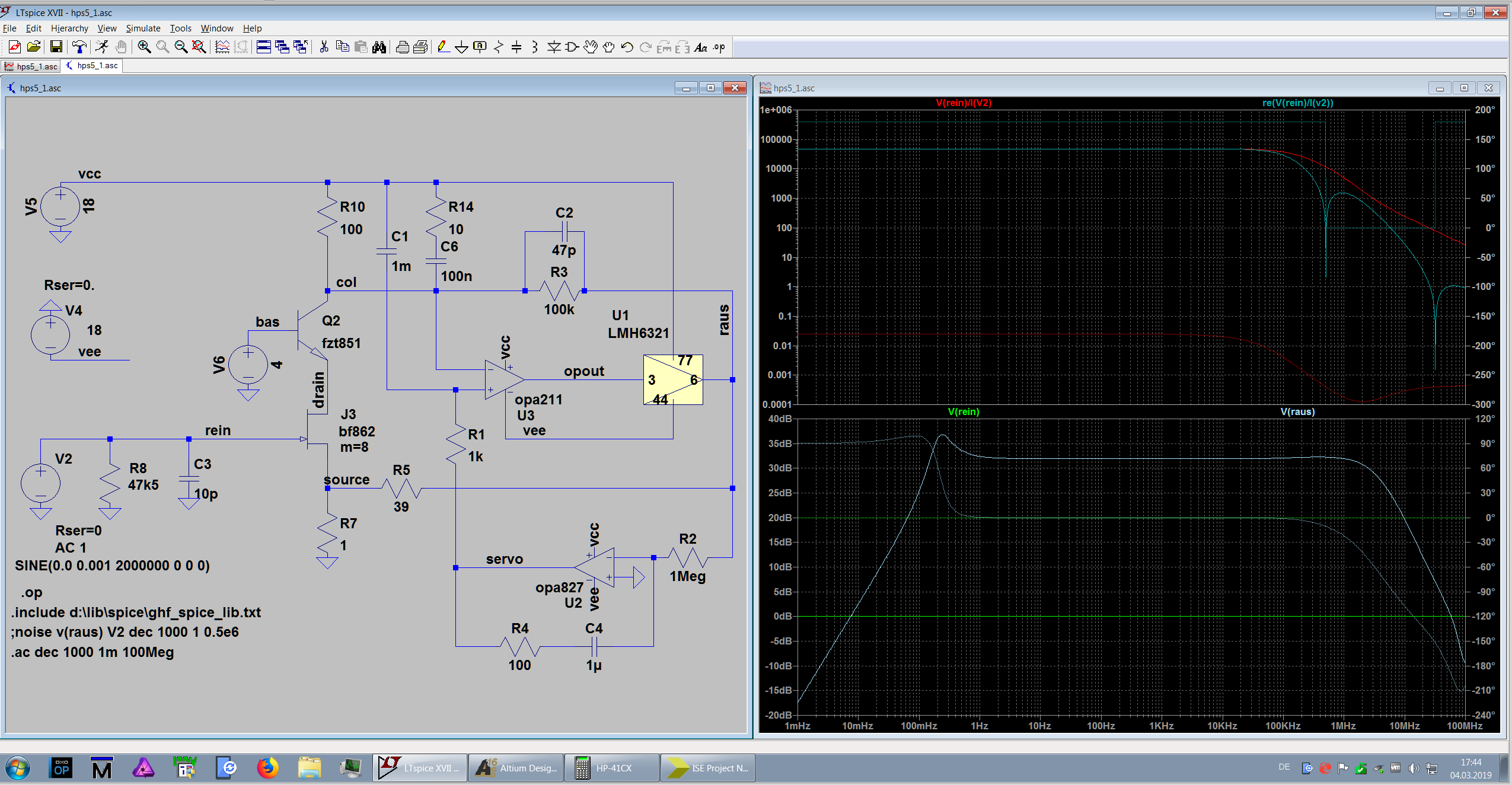

It's not that I hate JFETs. I just spent another rainy & stormy weekend simulating and
trying to stabilize my IF3602 amplifier. That standard architecture
"parallel FETs, optional. Cascode, op amp loop gain and feedback into the sources"
definitely has a stability problem.
I managed to stabilize the cascode itself, and even with acceptable open loop gain
the closed loop will produce neg. Rin. There are more than 2 loops.
I tried yesterday evening if other people fare better than me, and no, they don't.
SG's amplifier was too much drawing work with that over-engineered current source,
so I took something símpler, also well known here.
Lo & behold, negative input impedance @ > 500 KHz. Find a cable or inductor of the
right size and it will oscillate. Input impedance is signal generator voltage divided
by generator current, and re() is the real part of this.
And yes, I need a FET amplifier because cross correlation won't remove the noise
current effects since it's common to both parallel amplifiers if I use 2 amplifiers & cross correlation.

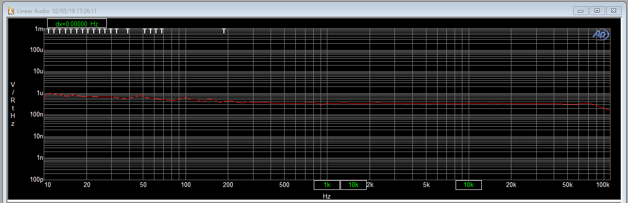

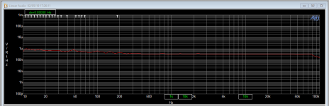

Ovidiu, I have Groner's preamp and I did measure 0.4nV/RtHz or slightly better over most of the audio range, with the AP. Shorted input.
Jan
0.4nV/rthz flat is a no debate, easy to get. SG claims under 1nV/rthz @10Hz, which obviously yours doesn’t (if you count the drop around 10Hz). Extrapolating the curve, it appears yours is 1.5nV/rthz @10Hz, which very respectable (better than what I got, 2nV/rthz), but 50% higher than the claimed result.
At the scale of your graph the noise corner frequency is hard to evaluate, but it certainly doesn’t look under 100Hz as originally claimed. It appears to be in the hundreds of Hz, which aligns very well with mine and others results.
P.S. Also check Dmitri’s results on the low noise JFET noise corner frequencies. No known, old or new, type has under 100Hz.
This is an example of my own (not really the best), -112dB that is 2.5nV/rtHz @10Hz, for 8xBF862. Sorry, it is not shielded.
If you look between 10Hz and 100Hz, you'll note the slope is some 13dB/decade, pretty close to the theoretical/ideal 1/f noise slope, of 10dB/decade (the balance of 3dB is usually some GR noise). And if you extrapolate at the 0.4nV/rtHz flat noise (-128dB, the lower right corner) you get a noise corner frequency anywhere between 200 and 250Hz.
I will redo this measurements as soon as I get the chance to do a decent shielding.
