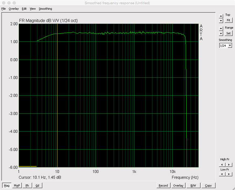

P.S. With a sound card it's virtually impossible to go much under 20Hz. As a rule, the LF gain drops significantly under 20Hz, after all these are "audio" devices, not instrumentation.
Hi gerhard

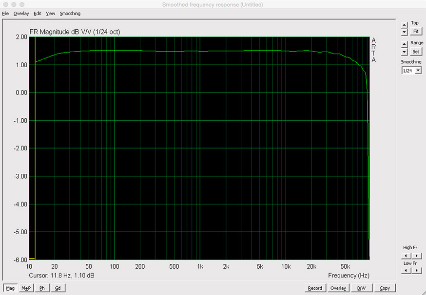

Thanks for your input. The frequency response of the Juli@ sound card falls off a cliff above 22kHz. When I try to expand the frequency range of the FFT I get the same.

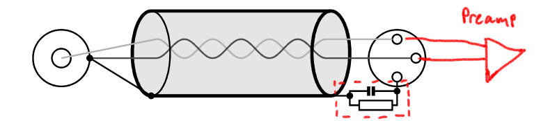

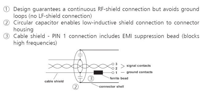

It is interesting to reflect on my "test lead" cable (the one that connects the pre-amp to the DUT) in light of section 4.5 of Bruno Putzey's Dealing with Legacy Pin 1 Problems article. The input to this pre-amp is single-ended and that section of the article deals with cabling single-ended sources to balanced inputs but bear with me for a bit.
For me the XLR jack on the pre-amp was one of convenience. With four conductor cable for my test lead I could connector one conductor pair to a red alligator clip and mark it "signal/hot". At the XLR end this pair connected to pin 2. The other conductor pair connect a black alligator clip marked "GND/cold" to pin 3. At the XLR/pre-amp end, the test lead shield is connected to pin 1 and pin 1 at the enclosure XLR jack is connected to the enclosure. At the alligator clip end the shield is unterminated. My idea here was that at least the shield formed some sort of Faraday cage over the conductors.
The XLR connector I am using is a Neutrik EMC series.
NC3MXX-EMC - Neutrik
It has a circular cap which connects the shield to the connector shell and a ferrite bead between the shield and pin 1.
I note that the first figure in sec 4.5 of the Putzey article has the shield connected to the GND reference conductor at the source end whereas mine is simply left unterminated. I wondered what the difference in noise measurement would be between using the test lead as I had set up versus connecting the shield at the DUT end to the clip probing the DUT's GND reference.

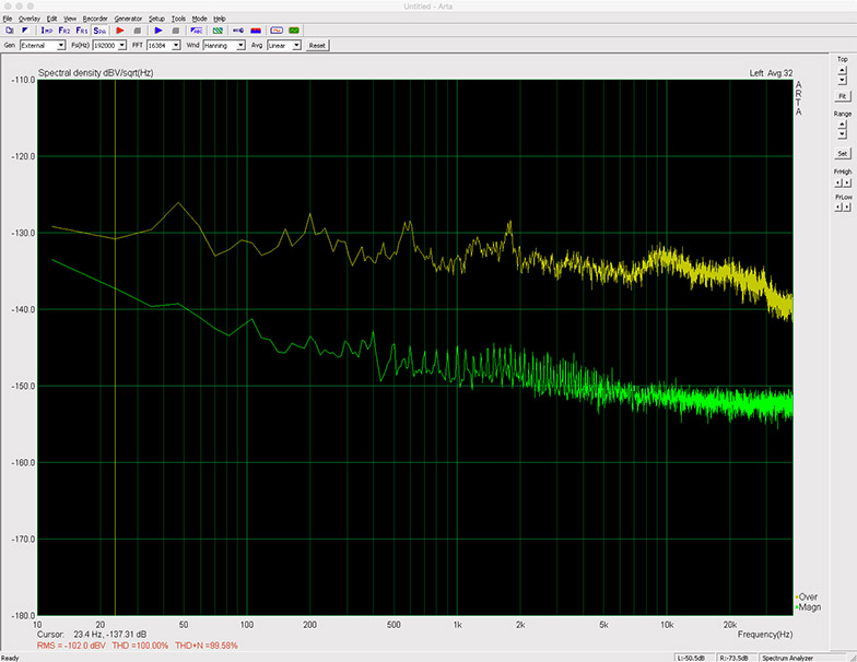

The measurement difference is very significant. See the attached pic which has two measurements of my balanced to single-ended input board. Yellow is my "DUT-end unterminated cable shield" version. Green is with the shield connected to the conductor pair probing the DUT ground reference - equivalent to the left side of Bruno's graphic. (The DUT ground plane is also connected to my bench power supply ground else the input board's ground is floating.)
What do you guys think is the more rigorous setup? Recall that my pre-amp board GND and battery supply have no direct connection to the pre-amp enclosure.
I guess I have effectively connected GND of the pre-amp to the pre-amp enclosure via the shield of the test lead (via a ferrite etc in the EMC XLR connector)...😕

Cable and right side first. This is how I have it wired. What about the RC network? The Neutrik EMC connector has a circular capacitor from screen to connector shell and a ferrite bead between screen and pin 1. When the XLR connector meets the XLR panel jack and pin 1 of the panel jack is wired to the enclosure we effectively get an RC network. (Not the same values perhaps but the same purpose.)
Now the left side. I had left the shield unterminated at the DUT end. When I connected it to the single-ended DUT ground the noise dropped markedly. I was surprised by this. Perhaps I should not have been. If I were testing it en situe within the power amp enclosure there'd be a connection between this DUT signal ground to "star ground" and a connection from star ground to the enclosure. Had I placed an XLR "test lead jack" on the enclosure to make a convenient external connection to the measurement amp it would have connected the shield to the enclosure (which would in turn be connected to signal ground via star ground). Without it I could clip the test lead cable shield to the enclosure or simply connect it to the probe clipped to signal ground - as shown in the left side of Bruno's image. When testing the board without an enclosure I can only connect it directly to signal ground on the board (separately or via the ground probe) or to my power supply ground (they're both connected).

When I connect the test lead cable shield to signal ground of the DUT I get a noise measurement that is 10-15dB better than if I don't. (Pic in post 129.) Can this in any way be false positive?

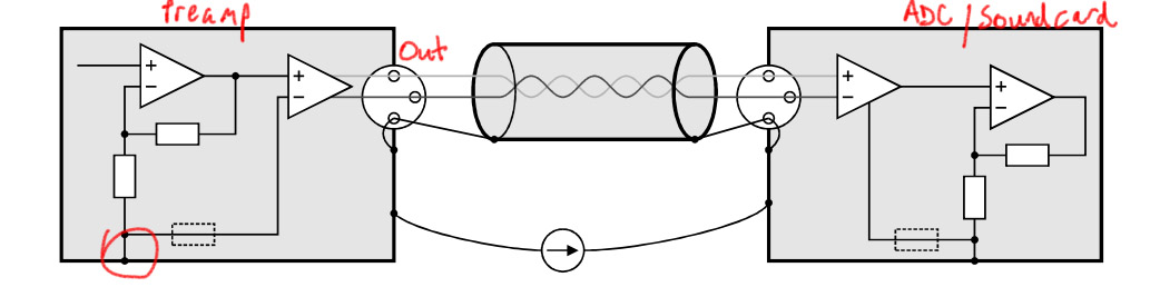

I'm not sure there is any compelling reason to ignore AES-48 with respect to the balanced connection from pre-amp output to sound card input. To my mind, the only real questions are (a) whether to connect the preamp board's GND to its enclosure or leave it floating (b) how to terminate the shield of DUT end of the input test lead when it has two conductors, one of which is used to probe DUT GND. Perhaps the two are not independent. Regarding (b) were the test lead a basic single-ended cable, i.e. single-conductor + shield, into a BNC connector it's simple. However, it would appear that better results can be obtained using two-conductor cable and another XLR jack rather than BNC.
If there is no chance of a "false positive", by which I mean a result that is better than reality because some real DUT noise is cancelled by the measurement setup, one can easily check the four possible combinations of (a) and (b) above...

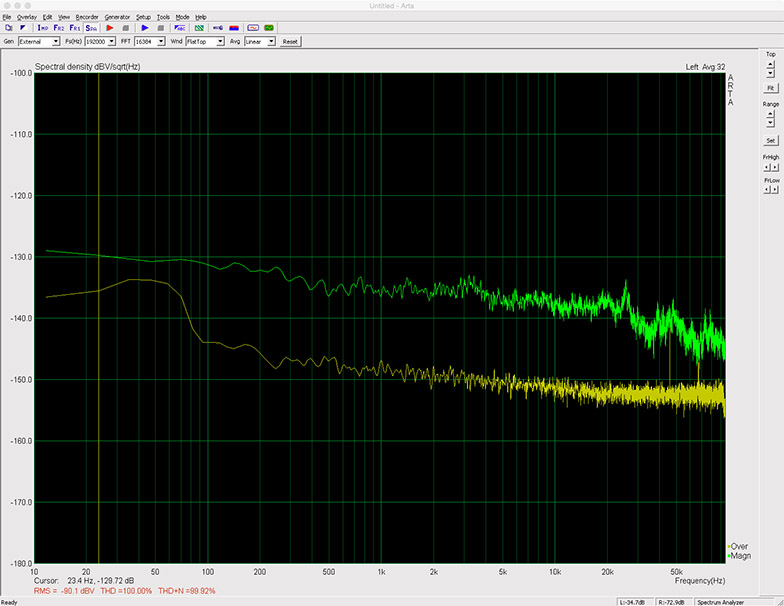

Andrew suggested placing the DUT in a screening case and connecting the cable screen to the case.
I grabbed my metal Brabantia rubbish tin. Conveniently it has a lid that flips up and when the interior bucket is removed the base is open i.e. it forms a cylinder with a closable lid, and it has a circumference just big enough to fit over my balanced to single-ended input board I want to test. Simply, I slotted it over this single-ended DUT and measured again, firstly with the test lead screen still connected to DUT GND and secondly with the screen connected to the metal trash can. There was no connection from DUT GND to this makeshift screening case.
Unsurprisingly, having the shield helped a bit. The yellow trace in the pic attached is directly comparable to the green one in post 129 (note I extended the frequency range). But connecting the test lead screen to the screening case rather than DUT GND resulted in a much poorer noise measurement - perhaps because the single-ended DUT had no connection to its enclosure? This is why I worry about what I am calling "false positives".
You are welcomed 😀.
I have no idea of what you are talking about. The preamp output is essentially single ended, although the extra resistor on the PCB allows building the kind of grounding I have indicated above.
