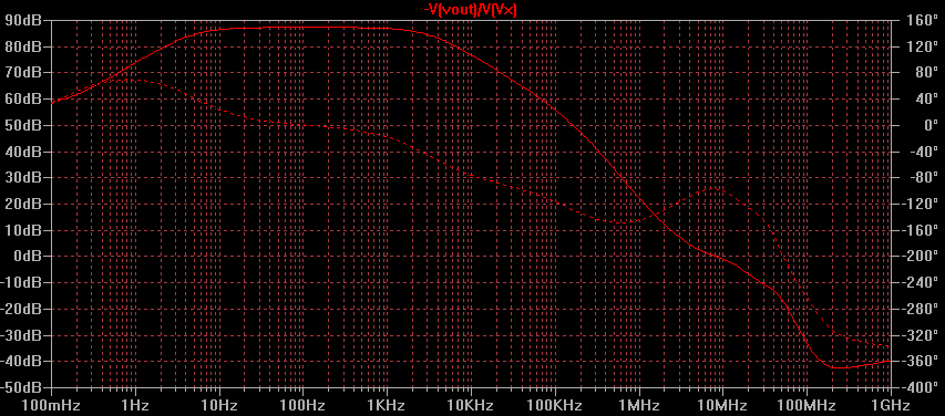

I've attached the open loop plot for the particular amp I'm thinking of...

is that graph showing ~35degrees of phase margin around 500kHz?
That big dip in phase looks wrong to me, but I am not an AC person.

............The dip in phase allows the open-loop gain to come down steeper in order to have the same phase margin with higher corner frequency, and more gain across the audio spectrum.
Yes,
I can see that. It crosses the 0dB @ <9db/octave.
It is steeper than 6dB/octave at frequencies below where it crosses 0db.
That was not what I asked.
Is that 35degrees of phase margin at around 500kHz?
Will that phase dip affect the audio performance?
