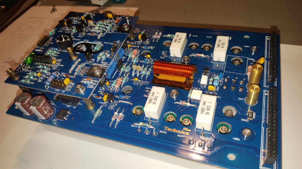

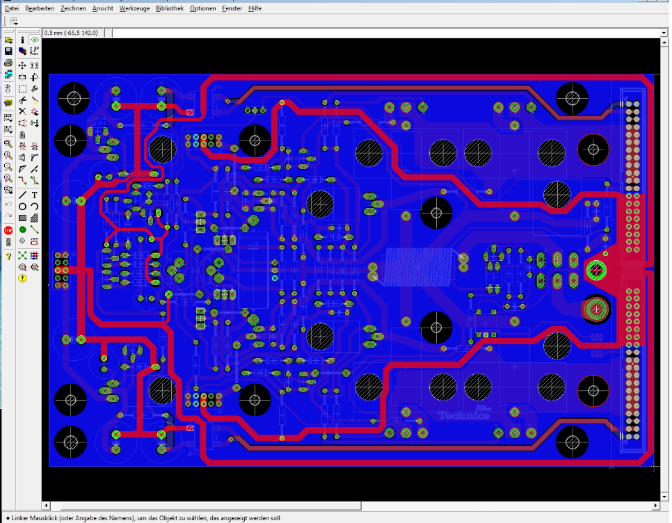

Ground Plane for Power Amplifiers
Well, here is a little amp pet project in which I put all traces on the top layer and a solid ground on the bottom to try out this highly controversial subject.
So who wants to throw the first stone ? :D
Edit: Sorry for that image glitch.
