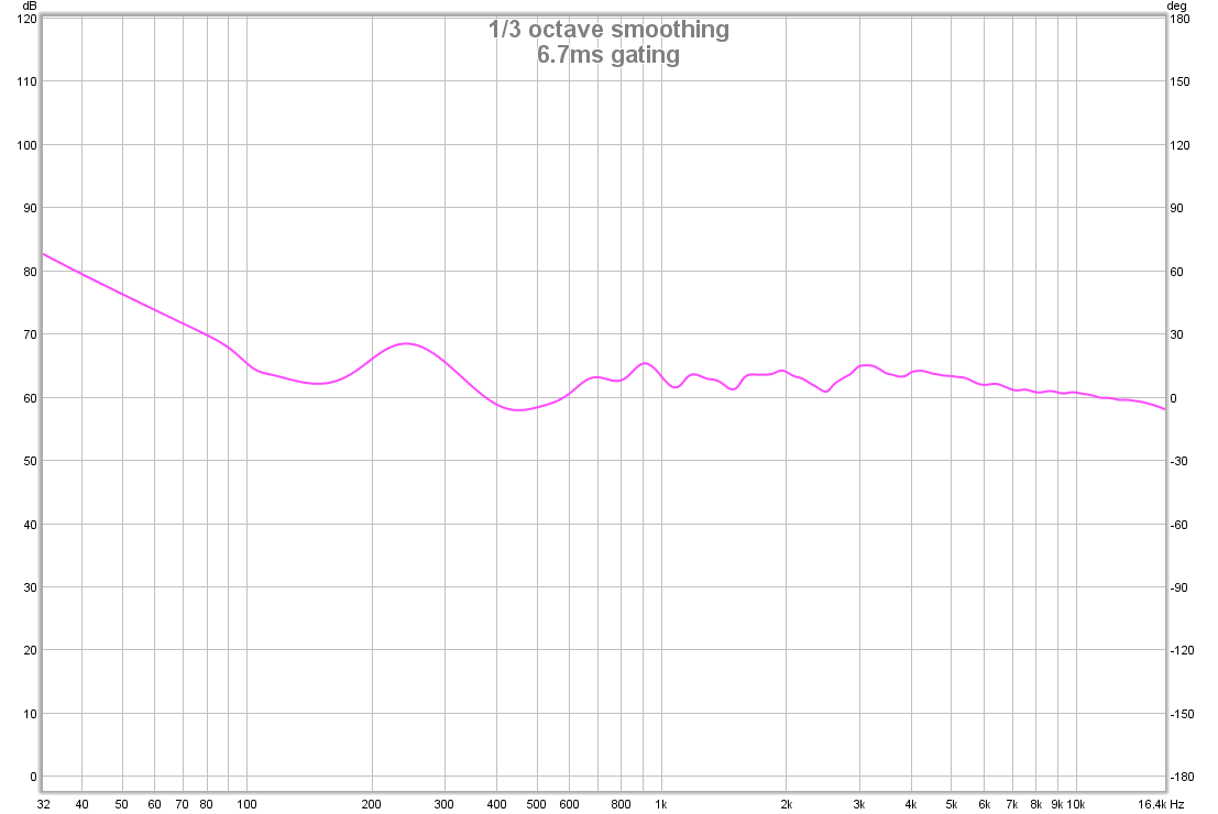

Just out of curiosity, do you have a plot of it? gated at 6 or 7 ms and measured at the listening position?
Here's how the left side looks.

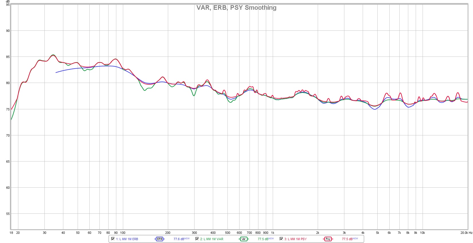

I missed that. Your right, PSY is new. In addition to "Psychoacoustic smoothing", there is also something called "ERB smoothing" (just now downloaded the new beta version)
![d smoothing.jpg d smoothing.jpg](https://www.diyaudio.com/community/data/attachments/452/452442-6e931e74772488c5fc6a0f1da7e4d7c0.jpg)

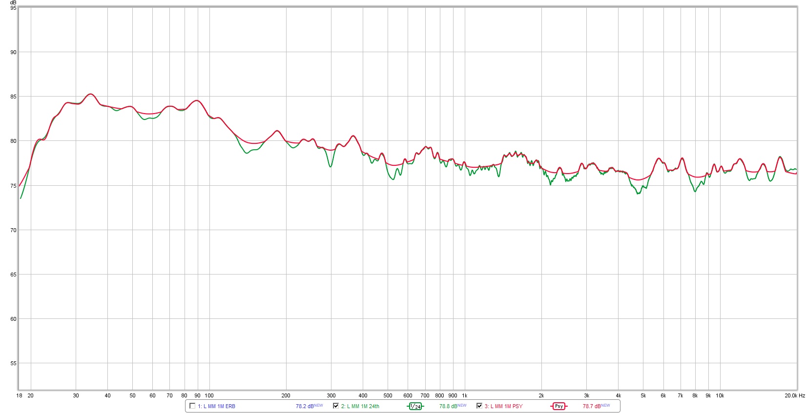

Here is what each looks like applied to the same measurement. I really dont know what either of these new ones mean or tell us. Anyone?
I have no idea where you got that ERB smoothing. I'm not seeing it, what is your REW version? 5.13 Beta 3 right? Or did I miss something
The psychoacoustic smoothing is trying to interpret what we actually hear. So it is windowing the frequency response with a variable window, mimicking how we actually hear sound and ignoring narrow dips as that is what our hearing seems to be good at too. In your case it's no surprise the results are close.
No idea yet how many cycles this window is set at. That would be good to know. As it is sort of what we talked about.
This filter is probably build to look at the direct sound we perceive. Only it comes in one handy smoothing tool so we don't have to browse different gating windows.
But what it's settings are would be good to know.

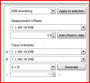

I have no idea where you got that ERB smoothing. I'm not seeing it, what is your REW version? 5.13 Beta 3 right? Or did I miss something.
Thats my version. You dont see "ERB smoothing" ?
On mine, its located between VAR and PSY
Lol, not on my version... do you run on a Mac by any chance? I'm running Windows.
Windows here also.
![erb sm.GIF erb sm.GIF](https://www.diyaudio.com/community/data/attachments/452/452487-7a9653dbee319268da8530cc156df160.jpg)
I downloaded mine from the link on post 52:
Feature Request: Frequency Dependent Windowing - Page 6 - Home Theater Forum and Systems - HomeTheaterShack.com
BTW, that's cool about freq dependent gating in REW. I had wondered about that myself.

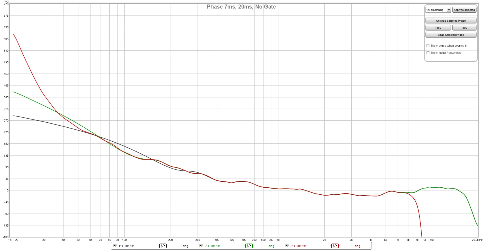

Greg, one more question for you. Do you eventually get a phase wrap at longer windows, say 100 to 500 between 100 Hz and 200 Hz?
Gated to about 15 ms I don't, but after that I have a wrap there. That's what I'm still fighting. I get another at an even lower frequency but I battle them one by one (lol). That's where I need a room like yours Jim!

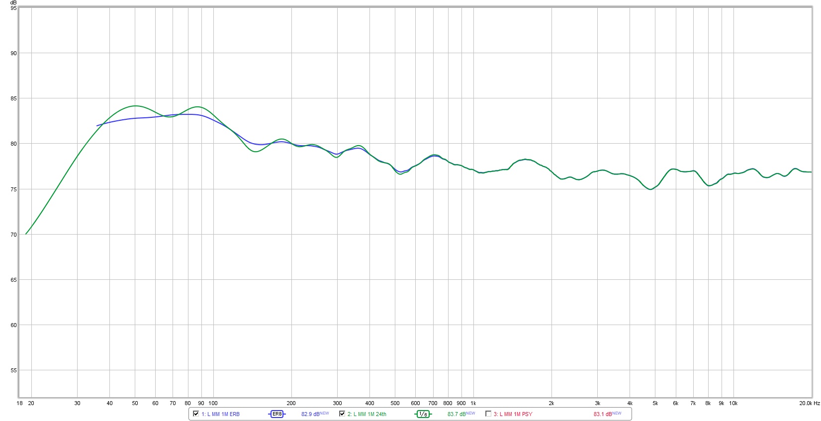

ERB matches 1/6th smoothing down to about 800hz, then begins to deviate with what looks like enhanced smoothing further down.
There's an ERB template in DRC, it's also a kind of windowing based on some psychoacoustic principles I believe. But it didn't do that well in the bass department for me. I disregarded it for that reason. The timing of that window is described in the ERB template, let me look it up:
ERB appoximation windowing (65 ms at 20 Hz, 48.5 ms at 100 Hz, 12.6 ms at 1 KHz, 0.46 ms at 20 KHz)
So that's a pretty long window at high frequencies and relatively very short at lower frequencies.
Kind of like correcting the direct speaker sound and leaving the bass to the room in DRC correcting if you ask me...
65 ms is a little over one cycle at 20 Hz. Yet 0.46 ms is almost 10 cycles at 20 kHz.
Impressive.
With my left channel measurement (the only one I have handy right now for some reason), a phase wrap at 200hz appears suddenly at 16ms. Interesting how close in time it is to yours...
Impressive.
Thanks. You wouldn't like the ungated response though...
