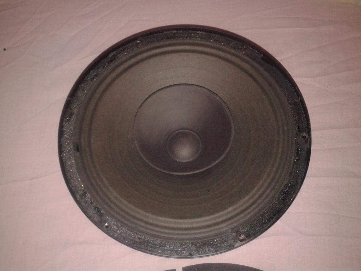

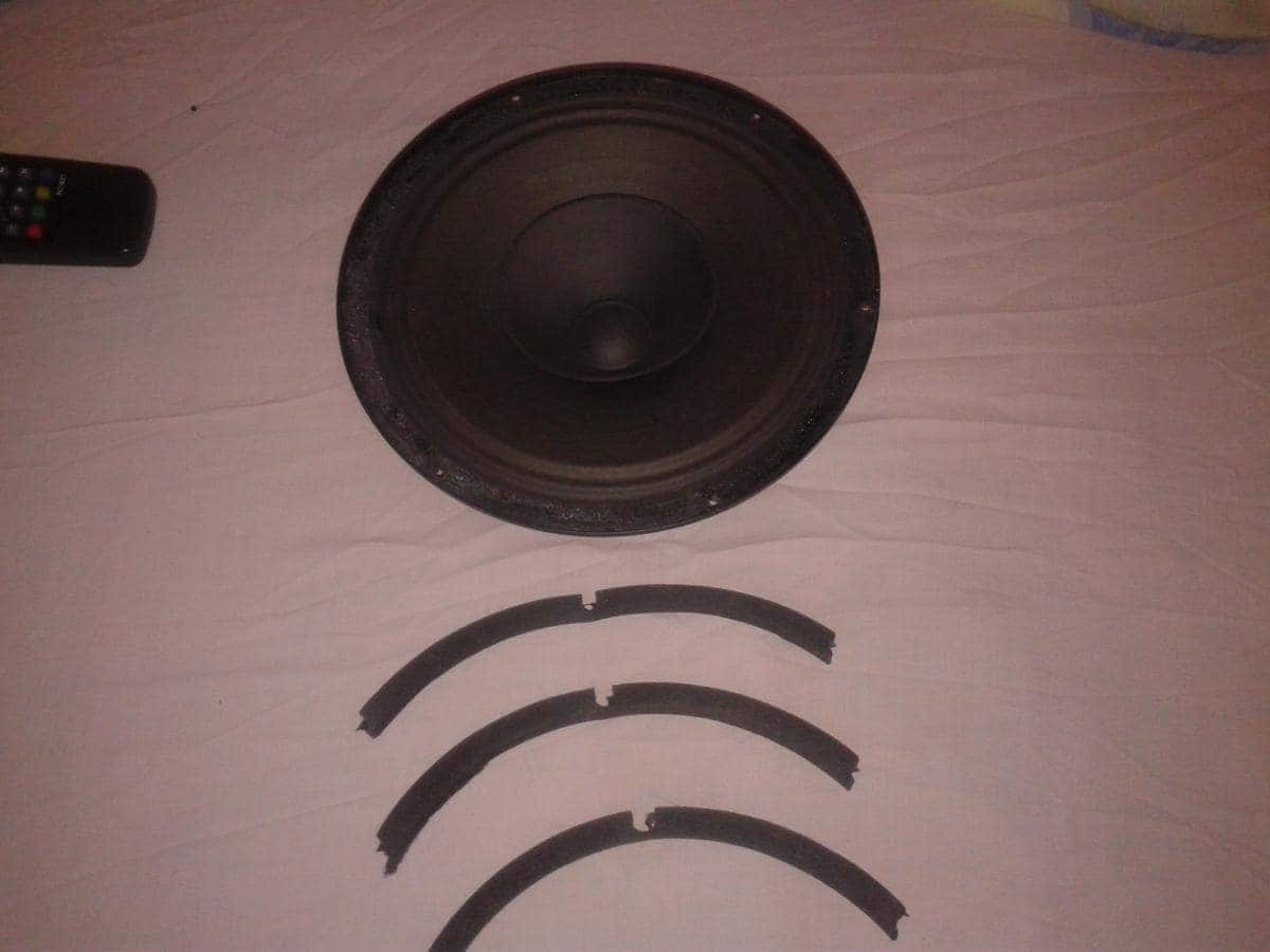

Foam is lighter than rubber and the termination of the cone edge is different depending on mass and resisitive losses in the rubber/foam edge. So it all depends on application.
Foam is known to have the lowest inner resistance (less losses) and good damping. Textile surround has also low resistance (less losses) but no damping. Rubber has more losses than foam but good damping, too.
However the longest lasting surrounds which withstand aging is paper and textile surround.
My personal favorite is textile surround.
It's lightweight does not have much losses and lasts for very long time.

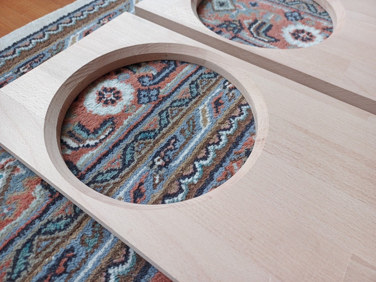

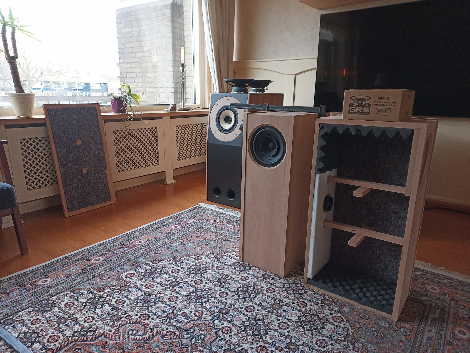

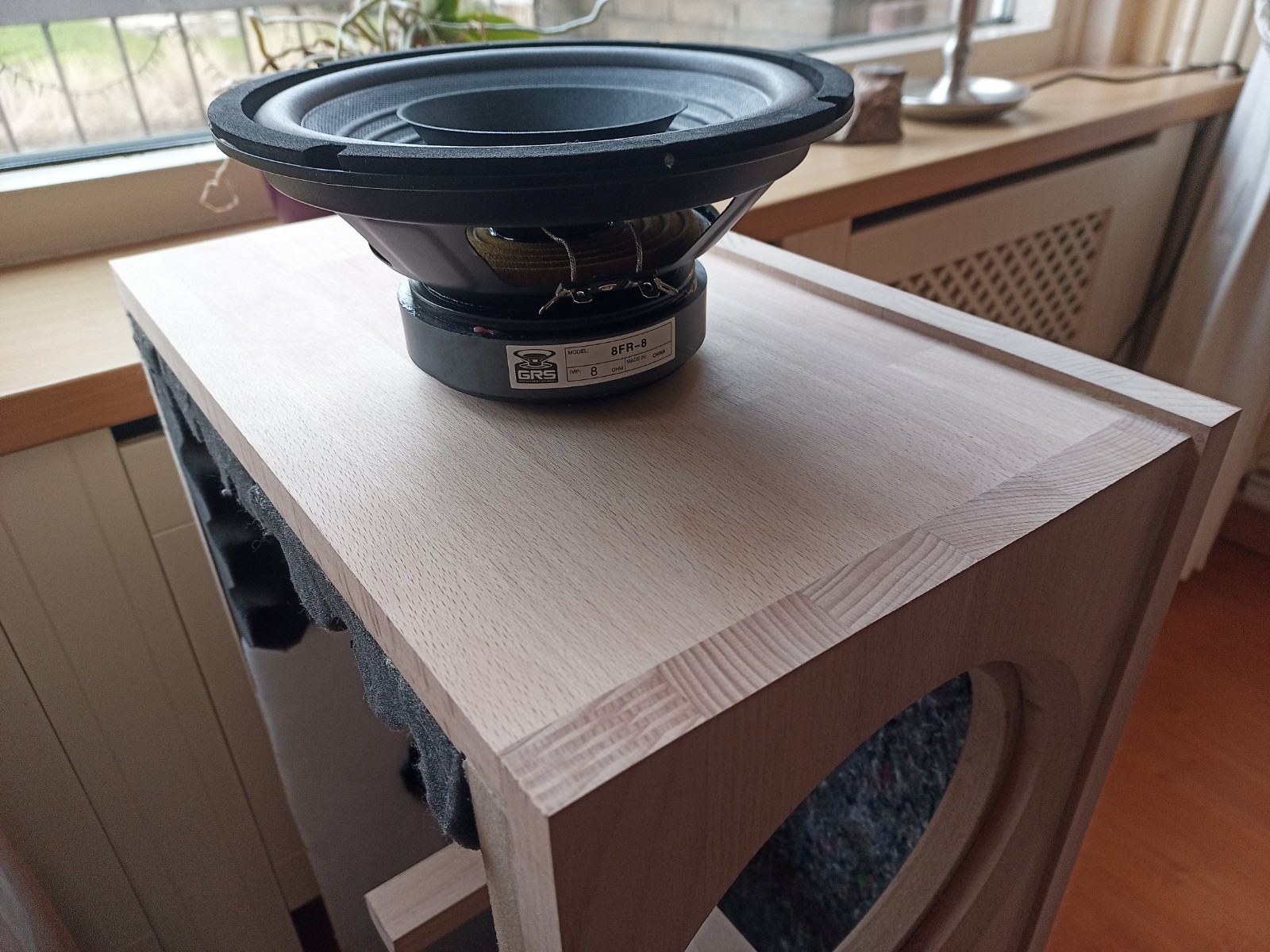

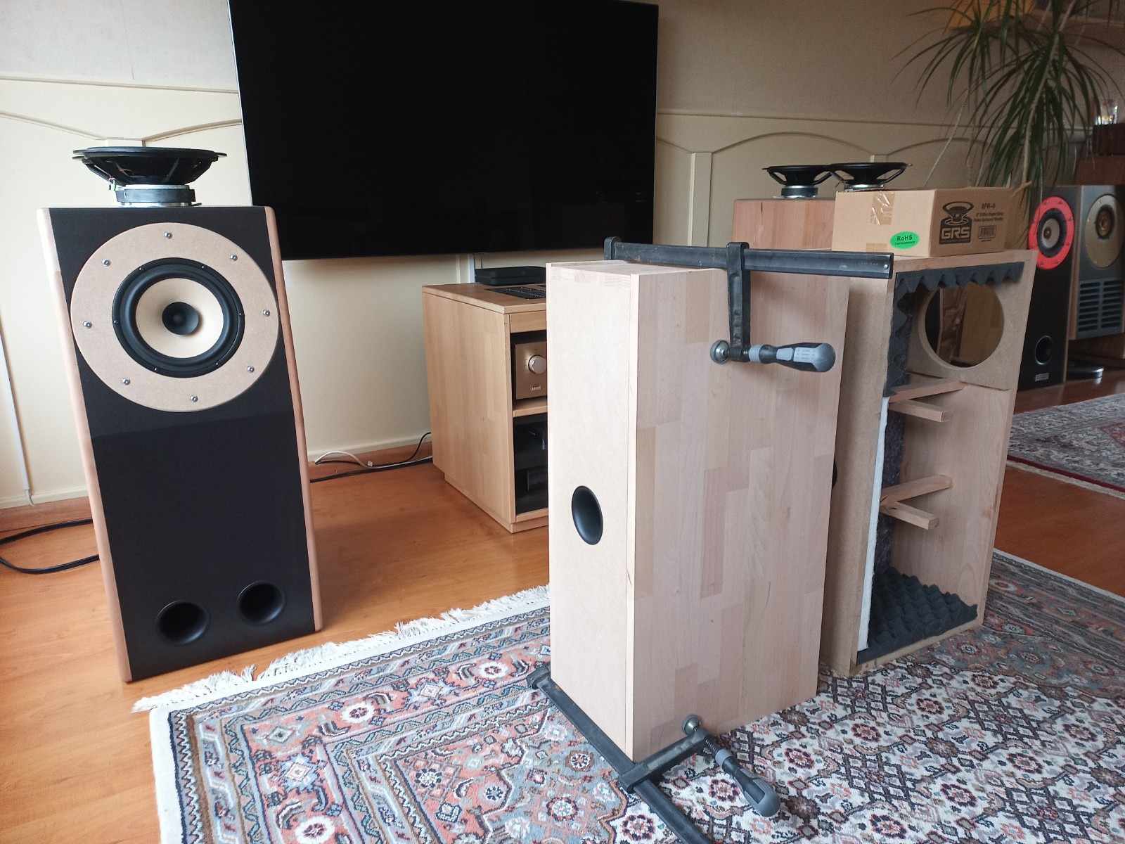

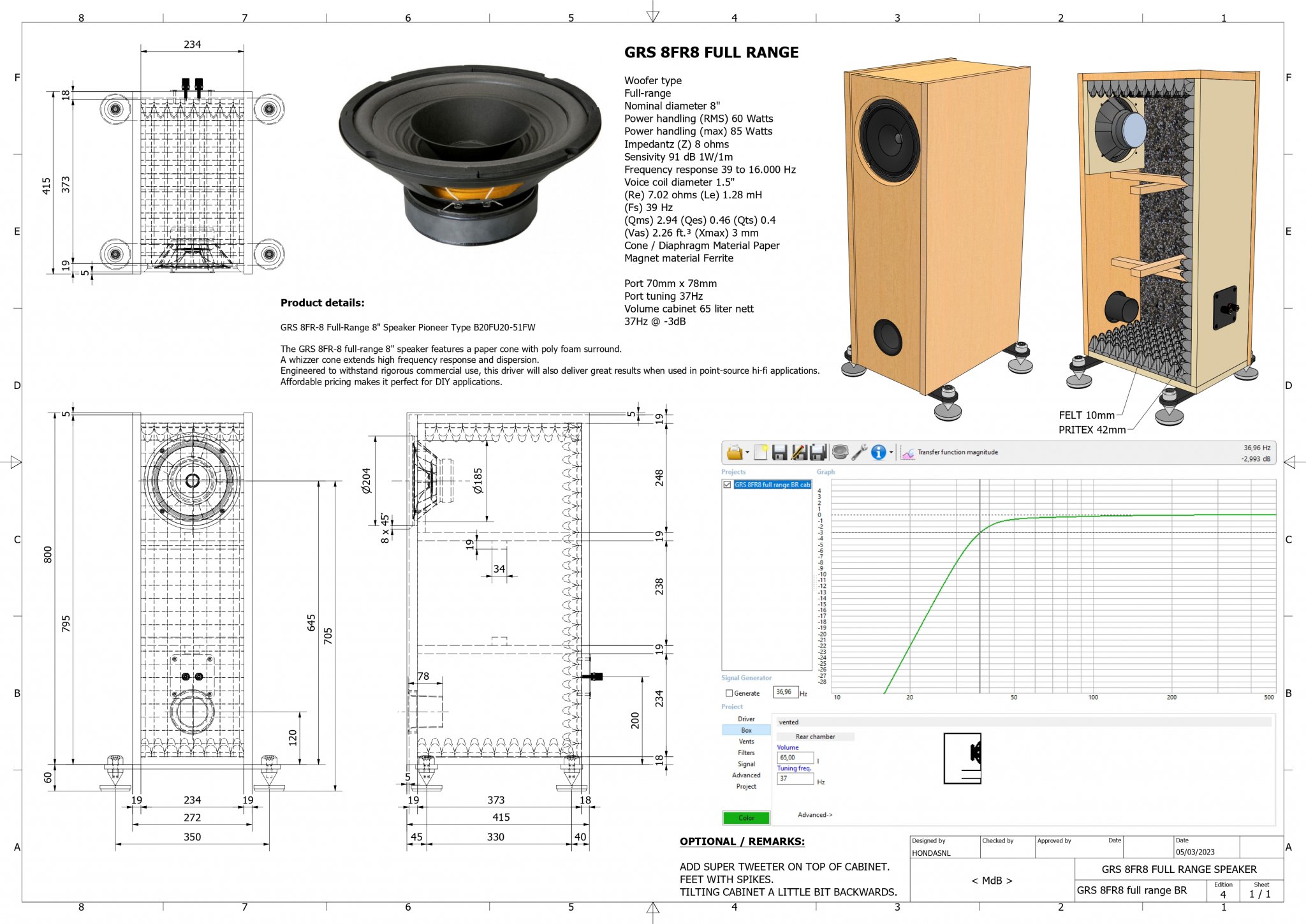

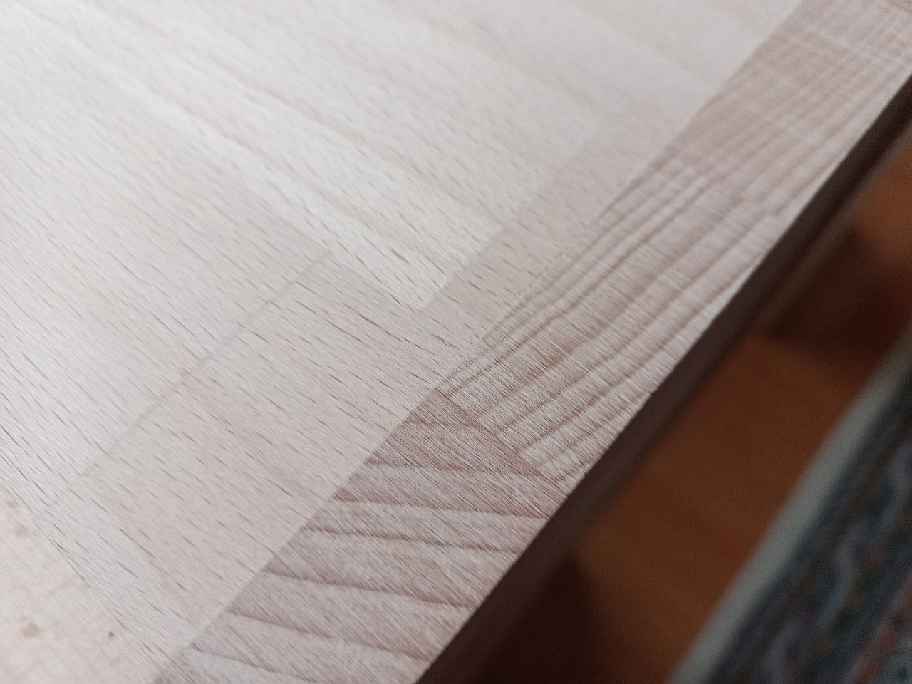

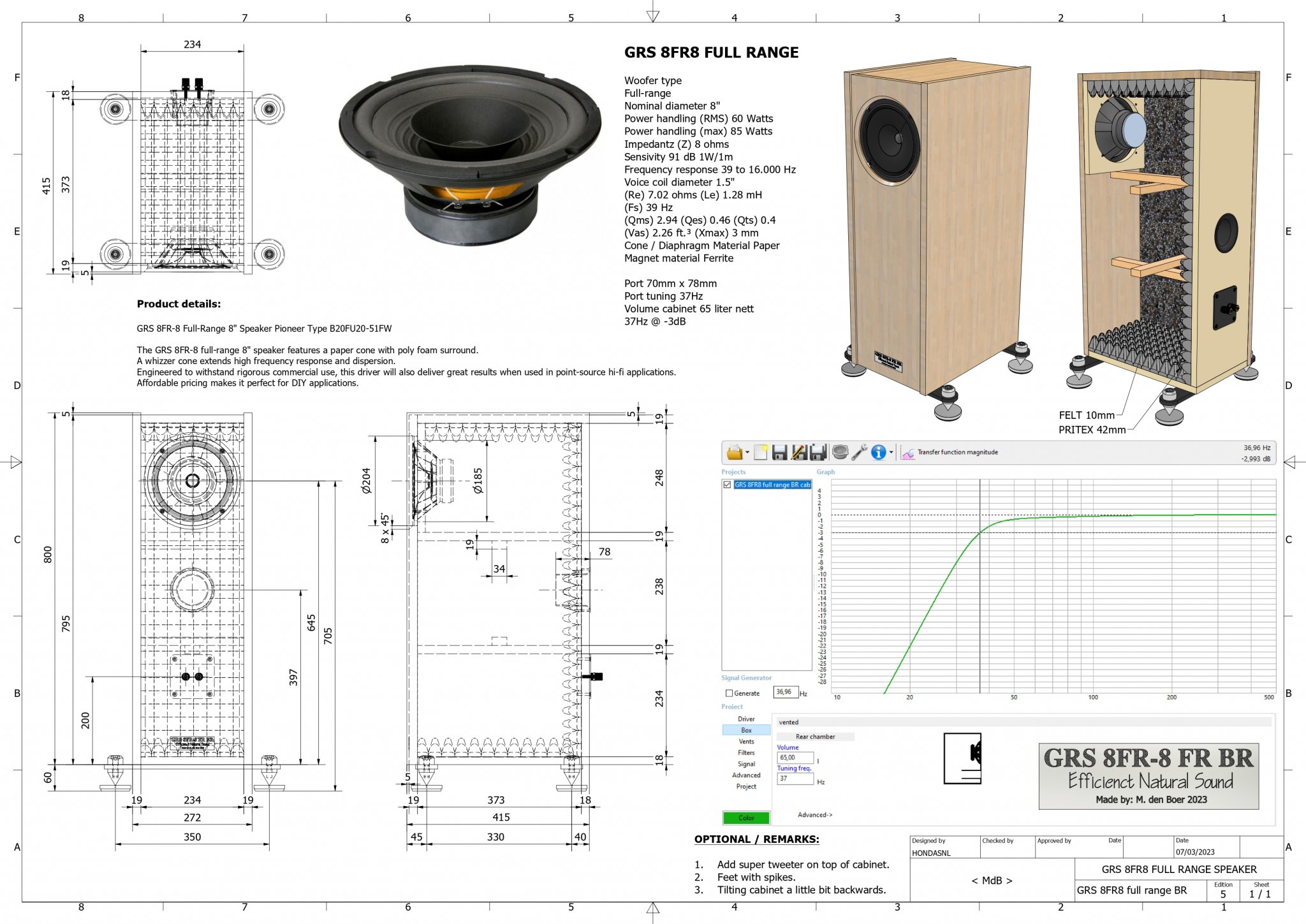

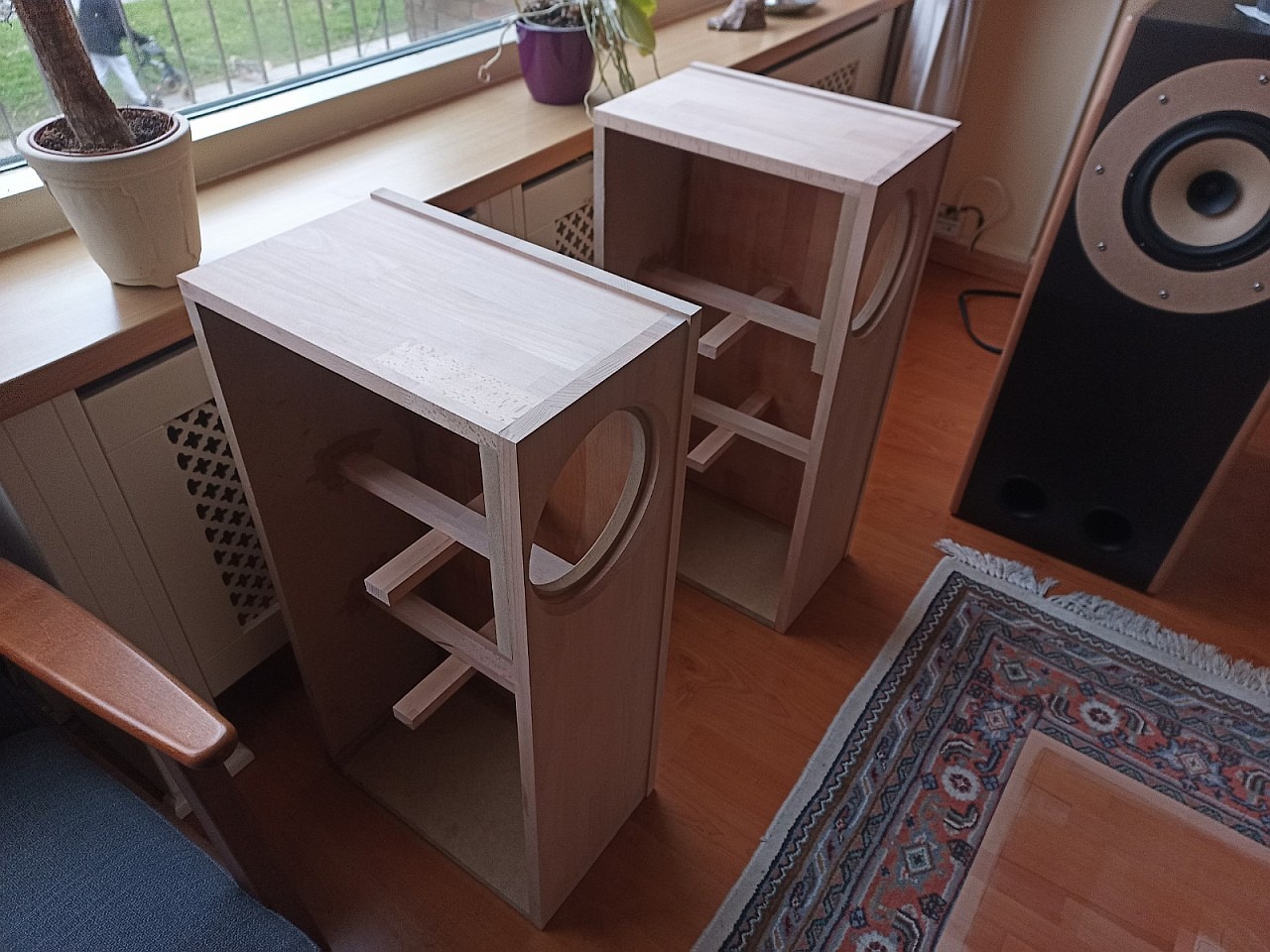

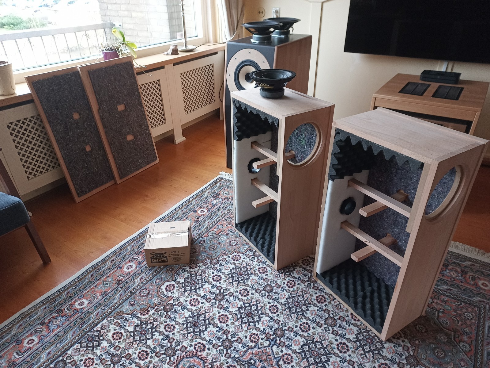

Started with the cabinets.
Some little modifications due to availability of wood in my garage.
Hole for the port has to be added yet.
Maybe better position at the rear?
Wood looks great.
A professional for loudspeakers recommended me after thorough listening tests: best is reflex close to the driver concerning homogeneity in sound. Here you have some small efficiency gain due to coupling diaphragm with reflex port.
For even more bass the reflex should be close to the floor.
For those who seek no mid tone emission from reflex to be audible put reflex on floor height on the backside of enclosure

I think then I reposition the port to the back of the cabinet and closer to the driver.hWood looks great.
The speaker looks also nicer and cleaner.
More output then with help of the wall behind te speaker?
If the port is close to any room boundary you get +3db. If you put a box with reflex on floor height close to the back wall +6db - in the corner +9db.
However some frequencies profit a bit more so correction with Dsp or eq can bring the overall balance back all this with gain in efficiency.
If you cannot measure and adjust you can only experiment where it sounds best in the room
Well presented
Well presented info Dave, even makes sense to me the way you say it outGuidline 1: braces should be placed such that the subpanels created by the brace should have an aspect ratio larger than the panelbeing braced.
This is clearly not the case in your design, where the aspect ratios are all less. You want to push resonances up in frequency where they will be less likely to get excited.
A reflex box is assummed to be “close" to a cube. As one dimension grows a quarter-wave resonance starts across the longest dimension. Your box is tall enuff vrs width/depth that it will be an ML-TL. The end-loaded driver and vent will maximize the quarter-wave effect.
dave
Easy-peasy way to look at it is, which orientation is most appropriate relative to gravity regardless of aspect ratio?

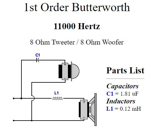

Maybe in the future, if this project has finished, I like to add a separate additional small tweeter cabinet loose on top of this cabinet for experimenting.
I'm thinking about the GRS 1TD2-8.
This in combination with a very cheap and simple crossover.
Frequence response of the GRS 8FR-8: 39 to 16.000 Hz - 91 dB 1W/1m - 60 Watt RMS
Frequence response of the GRS 1TD2-8: 2.100 to 20.000 Hz - 90 dB 1W/1m - 60 Watt RMS
I'm thinking the crossover point about 11.000 Hz will be okay?
1st or 2st order?
Unfortunately I can't find curves of the drivers.
1st or 2st order?
Some Pioneer BOFU measurements the GRS claims to replace.......
Anyway, it's a good plan to be at least -24 dB @ Fs/1,050 Hz:
2^4 = 16,800 Hz/1st
2^2 = 4,200 Hz/2nd
sqrt(2*2^2) = ~2,970 Hz/3rd
2^1 = 2,100 Hz/4th
Which falls right in line with its rated 2,100 Hz lower limit.
The GRS 8FR-8 1.5"/3.81 cm voice coil (VC) frequency = 34400/pi/3.81 = ~2,874 Hz and skipping over a lot of repetitive math, the closest polar matching octave spread to the tweeter's 2,100 Hz is ~2,196 Hz, so 1st order = (2,196/2)*2^4 = 17,568 Hz.
2^4 = 16,800 Hz/1st
2^2 = 4,200 Hz/2nd
2^1 = 2,100 Hz/4th

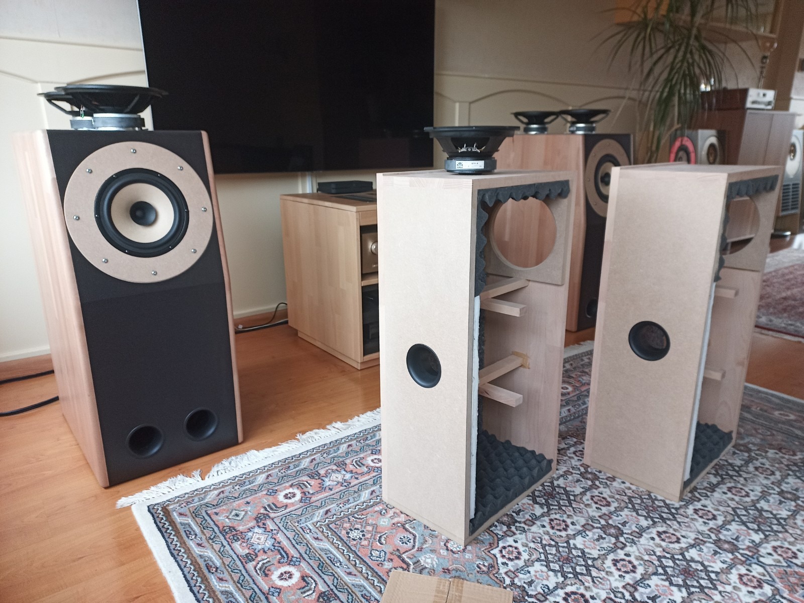

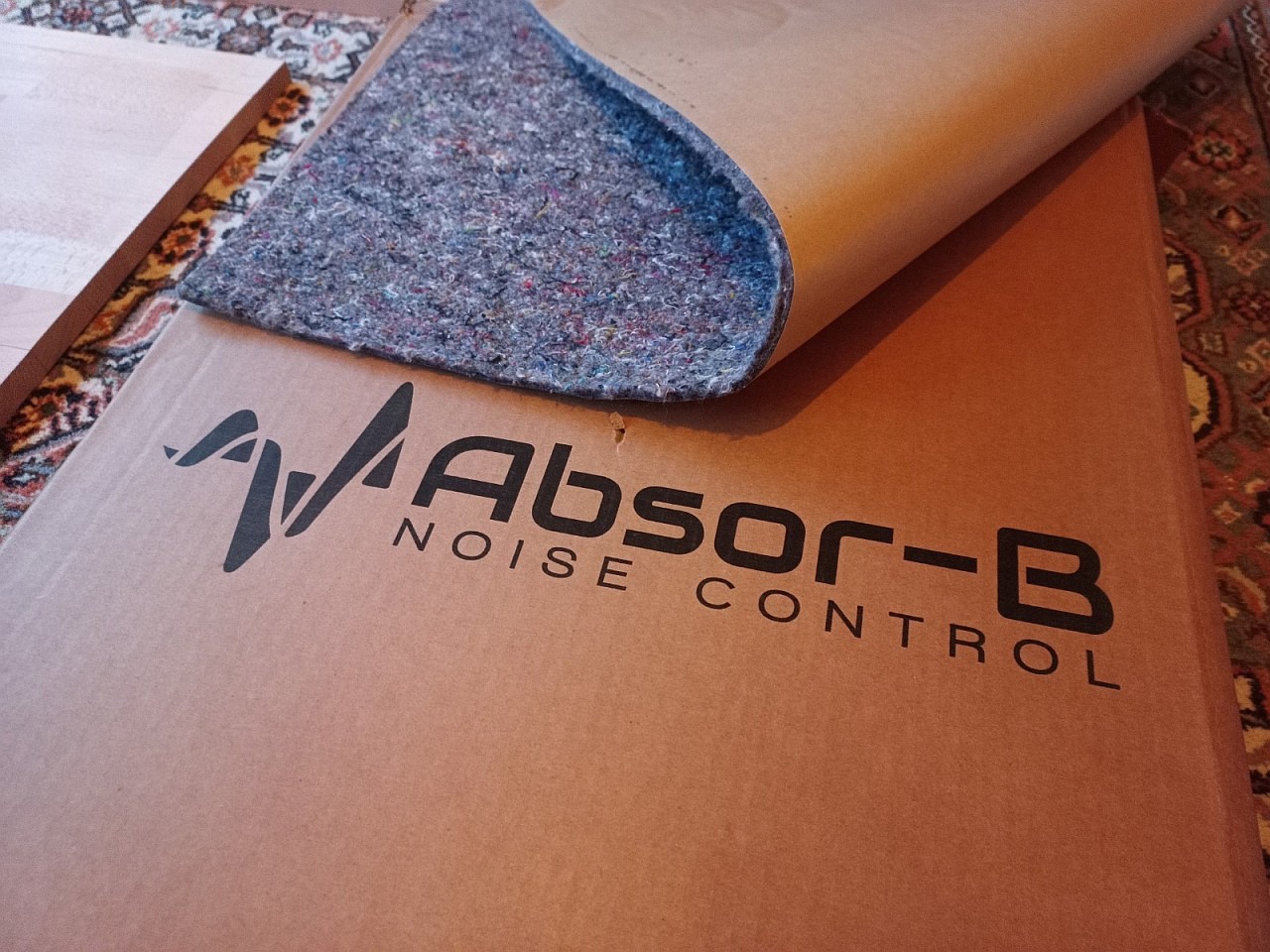

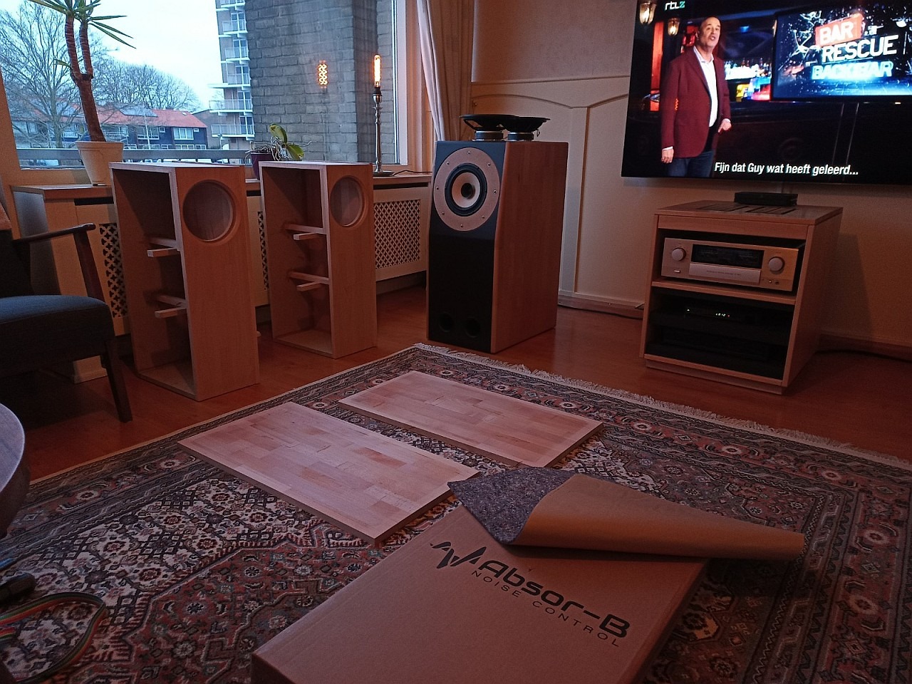

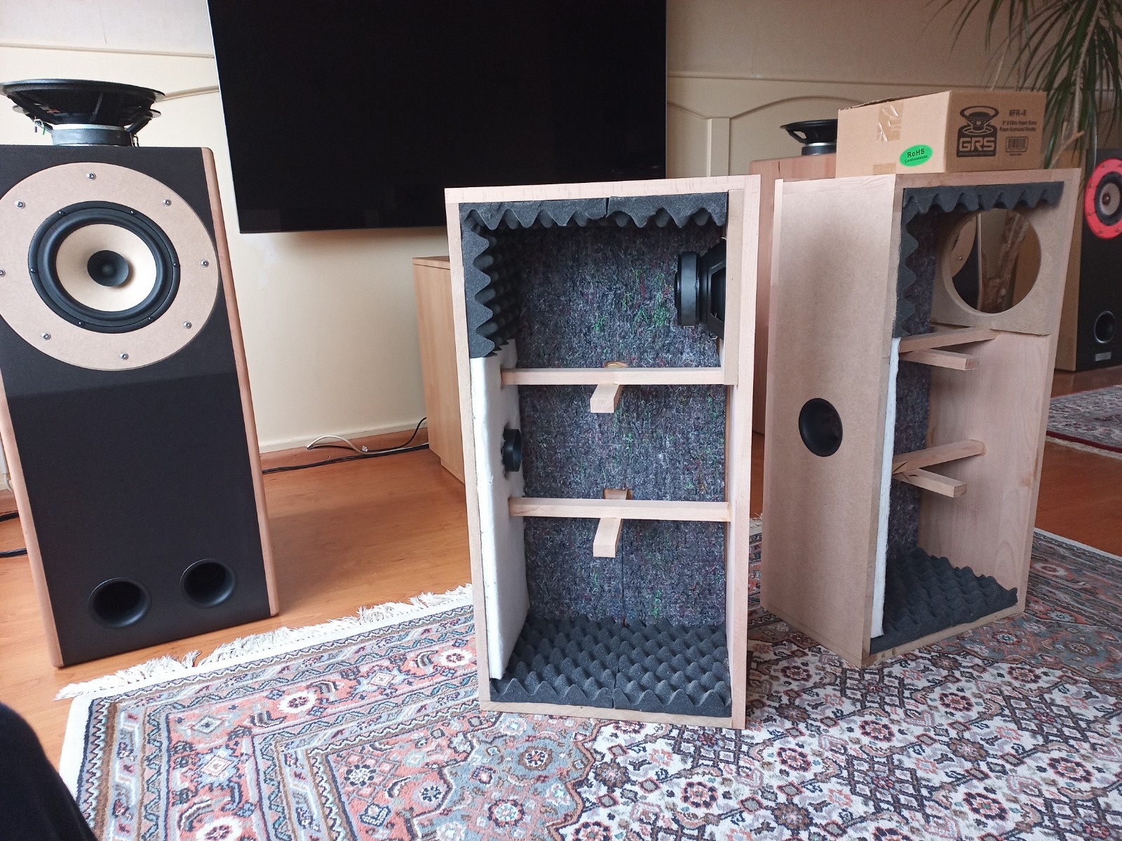

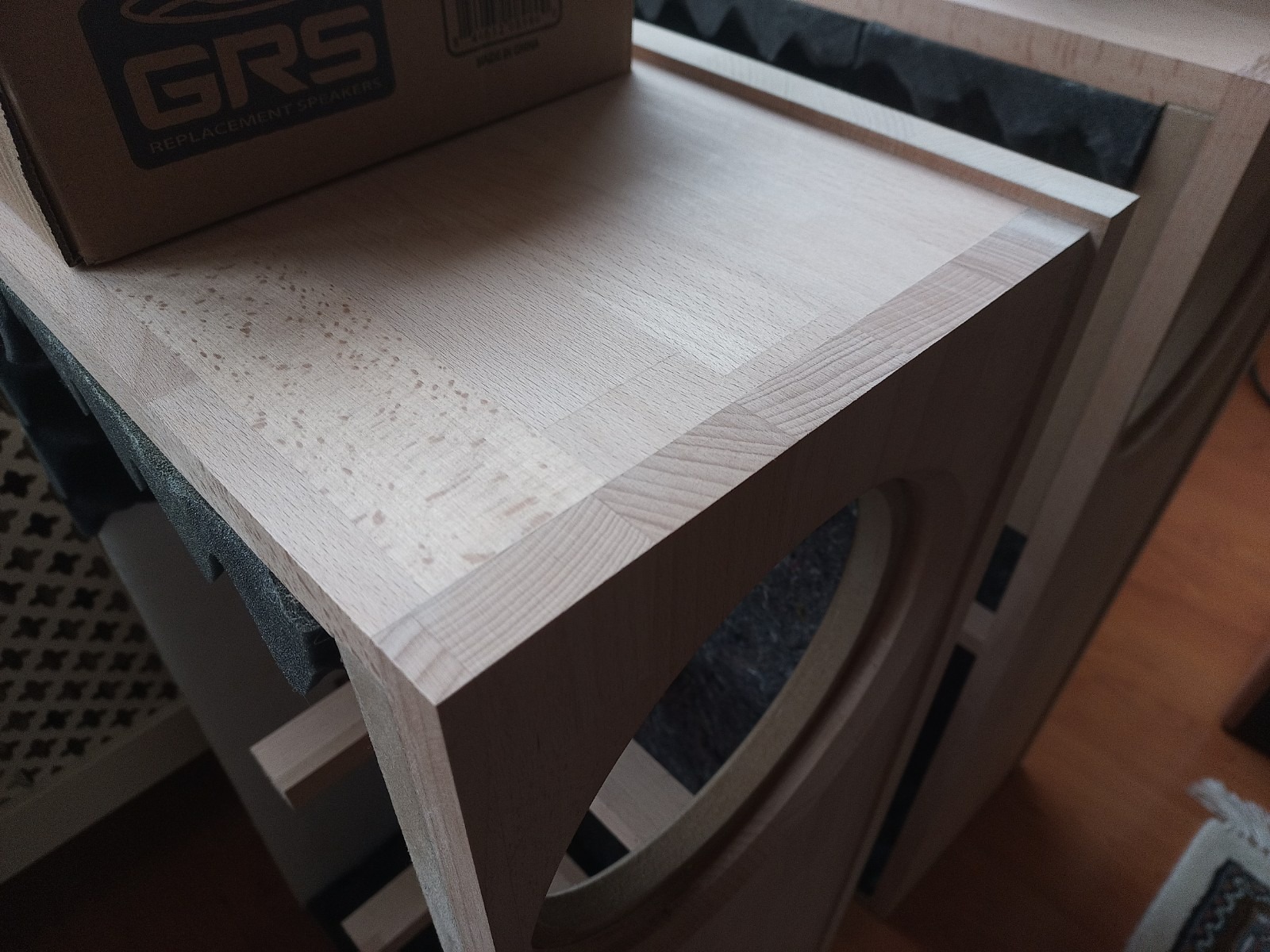

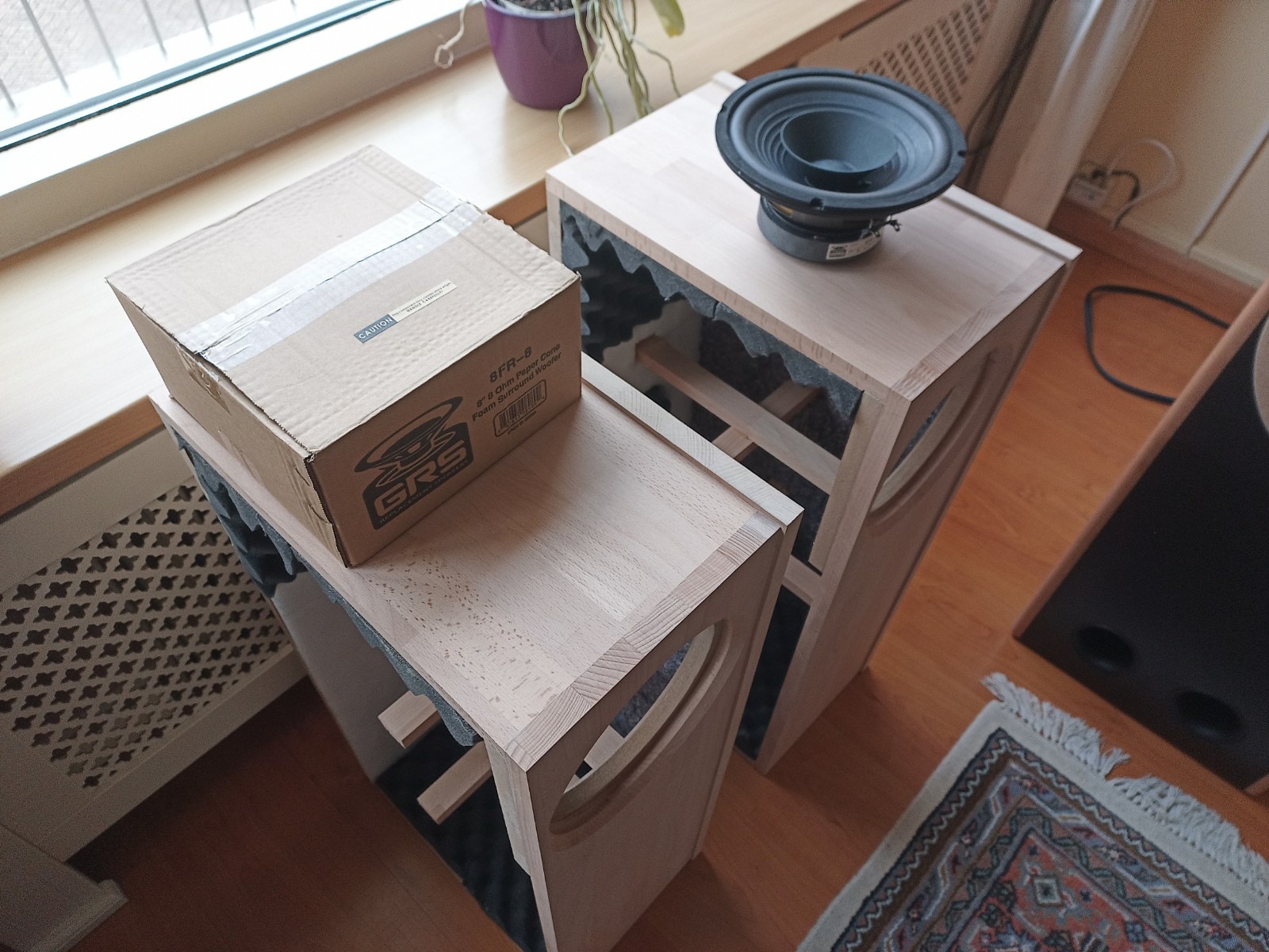

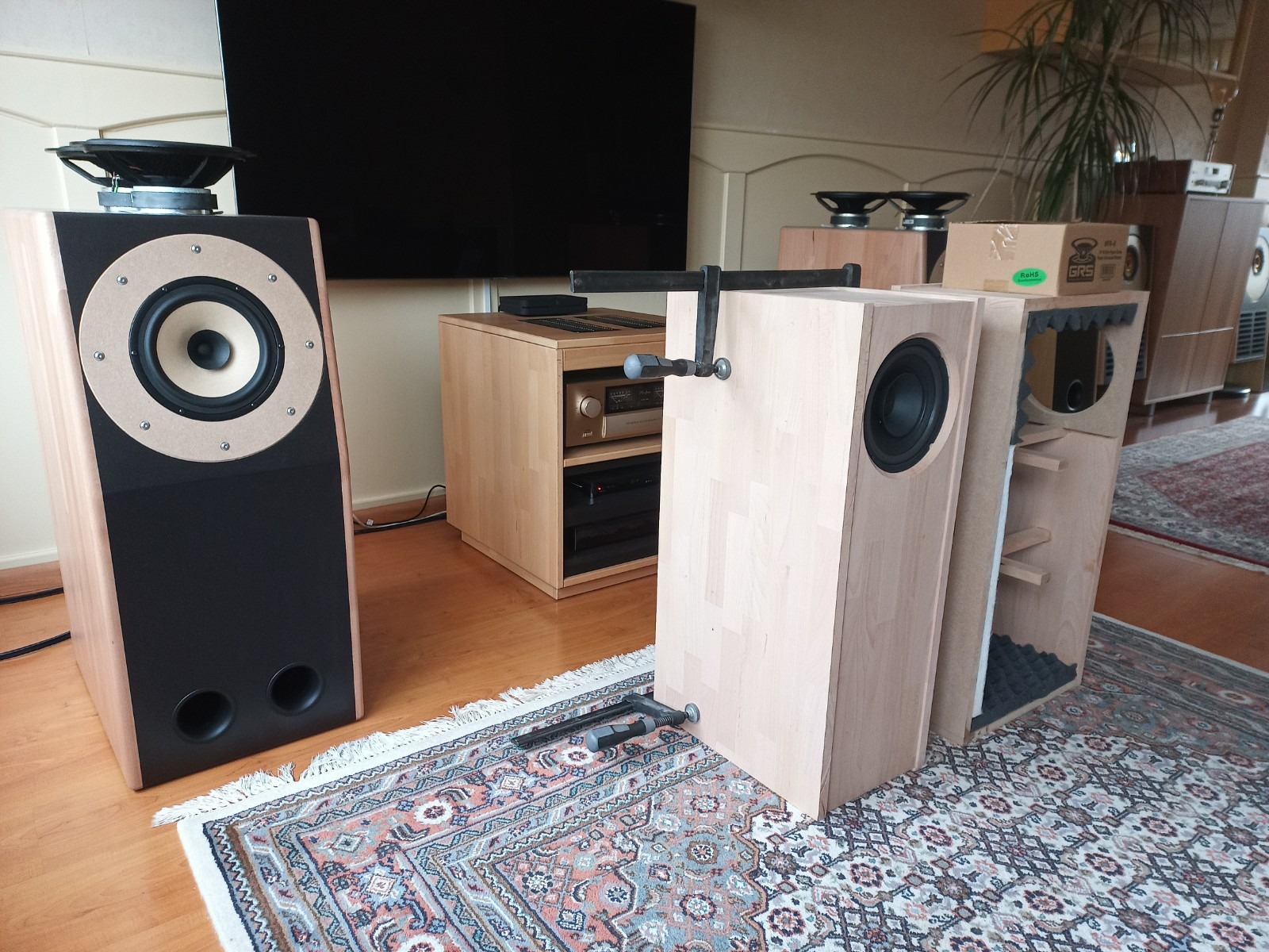

Some progress on the cabinets.
Secretly done the knock test carefully.
Sounds good so far.
M curious 😀.
Damping materials are remnants of past projects.
Sounds good so far.
M curious 😀.

i have to correct myself.
Visaton BG20 has a textile surround.
I had in mind it was of paper but its textile type. My favourite type of surround.
So BG20 is a fine fullrange driver in my eyes
