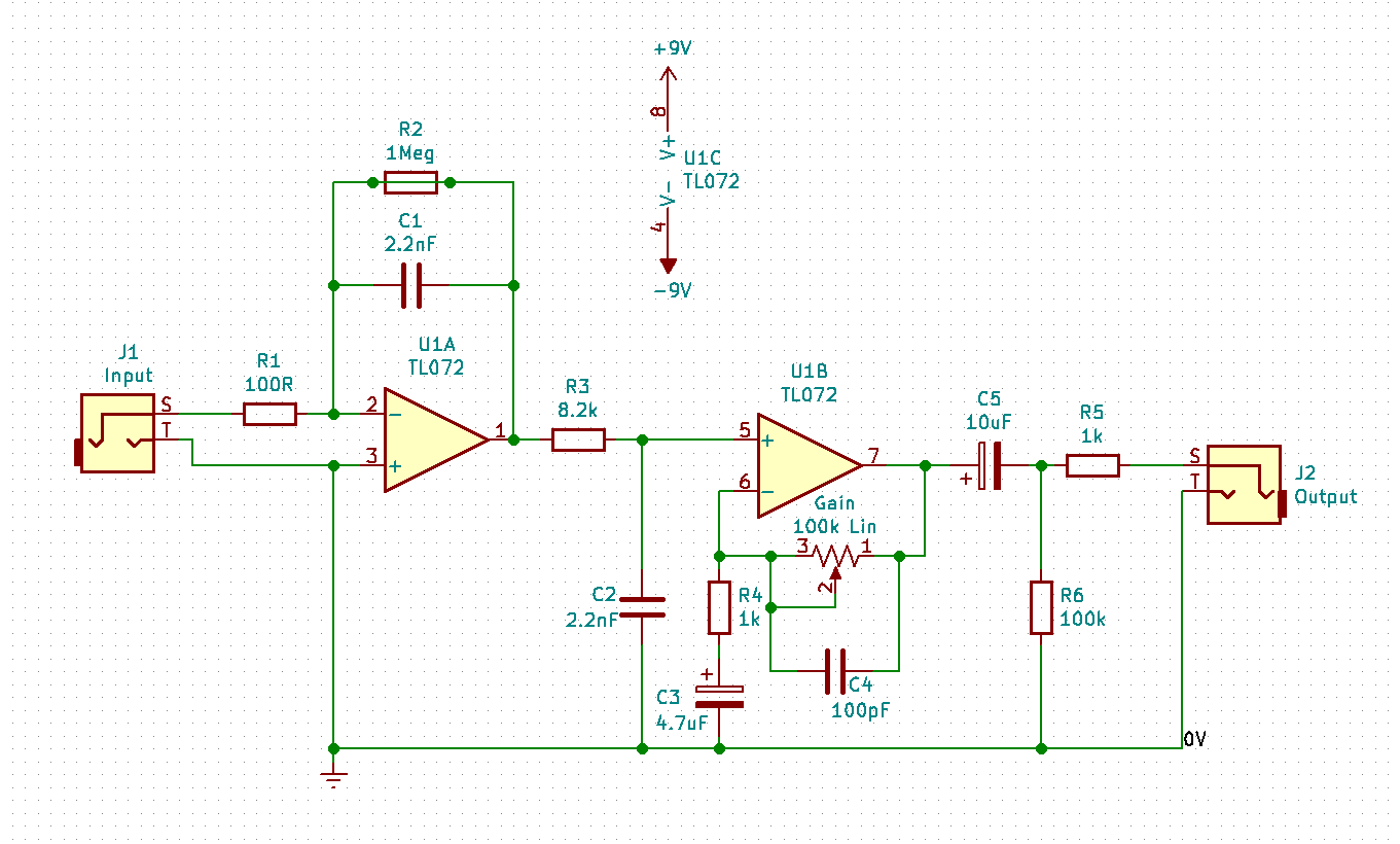

I am looking for a buffer-pre-amp circuit for an Acoustic guitar Piezo pickup, a raw one, probably above 10M impedance...
I ao considering using the following circuit ::::
I can see that most of you are happy with this design,
So I wonder if that will be ok for Piezo too and not magnetic pickup..
another question is - what is the output impedance for this circuit? I am trying to design a tiny "sound card" so I want the guitar to be connected to PC through this preamp- then PCM1803A with 40K input impedance.. and then the I2S with USBStreamer...
Thanks a lot

In short, you need to know what you're after. Then we can talk circuits and why your 10db booster will never give you fuzz
Frankly, I'd be getting an overdrive pedal (a cleanish one like the Boss OD-2 or BD-2 or .... ) and one or two EQ pedals (wired up EQ-OD-EQ) and work out what you need long before I messed with your guitar-to-line preamp
Is your piezo pickup the type that looks like a thin long strip, which fits under the saddle? If so, it will typically have a capacitance of maybe 500 pF - 1 nF. If you build the traditional audio piezo preamp, you will indeed need about a 5 mega ohm input resistance....Piezo pickup, a raw one, probably above 10M impedance...
However, this is quite a bad idea, especially if the preamp is located more than a few inches from the piezo itself. With such a high input impedance, the circuit will be extremely prone to pick up hum. Simply moving your right hand into playing position near the bridge of the guitar may be enough to cause a loud hum from your speaker.
So I designed a very different type of piezo preamp for you. Rather than try to have an enormously high input impedance, this one has the opposite, an extremely low input impedance, which makes the circuit much less likely to hum and buzz. The current from the piezo pickup is fed into an integrator built around U1A and C1. What comes out of this integrator is exactly what you want - a nice low-impedance signal, with a flat frequency response down to below the lowest note from an acoustic guitar in standard tuning (about 83 Hz.)
A second op-amp (there are two opamps in the suggested TL072) is used to amplify the signal from the piezo, and it's gain can be adjusted with the 100k gain pot. I don't know how much signal your piezo puts out, so I don't know how much gain you need. But the pot has a wide gain adjustment range, so it should cover what you need.
I've designed this to be powered by two 9V batteries, wired in series to provide +9V, 0V, and -9V. You can make slight modifications that will let you run the circuit on a single 9V battery, but that will reduce headroom.
Output impedance of an op-amp circuit is extremely low, a few ohms or even less. However an op-amp can become unstable if you connect it to a long shielded cable (too much capacitance), so I've added the 1k resistor R5 to my circuit to keep the op-amp happy.what is the output impedance for this circuit?
