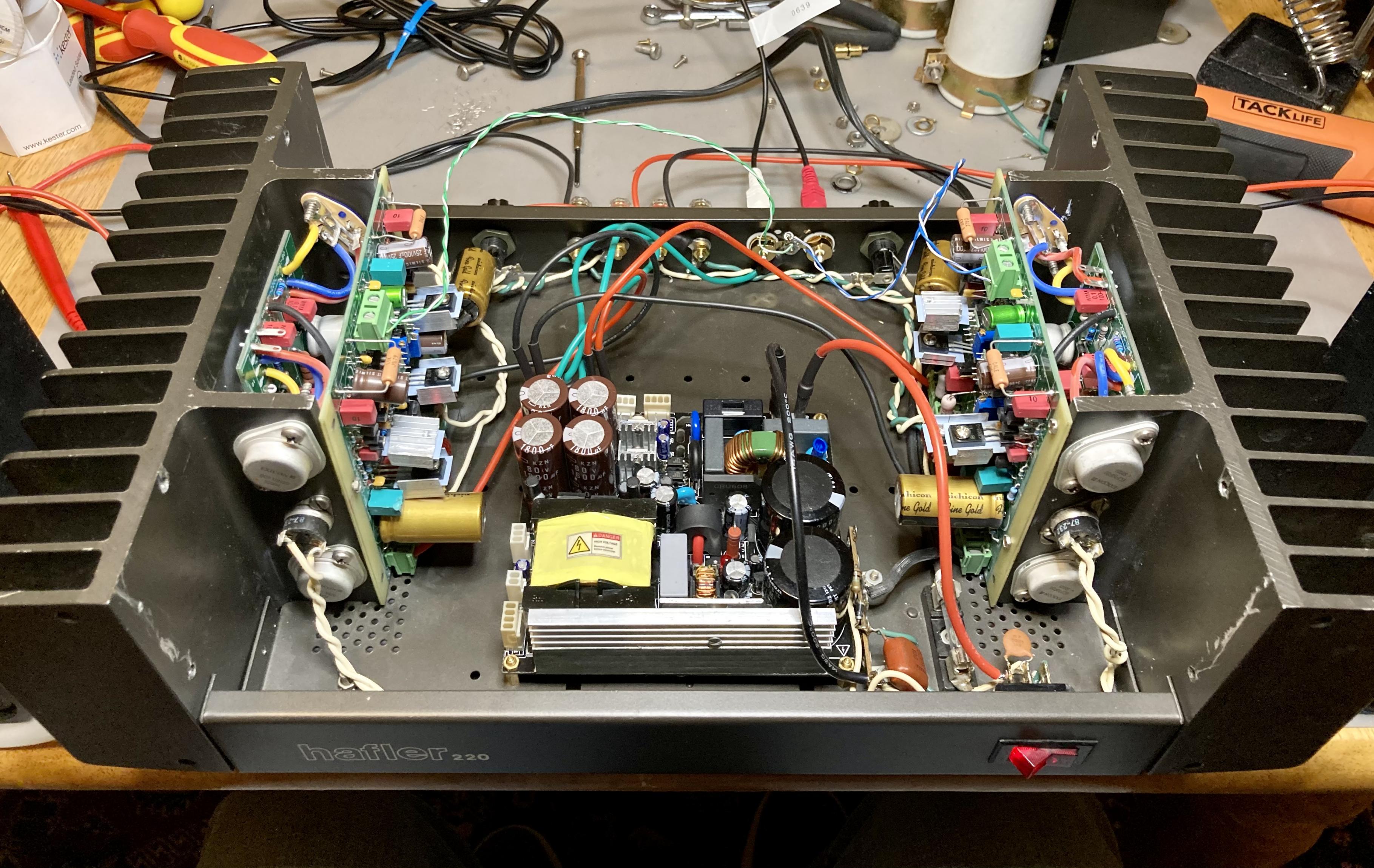

SMPS Success!
I removed the stock transformer and power supply, installed a Cresnet SMPS-600, and made all the logical connections. I kept the stock circuit for the mains fuse and power switch. Also took the opportunity with the old power supply out to enlarge the RCA jack openings and install better jacks.
The SMPS measured 67VDC unloaded. After I made sure everything was operational and even played test music through it for a bit, I buttoned up the top and have been playing more music with the test speakers, which admittedly sound pretty darn good (tang band full range drivers in minimus 7 cabinets). 😀
After about 45 minutes of operating well without any problems, the heatsinks are suitably warm, just as they would have been with the stock power supply. Maybe a couple degrees warmer (around 122F/50C).
It sounds just as good as before, possibly a tad bit more refined, with more discernible mid and high detail. But that’s all based on memory, fatigue, and elation at a successful tinkering. 😀
It’s also dead silent, which is why I wanted to try this. The stock transformer had developed a mechanical hum that really annoyed me.
So let this be proof positive that a DH-220C can work well with a SMPS!

Congratulations! This is a great accomplishment! Thank you for sharing it with us.
How much did the Cresnet SMPS-600 cost?
You mentioned that the SMPS measured 67 V rails no loaded. Was this truly unloaded, or under conditions of being loaded with the quiescent bias current of both channels. I'm curious about the regulation of the SMPS-600.
Bob
Thanks, Bob. I got this SMPS from a fellow forum member and paid ~90 USD for two of them. According to Cresnet, this is an older model. If I recall correctly, it is also unregulated, which I thought would in theory work well with the Hafler since the original PS was unregulated. The 67VDC output was measured completely unloaded. I should measure the output with everything connected...

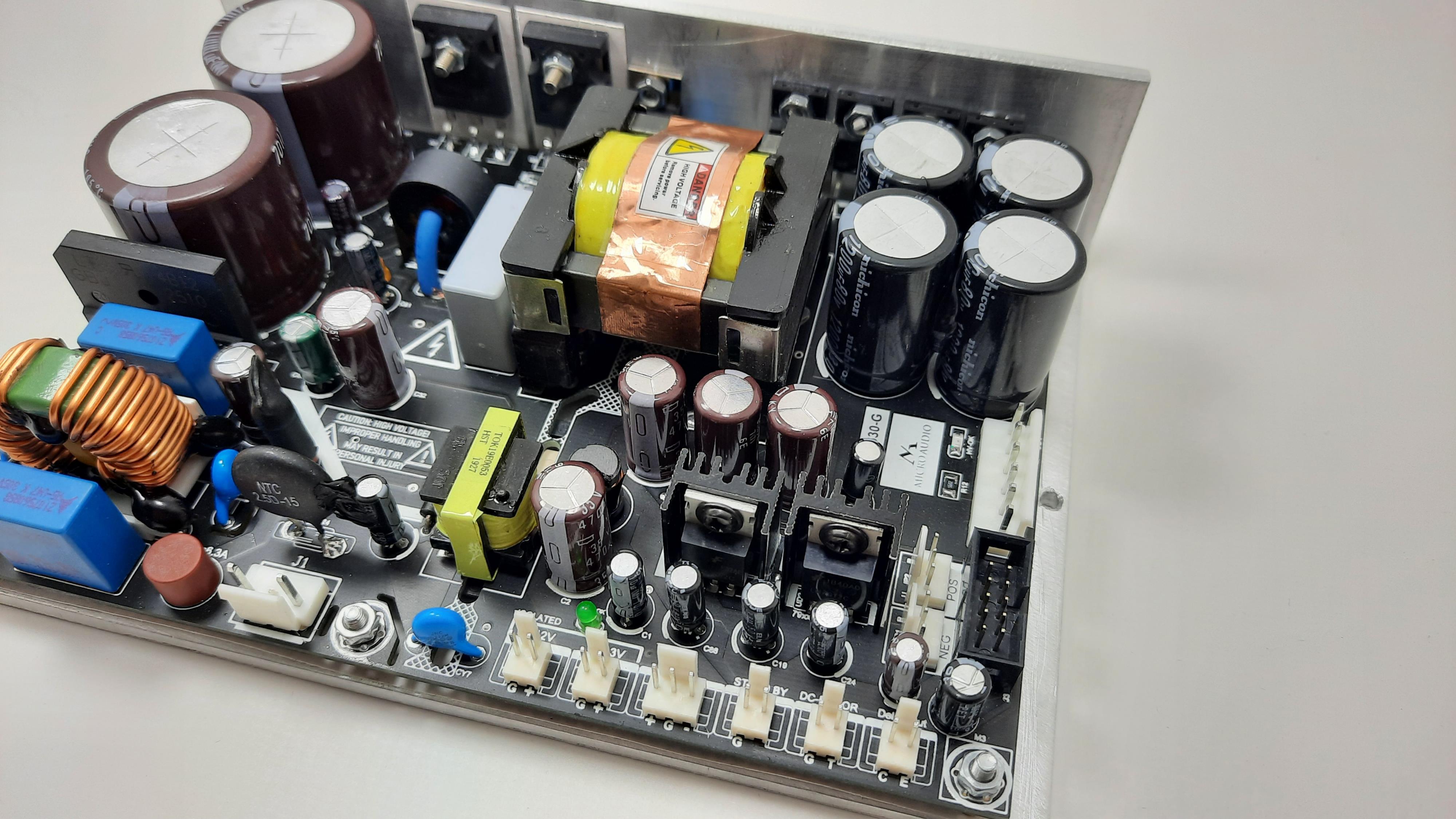

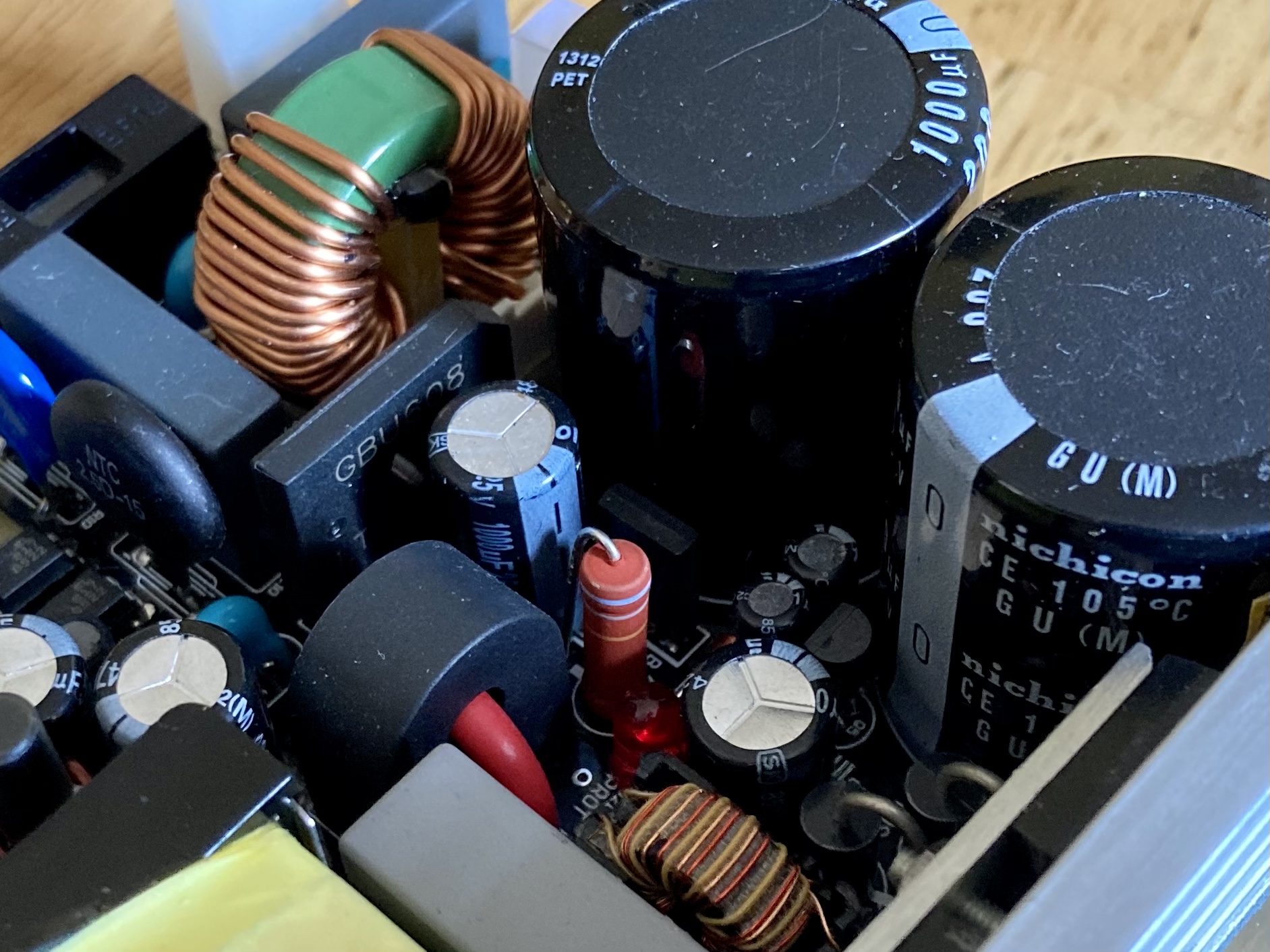

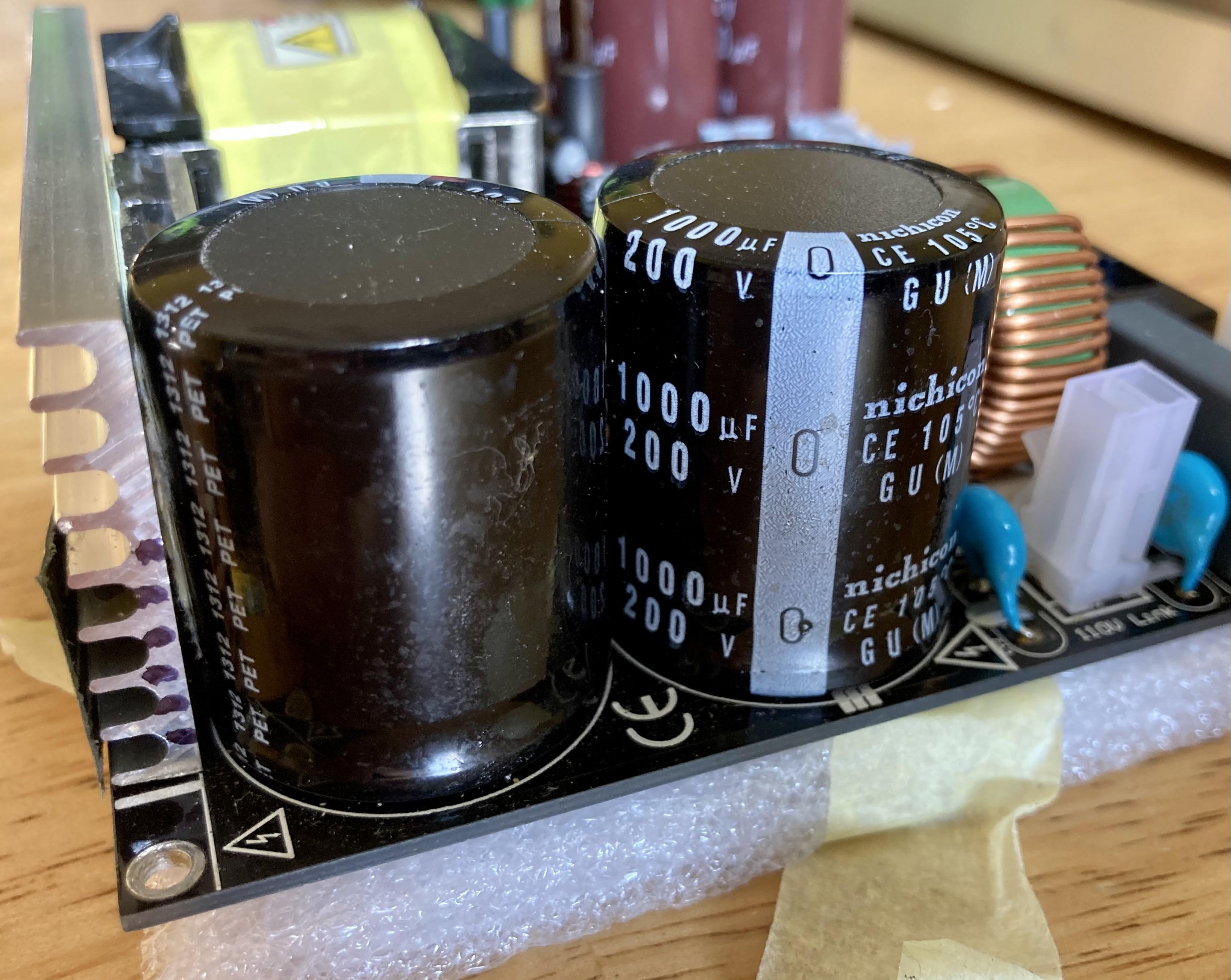

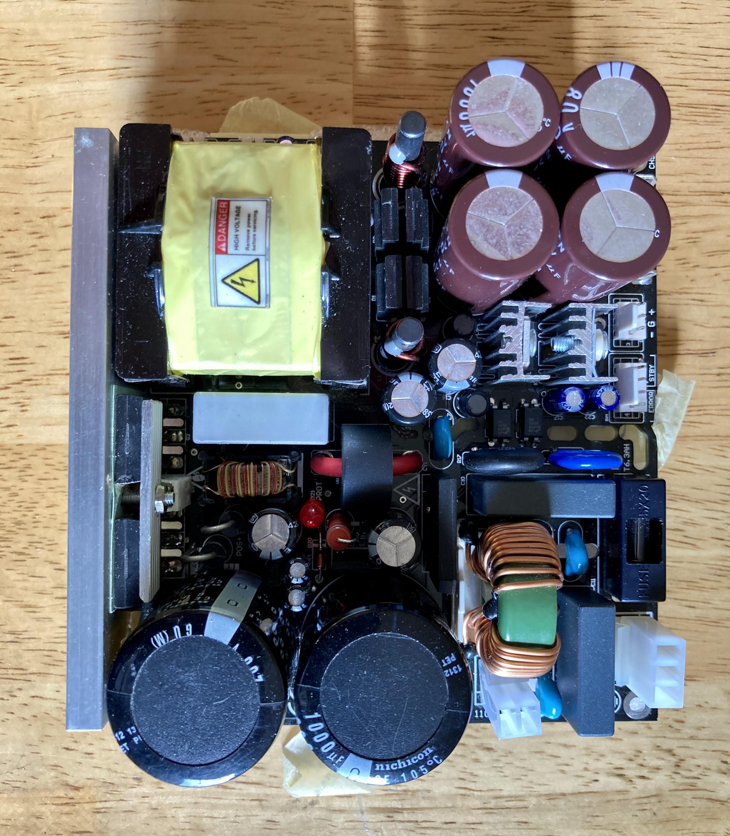

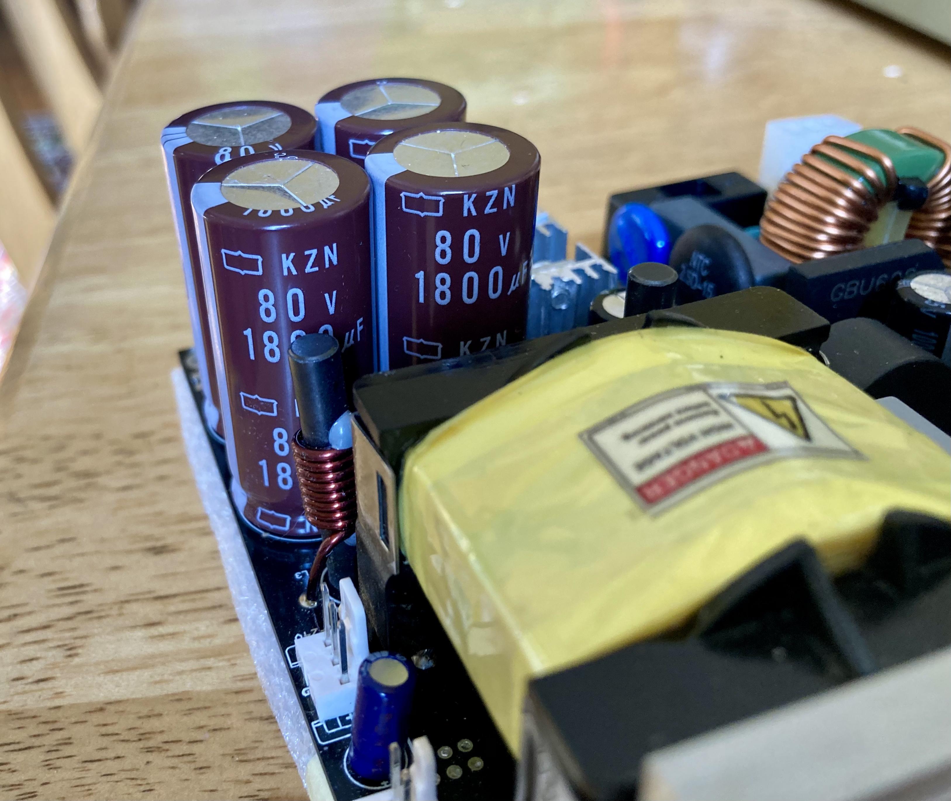

Attached are pics of the second identical unit I have. Further questions on its design, limitations, etc. should be directed to Cresnet. Audio SMPS units for sale
I was informed previously that this particular model should not have capacitance after the output exceeding 4700uF.

Perhaps Van can tell us the value of the intermediate bus capacitor and how accessible it might be for paralleling an external one to it. At the expense of larger inrush current, it might be preferable to augment that one so that very large capacitance on the load side does not interfere with start-up behavior of the SMPS. Just speculating ... As an example, a fair question is "how does the SMPS behave if we increase the secondary capacitance on each rail to 20,000 or 30,000 uF?
Bob
SMPS600 cannot tolerate more than 4700uF as TOTAL per rail of extra capacitance.
However, the SMPS630-G can take up to 30000uF per rail, and the SMPS500-CLA for class-A amplifiers takes up 75000uF per rail.
Adding extra capacitors at the output will decrease the ripple dramatically.
Hope that helps
