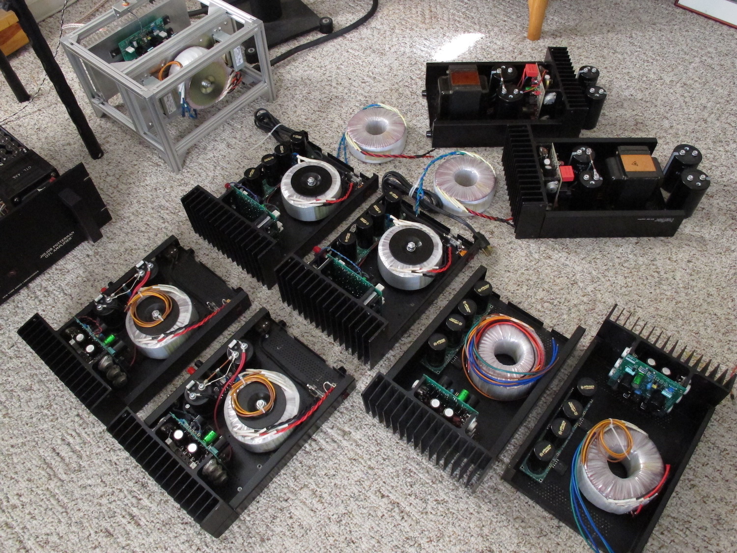

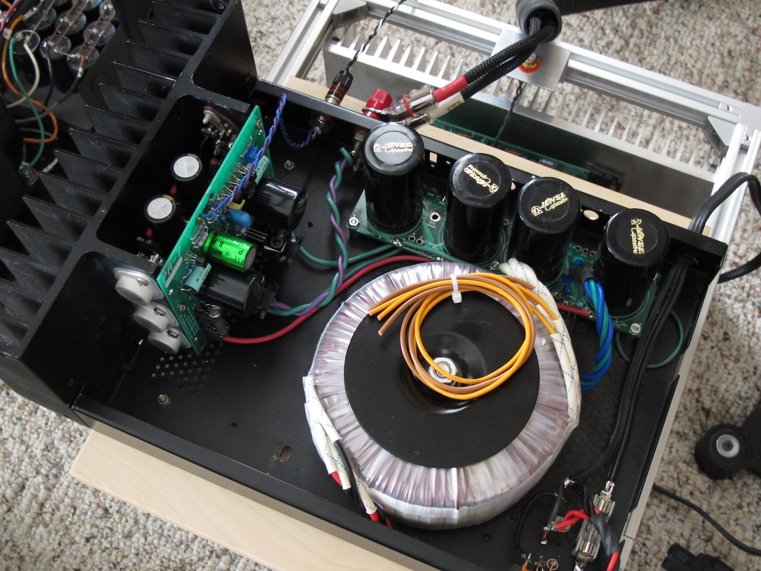

While repurposing a bunch of parts, I was being tormented by my mind and imagination. When arranging parts... chassis, transformers, capacitors, capacitor banks, wiring harnesses, driver PCB, power modules and heatsinks. A comprehensive array of things lay before me.
My task to think of [sensible, LOLS] linear approaches to building, sort of in tiers... price, power ranges, operating voltage ranges... overall complexity. Things I am building for myself to keep, some strictly to experiment and model ideas... a handful to sell to close friends, who track and follow closely what I do.
I am also trying not to be afraid of trying some far reaching things, many I have only endlessly pondered... ~ what ifs ~
Laugh if you will, this amp is 80% done... is be(coming) something.
I will be a BIG AMP KILLER. Stay tuned...

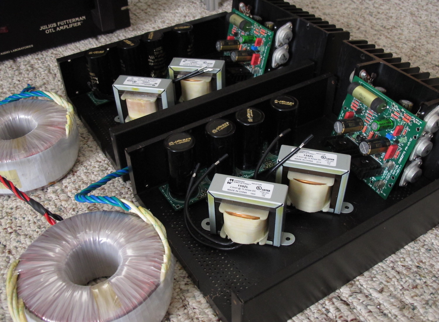

The essence of my P-230 mono amp concept is one of experimenting and trying things. Frankly, they were never meant to be permanent, it was not good to "become attached" to particular builds... conversely it is always good to know when the particular piece of equipment is JUST RIGHT, should be left alone, from further work.
I have 4 chassis's deemed as P-230 monos (not as bridged amps!) And now add to that, the top covers... 8 possible amp builds. The amp(s) with Mundorf MLytic HC, are hard to equal... there is something very special about their sound. For now, the 3 mono amps that have the Mundorf HCs are my standing reference... I am working to "EQUAL" them. The principle negative to Mundorf LOCOs, they are expensive, huge and a challenge to stuff into a box.
I had 4 banks of caps (8 100v - 8 80v) using the Jensen 4-pole 100v and combined with a 58v / 600va toroid which I combined with PA-7 / Exicon (singles) on an open chassis for maximum dissipation. These amps are remarkable. and should be. using good parts.
Image 2 Version(s) 2 - 3 - 4 Who really knows??
(the other bank of Jensens) which I am planning to eventually build a CLC supply. I have laid out the chassis pan(s), where I can do it in stages [to listen and make notes] I eventually can "move the toroid below" = get all of the AC power out of the box...
The Jensen 4-pole caps that have been a focal point in upgrade path over the years, with the cessation of production... it has been necessary to look at every option. These Slim cap(s) profile makes for easy (easier) placement in builds. The PS-200 P/S board also has many possible uses... including building an CRC or CLC is very easy... OR separate front end / and output stage supplies.

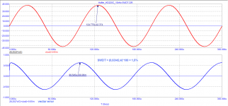

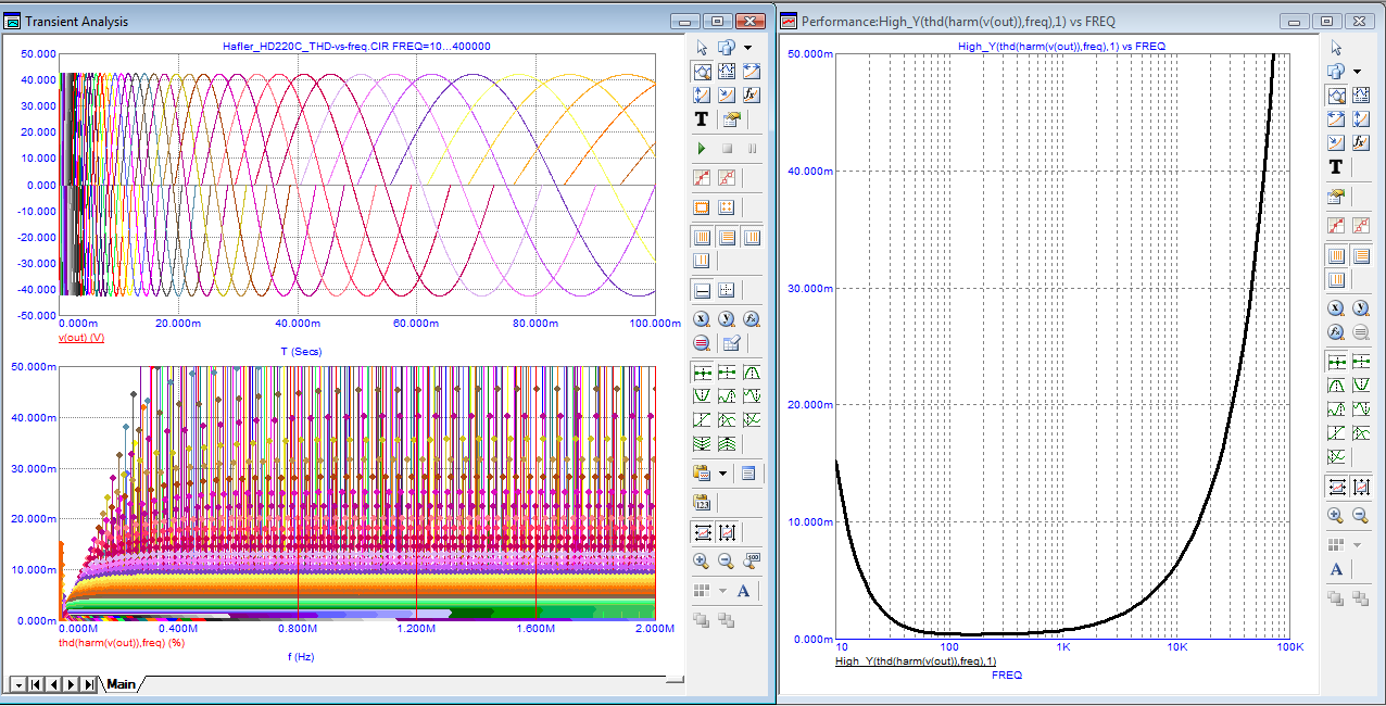

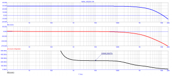

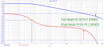

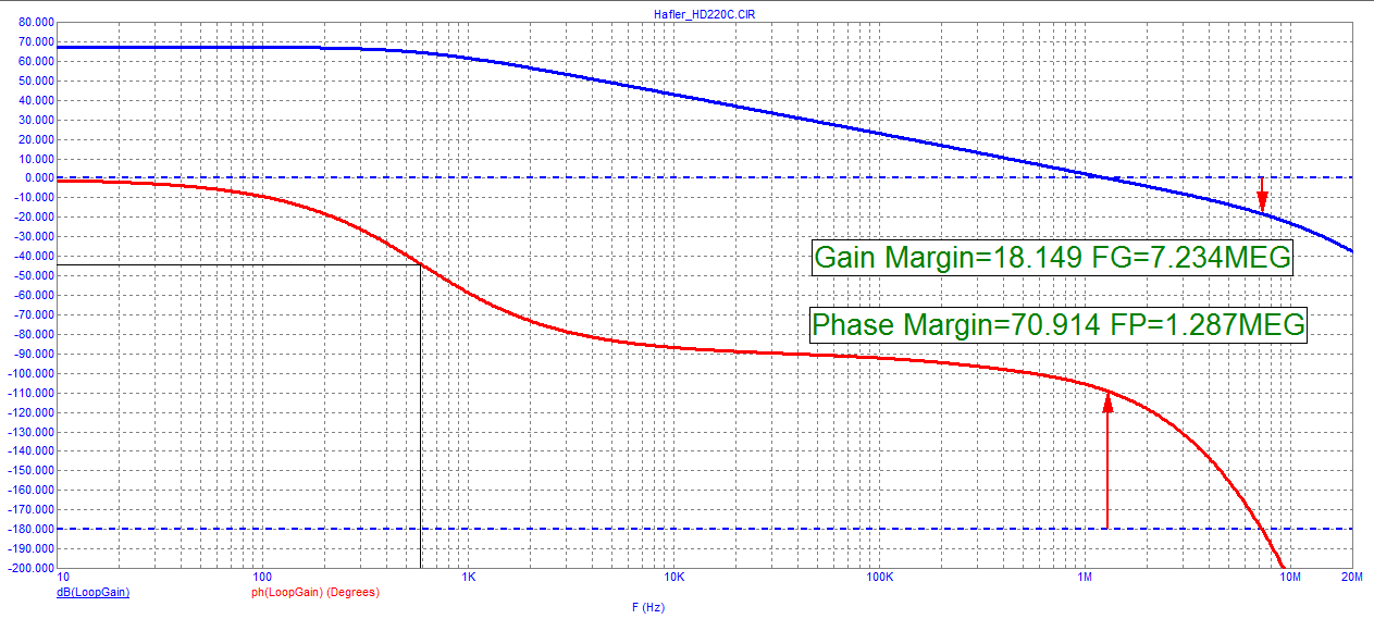

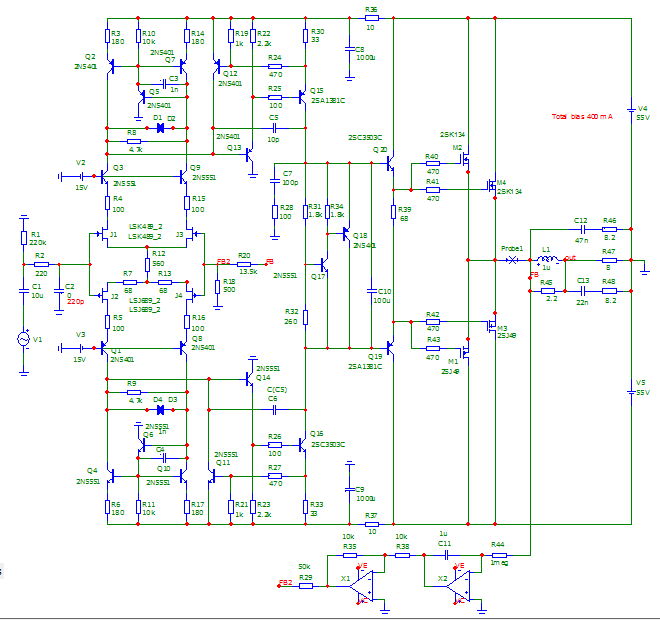

Typed Amp Model Hafler HD-220C
removed the Bode diagram and loop gain without capacitor C2

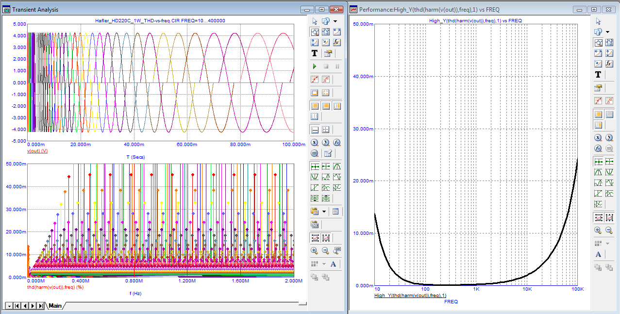

measured the dependence of THD on frequency at 1 W and 40 V (peak) at a load of 8 ohms (4-period)

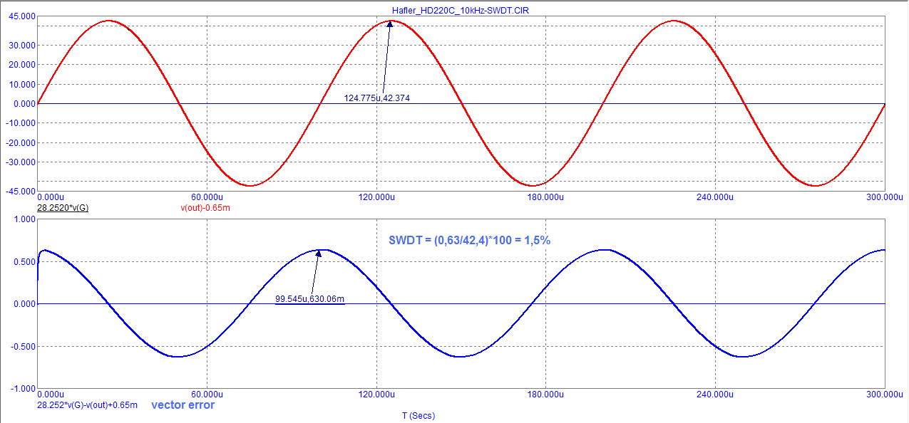

did the SWDT Haffler test (amplifier fails the test)

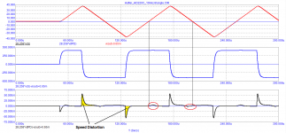

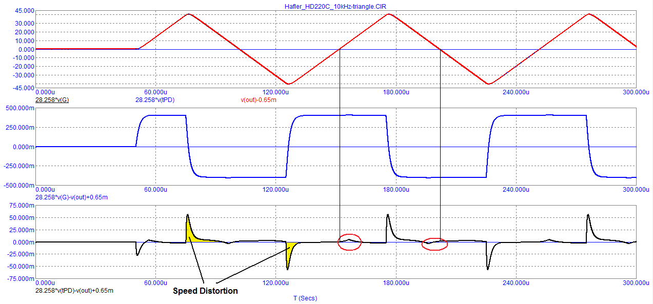

measured speed distortion, they are very large! 0.14%

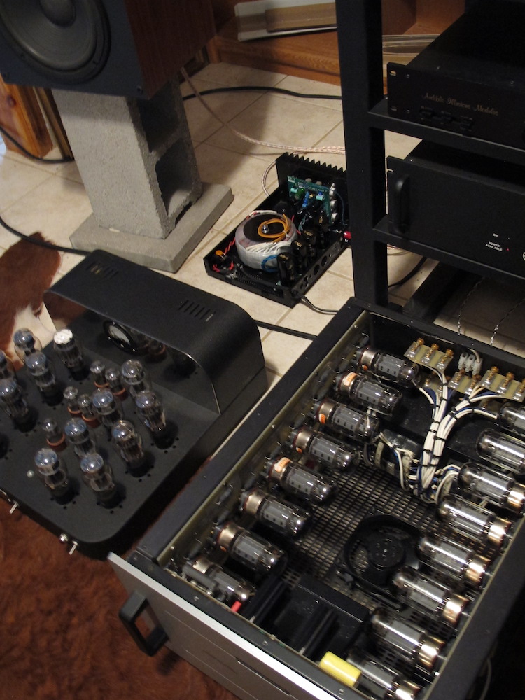

Playing alongside the .really big. dogs ;
It is remarkable that these "vintage" Half'ler / Lateral MOSFET based amps are "at home" with other very lofty BEHEMOTH power amps, vacuum tubes or solid state. I liked the true scale of this image, 8 little amps would fit into the VT200 chassis. It is not a simple, camera lens... perspective sort of thing.
I have "taken heat" for devoting so much time over many years to working with "these old amps", some question why. Personally, for me finessing a design or circuit is a challenge and at a point, even surpassing aspects of much favored performance attributes of the most noteworthy gear, the reward and lesson for the effort. A close friend (after a few listening sessions) quit bringing his Spectral amp over. Up to a point some people do not tend to take serious DIY, or consider approaches taken to equal the most expensive gear that money can buy, or that they can afford.
~ So few people outside of "our group" of dedicated DIY builders ~ really grasp how great these amps are [or can be] my friend with Spectral gear honestly is [indirectly] snooty at times. He will not accept it. **BTW, I love Spectral, the sound, the rich legacy... and would love ~ to be able to afford ~ an all Spectral system. I digress, but .am not. talking down this remarkable company, or their products.
My standing favorite vacuum tube gear is Atma-Sphere (over the past 25 years) serving as a reference in my home. The vintage Half'lers have been my daily drivers for nearly 40 years... and they keep getting better. Harmonically = timbrelly, a well-built "tuned and voiced" amp can indeed share the sound of thermionic gear. Many would/will/do argue this. I own both, what do I care??
I especially like this time of year (with cooler weather) in a ~60 degree basement/shop with tile floors, all amps run cool... I can [reasonably] raise the bias up without concerns of overheating. Time (is the season) to fire up the vacuum tube gear. I have not at this point, A - B'd the current build amps shown, most of the Exicon amps are still burning in... and getting better.
~ KEEP UP THE VALIANT EFFORT Y'ALL ~

Hi petr,
Are all of these graphs from simulation, or have you build and measured the DH-220C?
What is your criteria for an amplifier failing the Hafler SWDT (straight wire with gain)?
What is "speed distortion" and how did you measure it?
Bob
