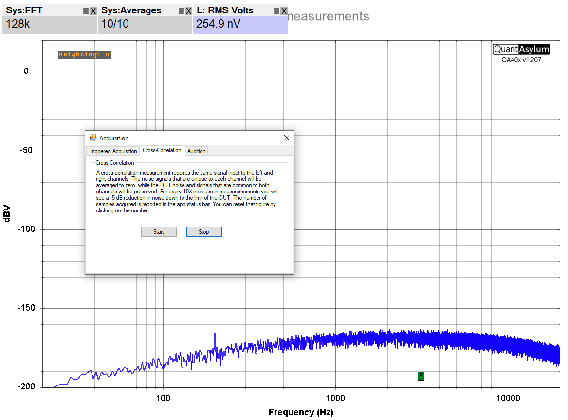

It's the D/A (gen side) in the QA403 that is limiting the ultimate performance of the QA403, not the A/D.
Have you enabled cross-correlation (same sig into L+R) for single channel noise measurements yet? (right click the run tab and enable it). Prepare to be amazed.

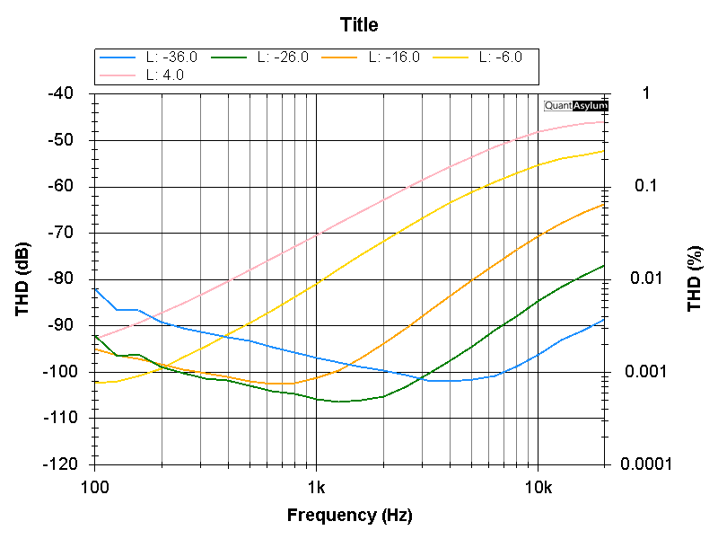

Phew. That was a lot of reading, 134 pages. I wanted to read through them before posting. Anyways, I picked up a stock DH-220 with PC-19B boards. I have adjusted the bias and output offset and did some rewiring that included taking the fuse out of the feedback path and installing some hum reducing resistors from point 2 to point 7 on the PCB . The PC-19B does not have C23 between points 2 & 7 like the PC-19C has. I have changed to isolated RCA inputs and use shielded twisted pair from the RCA connection to points 1 & 2 on the PCB. On a side note, the cable from the back of the RCA jack to the PCB is very sensitive to placement. 180 Hz hum with no signal present can be over 10 dB higher if the cable is near the chassis.
My distortion using the QA403 is much higher than the specifications at high frequencies. This is true of the unmodified DH-220 as well. I also have a couple of Sonance amps with much higher distortion than specifications also at high frequencies. Were the original specification done at some magical settings? The original specification at 115W into 8 ohms is 0.0025% at 1 kHz and 0.012% at 20 kHz. I'm seeing distortion levels over 10x these numbers.
On the QA403, I use a 192k sampling rate, 256k FFT, THD frequency from 90 to 80k Hz. I use differential inputs to the QA403 from the speaker binding posts on the amplifier and a short single ended shielded cable from the output from the QA403 to the amplifier. I also connect the amplifier chassis ground to the shield of the USB cable as this makes a huge reduction of high frequency noise and 60 Hz and all it's evil harmonics. I use a non-inductive 8 ohm load.

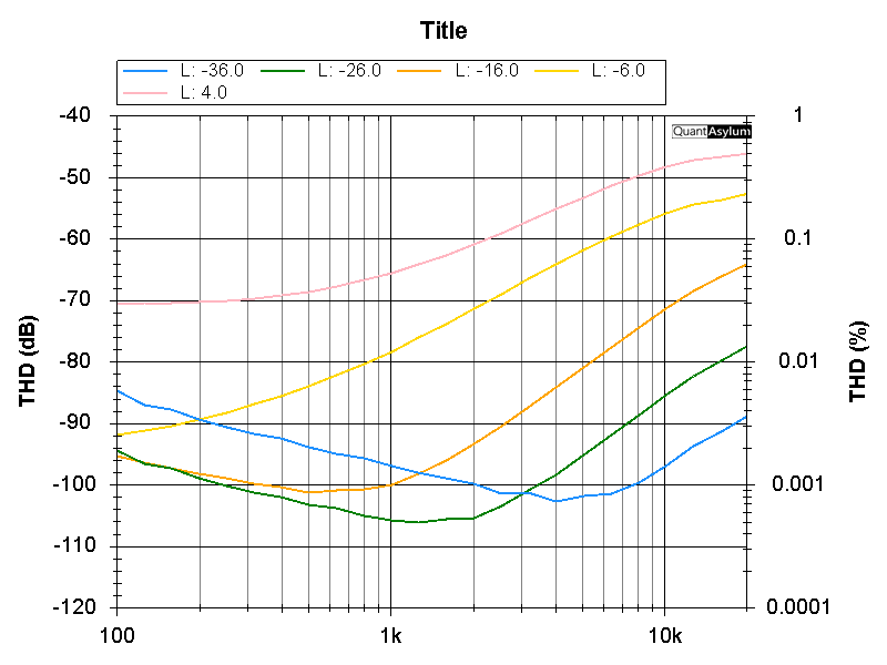

Here is the distortion of the right channel of my DH-220 with the fuse jumpered at the back of the fuse holder. This was taken right after running the same test with the fuse in the circuit (see below).
Here is the distortion of my DH-220 with a 5A fuse. This was taken after running a couple of other long tests, so it was all warmed up.
As you can see, the distortion with the fuse is much higher than with it jumpered. This mainly occurs at the lower frequencies and higher signal levels. I am going to rewire the output so the fuse is back in the negative feedback loop. +4 dB gives 132 watts of output into my 8 Ohm load.
My question is, is the high frequency distortion typical of amplifiers even it the specifications say it is supposed to be low? i.e. they are either lying or distorting the truth (distorting the distortion).

Distortion is always higher at high frequencies. There are good reasons for this, so no worries.

Putting the speaker fuse inside the global feedback loop is usually a good idea. The fuse wire inside the fuse is usually designed to exhibit a fairly high temperature coefficient to enable the fuse to blow as desired. This leads to the distortion it can cause at low frequencies, since its resistance is changing with signal current when enough time elapses over a cycle of the signal. For some amplifiers, it can be a concern that when the fuse opens and is in the feedback loop, the amplifier goes open loop with very large open-loop signal excursions, even with a small signal or no signal at all. This situation can be undesirable for some amplifiers, and might conceivably cause some damage. It is possible to design circuitry that essentially keeps the loop closed to some extent when the fuse opens. This is addressed in my power amplifier book. BTW, the same type of issues can be in play when there is an output mute or protection relay and one includes it in the global feedback loop to reduce distortion from the relay.
