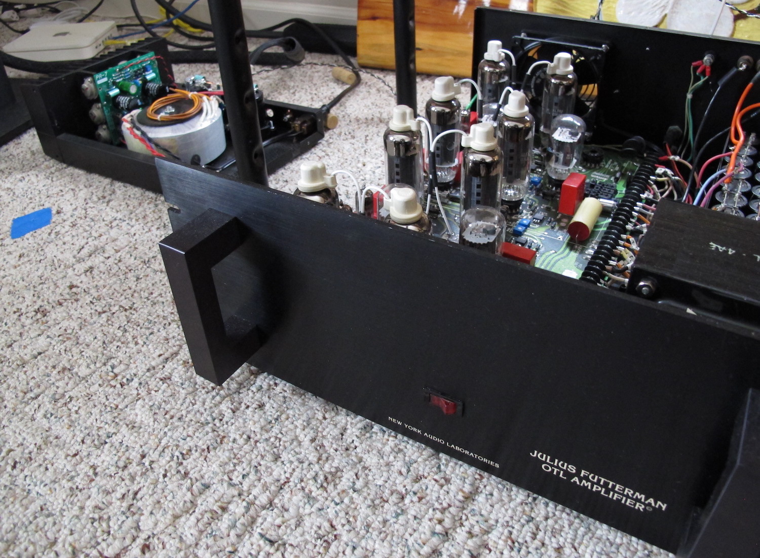

Image is of the P230 mono side by side the *classic* Futterman OTL-4 (with brand new, hand sorted, very tightly matched tubes, input to output) It does not get any better than this... My home made P230 amp is truly *that spectacular* in a side by side direct comparison... Most "inexperienced" listeners and audiophiles would not be able to hear the subtle differences.
  • P230 mono : OTL4.jpeg

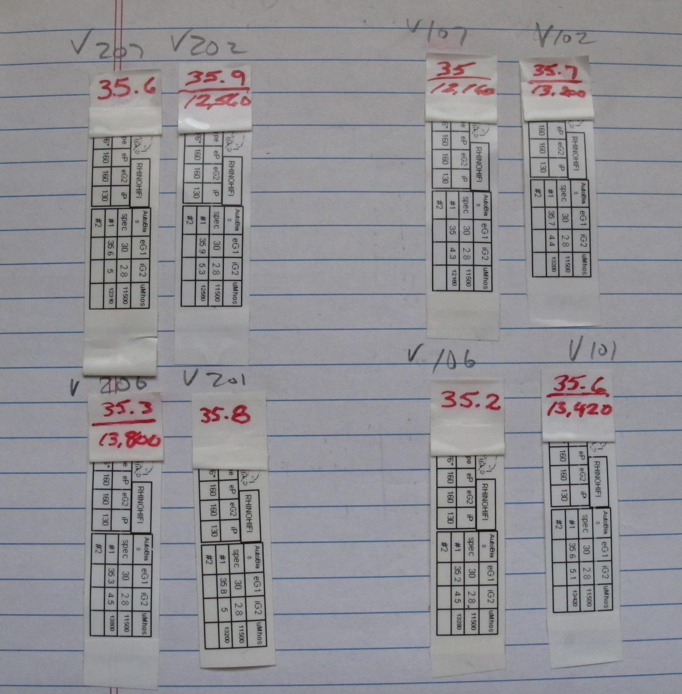

  • Hand picked : sorted 6LF6.jpg

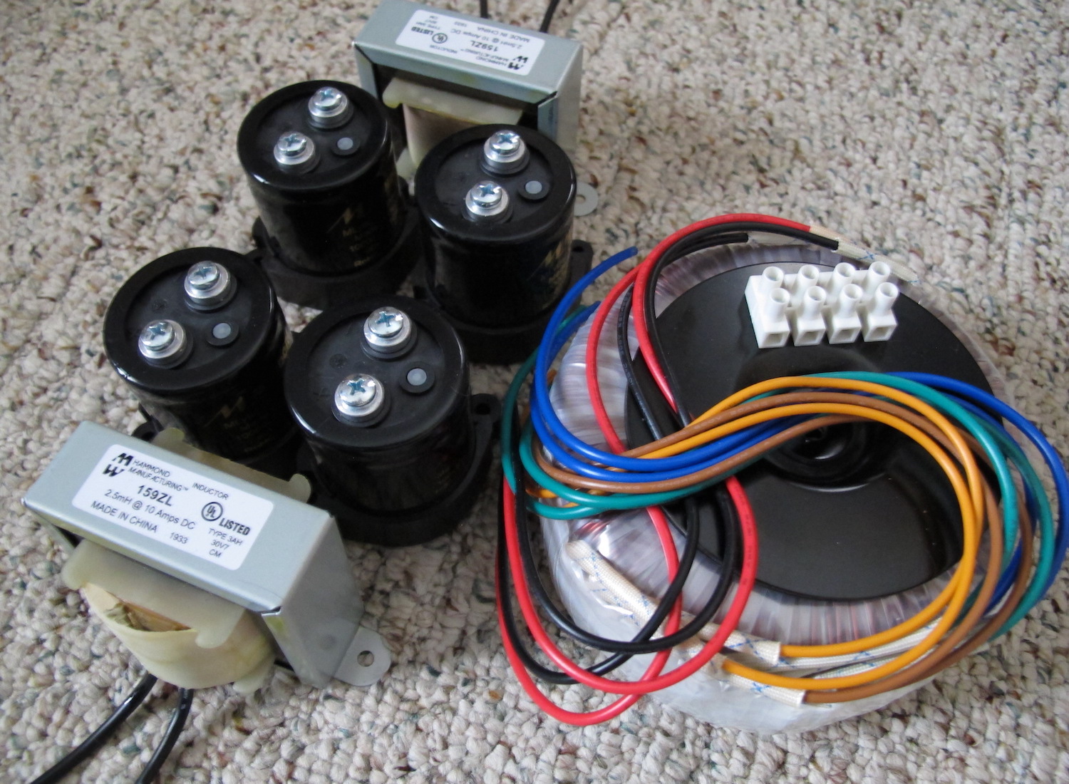

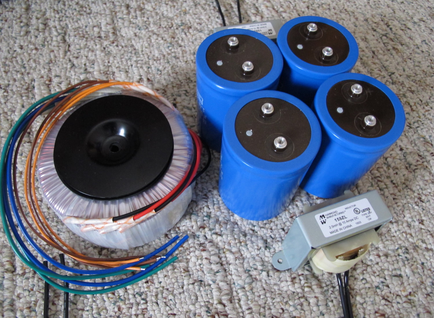

Modeling CLC power supply options for P230 mono
I am still gathering parts to approach the (long held) ideas of nth degreeing the (too often overlooked) heart of the amp... it is vital to update power supplies, even ones like mine... that are already ~ w a y ~ past the stock power supply so common in many vintage Hafler amps...
Cheap, old, original, vintage caps are like worn out springs with no bounce.
They should be replaced, ~ and bypassed ~ before doing .any. PCB work.
My short rant... it is cheap and easy work... capacitors have come
such a long way in the past 40 years... LOLS.

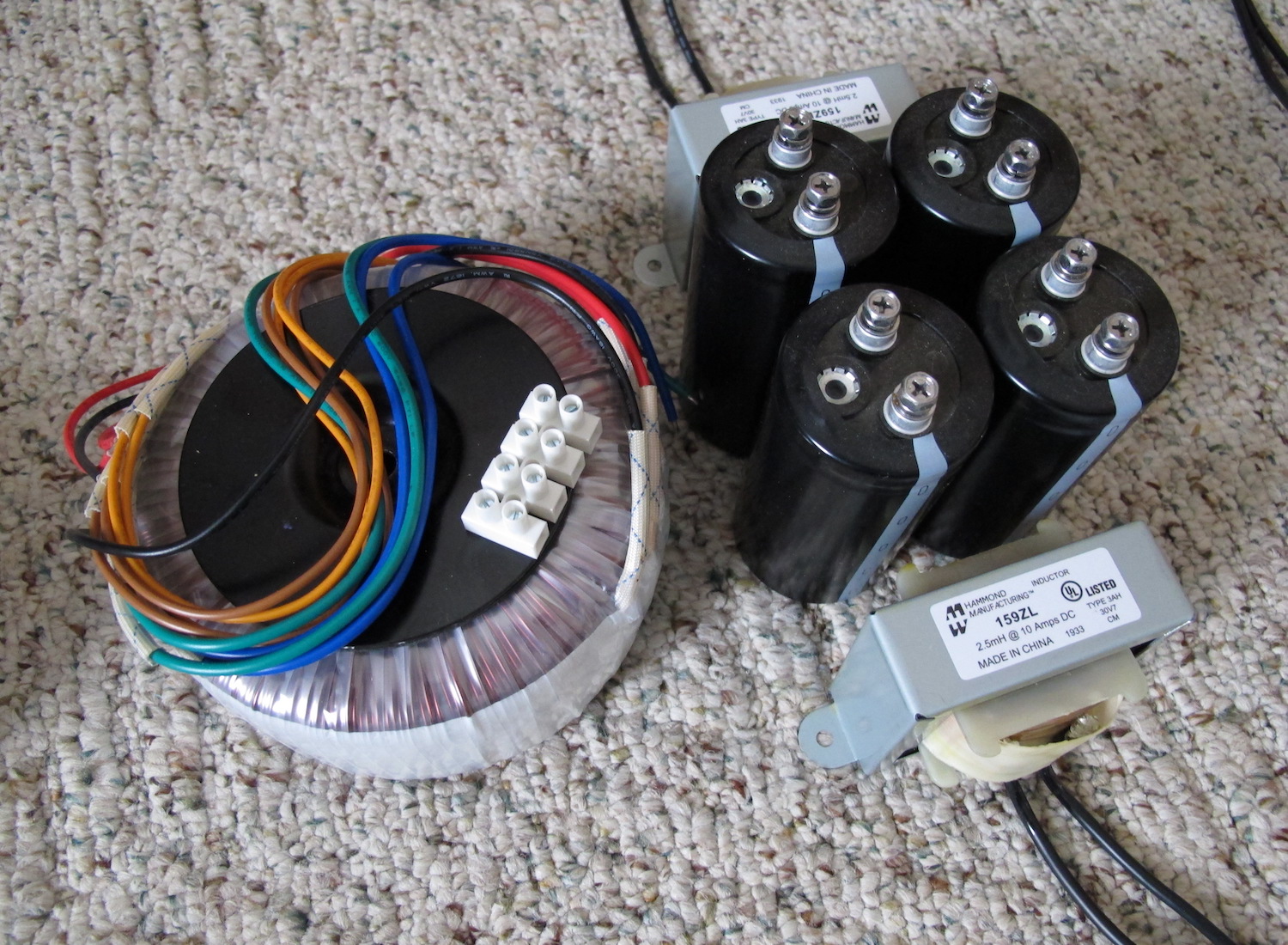

I (have on hand) plan on using a pair of 625va / 45v and 1000va / 45v, I want to hear the difference (if any) with effectively doubling and tripling the power transformers (over stock) and I will also try the CLC networks for scale... Every single improvement that I have made in the power supply has advanced the musical threshold ...greatly... I have to try it...
The very best I have heard are the $$$ expensive Mundorf MLytic HC (loco) caps, which have redefined the level of performance beyond the Nichicon LNR / LNT, Nippon Chemi-Con and even (discontinued) $$$ Jensen 4-pole caps, all of which that I have lived with for ~many years.
I remember experiencing the ($16K) Cello Encore amps back in the early 90's driving my Quad ESL-63s... It was said to have used a Pi filter network in the P/S. It was so smooth like butter... unlike any SS amps of the day... when compared to my Futterman OTL3s... very un-solid state like... it made a real lasting and lingering impression on me.

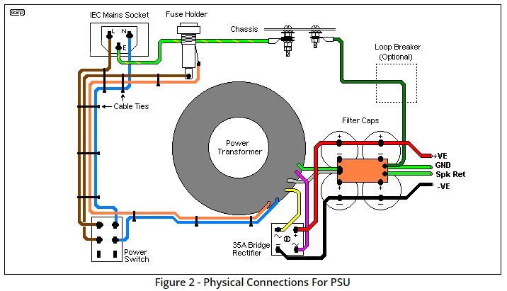

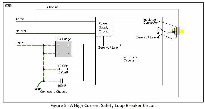

I am still gathering parts for my DH200C amp. This might take months, so I keep myself motivated by reading earlier posts like the one quoted below... I would like to make my build safer by adding a 3-pronged IEC connector (with fuse) to the chassis. And wanted to ask if there are any considerations I'm missing to establish a solid grounding scheme...Following Rod Elliot's diagrams attached.
1) Run ground prong from IEC plug to Chassis directly.
3) Add a Safety Loop Breaker from Chassis Earth to all other ground connections in Power Supply 0-volt point. (between caps + and -)
3) Run new wires from Power Supply board (Musical Concepts PS-200A) to new DH200C boards.
4) Replace all input and speaker connections with new copper units (isolated from chassis).
5) Are there additional steps required to segregate signal and chassis ground?
Thanks! - Six.
You have to stick to a selected grounding scheme. The Hafler as designed and constructed used the chassis as part of the grounding scheme. It thus mixed signal and chassis ground. Thus, unless you are going to completely rewire the amp, you have to keep the decoupling caps grounded to chassis.
What this means is that the typical position for the ground loop breaker is not going to work. You have to put it between the ground wire where it comes out of the AC wire, and the chassis ground. That may violate some legal requirements and may not be safe because if the ground loop goes open on a fault, then there is no safety ground AT ALL.
I guess the bottom line is, unless you are going through the trouble of rewiring the entire amp and carefully segregating signal and PS grounds from safety/chassis grounds, the ground loop breaker may not be a good thing to use. Instead, if you need to break a verified ground loop, use a high quality line input transformer like those from Jensen or Cinemag.
