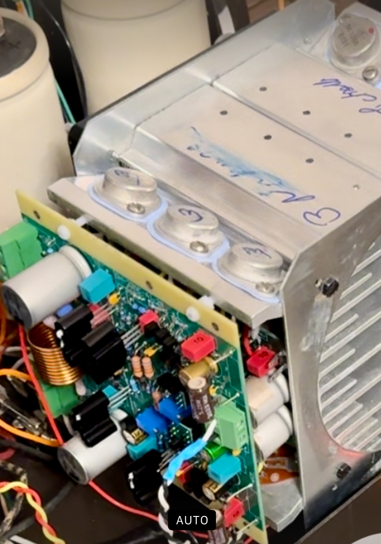

I am looking at using the DH200C circuit boards in a Dynaco Stereo 400 rebuild. The mechanical fit looks tight but ok. I have 2 concerns I would appreciate comments on:
1. For one channel, the wiring length from the AFE and OPS for one channel will be rather long, estimate is 12 inches (300 mm), then another 3 inches to transistors.
2. The Dynaco heatsinks are prepared for 2 pair of output transistors. Is this enough for amplifier with +/-74 VDC rails? (I hope so, that is all the matched Exicon TO-3 transistors I have).

I took a quick look at that Dynaco design. It specifies two complementary pairs of 200w bjt output devices.
Single die exicons are rated at 125w and dual dies at 250w so dual die devices would be the preferred devices for that supply V imo.
As far as wiring length goes, it’s something that needs to be tested out for oscillations and stability.
No easy answer as far as a simple yes or no since you are deviating from the intended application of the original design.

Thank you for comments re. using DH200C in a Dynaco 400 rebuild. Using the dual die Exicon is a good recommendation, so I have gone ahead and ordered some. Profusion has very limited stock left on these.
I understand I am taking my chances with the new application. Closer inspection of the Dynaco shows the OPS may not fit - I may have to lay out a narrow OPS circuit board. Should be fun.
