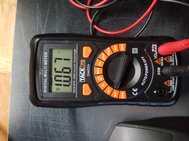

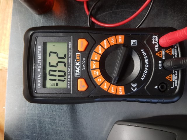

Btw... made a measurement with the LPF filter proposed by waltube.
at "rest" the mains stabilize around 10mv of DC, when i turn on the hair dryer on half-setting, the DC level raise to 1.05V, and if i flip the plug in the socket, the amount is the same, but flips the sign (-1.06v).

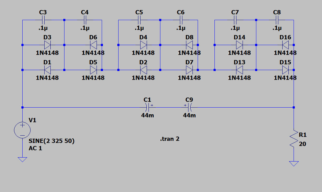

Just moments ago i have re-tested what happens after my dc-blocker (caps+diodebridge), and the DC is went down from 1.05v to 0.4v (... just one diode voltage drop).
So i guess is time to put some more diode's in series to each other and see what happens.
As last resort, i have seen that waltube has used 15mf caps in antiparallel without diode acros it... to what i understand, now, all the current "ripple's" in the capacitors, without any fast-passing trought the diode, but then, i guess it works with whatever dc-bias the mains has...
i will test both ways
I think we got it.
i have used two 22mf 63VDC capacitor back to back + a series with 3 x diode bridges in series.
something very like that
THAT
attached is the current version.
I have seen many other designs that has a resistor across the capacitors... what is its purpose ?

C1 and C2 should be back to back, not parallel. I recommend fuse, and closed grounded metal enclosure and think about placing on high side rather than neutral. (Yes operating at elevated voltage, but voltage across the components is the same. I am not comfortable with it in neutral, due to a concern about safety. )
Sure, indeed i have modified my previous post as i was worried that you understood that i followed that schematic "blindly".
please see the attached schematic.
And about Neutral/live... i guess that difficult to define a-priori. In Italy the sockets and plug are reversible... and, unless you take care to put all the system/house in "phase", there's no indication about the polarity.
