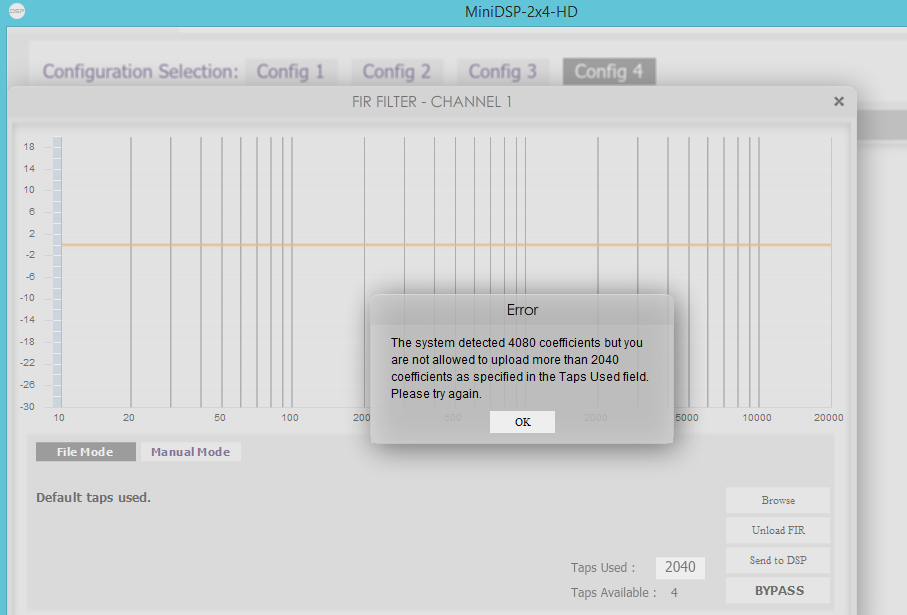

This image makes me think that there were 2040 taps allocated and loading the filter would take it to 4080. Which would make sense as the filter was 2040 samples (checked with Audacity). Maybe try to unload FIR to reset taps used and then load the filter.
I hope we get through the loading part so you can tell me if it sounds any good

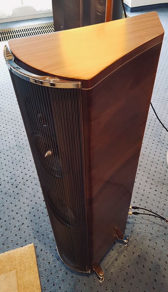

The shape is loosely inspired by Franco Serblin, but I wanted a more "aeroplane wing shape" to is since I'm a pilot (recreational)
Since shape is curved to begin with I also consider an angled front baffle so the line acousticly have toe-in while standing "straight".

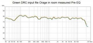

I have made Halair some new filters which I hope he will be able to load into the MiniDSP
It has been quite difficult to work it out without having the hardware to test myself
The limited number of taps and 96k fixed sample rate has presented an issue in making a good filter and I am pleased that the effort has been worthwhile for Halair so far
Based on my own efforts to make a psycho smoothed filter I thought I would make one based on Halair's measurements and try to make the overall filter closer in shape to one I would be able to make with more taps.
The filter I would make if taps were not an issue is quite detailed down to the low frequencies, with the tap limit it starts to deviate below 1K.
I have had some success at least on paper at combining PEQ and FIR to get the overall transfer curve I was aiming for.
I started with the psycho smoothed filter as a base, I convolved that with the PreEQ that the measurements were based on to allow DRC to be in a good range for filter generation. That is the control.
In REW I divided the control filter by the one that was made for the MiniDSP to create a difference file.
I inverted the difference file (1/A). This is the EQ curve I needed to generate.
I used the auto EQ with target level set to 0dB and target type to none. I limited the match range to best fit the biggest issues as there are limited PEQ's to play with. Matched to target and checked that the filters matched the shape which they did. Export those to a biquad file and make an impulse of them to convolve with the original low tap filter as a check.
On paper it works. Excess phase correction below 1k is almost none existent so far. That will need a new strategy.

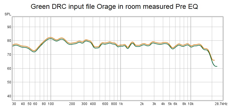

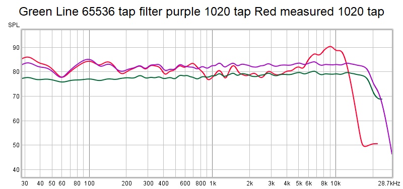

Something is going wrong in the translation from DRC filter to MiniDSP output
I was starting to think maybe I had used the wrong base measurement so I double checked, no very good match, this is the difference between the measured pre EQ'd response Halir sent vs the DRC input pcm file. They are the same.
Here is a comparison between what I am aiming for with the correction in the green line. Pretty flat with a very slight rise. Vs what I can get from 1020 taps in purple Vs what the MiniDSP is putting out when measured in room. Up to 600Hz is near enough then it all goes wrong Hmmm
I suspect that the psycho filter is not doing what was intended either which should have been another version of a straight line with more dips in it.
For now I have put aside the psycho filters in my own system as they have not been able to outperform the good old trusty one which is what I was trying to give to Halair here in these graphs.

the miniDSP2x4HD have a total of 4096 taps available, freely distributable over the 4 output channels. However minimum 6 taps are used so the total available for 2 outputs are 4084. For some reason the 2040tap attempts have been unable to load as miniDSP report back 4080taps and insufficient space available.
