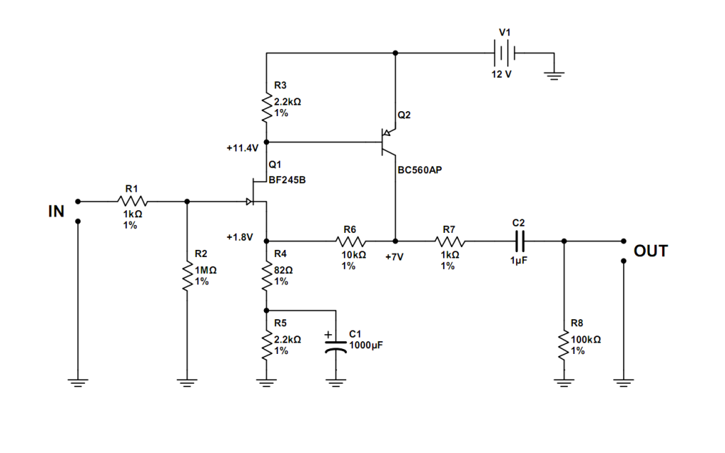

As my first microphone preamplifier project at first i selected the one from Scott Hampton in regard to the tapeop article.
Then i stumbled on this thread so instead decided to take on the second schematic from adason post because that one was even more simple so i could focus on quality parts instead.
well, after some time trying to troubleshoot myself; am having some annoying problems. It seems i cannot get 7V on the collector of BC560C (i keep getting 0.612V) so in turn i cannot get requiered 1.8V on the source of BF245B (here i am seeing 0.535V).

...well, .... It seems i cannot get 7V on the collector of BC560C (i keep getting 0.612V) so in turn i cannot get requiered 1.8V on the source of BF245B (here i am seeing 0.535V).

It may get little reply because it is not clear *what* you are building. Not the Hampton? Adason posted a small image in reply #22... that one, not that one?
You mention BC560; I don't think either Hampton or Adason #22 use a '560.
Adason also posted a link to an external blog, and that does have a '560.
That one?

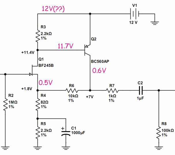

The "11.4V" at Q2 Base is very specific. Actually it MUST be 0.6V down from the "+12V" line (whatever it really is). Your readings suggest Q2 is "off", which means Q1 is also "off", which means a bad connection, wrong value somewhere, or an unhappy pick of devices (maybe a mis-read of transistor pin-out).
Mark ALL the voltages, post the image or list, and maybe someone here can spot the error.

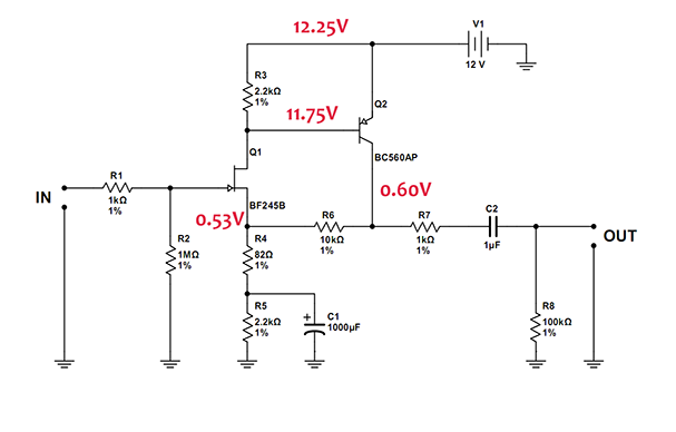

Here are my voltages.
Q2 is BC560B and so i read its pin-outs according to motorola datasheet.
Q1 is BF245B and i checked the pin-outs also according to the datasheet.
As PRR said, Q1 is nearly "off" (from the source voltage you measured, it's only flowing about 230 micro amps of source current).Here are my voltages.
Since Q1 is a depletion-mode JFET, it should not be off - this circuit relies on Q1 flowing more than enough current to turn on Q2, which is currently not happening.
(If Q1 were operating properly, Q2 would turn on, and "throttle down" Q1 until everything settled into proper balance.)

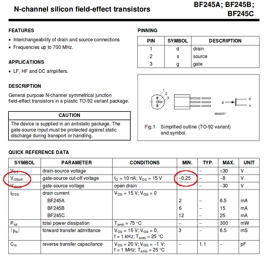

The question is, why is Q1 nearly off? I looked up the datasheet, and the magnitude of Vgs_off for the BF245 can be as small as 0.25 volts (see attached image.)
Although the particular JFET you happent to be using isn't quite this bad (we know Vgs_off is bigger than 0.53 V), the problem is now clear.
This particular JFET type (BF245) isn't, as PRR suggested, a "happy match" to the other component values in this particular circuit.
This is easily fixed, however. You need to either dial R5 down (try using a 4.7k trimpot rather than a fixed 2.2k resistor), or dial R3 up (again, use a 4.7k trimpot rather than a fixed 2.2k resistor here.)
In either case, tweak the trimpot until Q2 collector settles at a reasonable value, i.e. somewhere in the vicinity of 6 volts (half of the 12 volt supply voltage.)

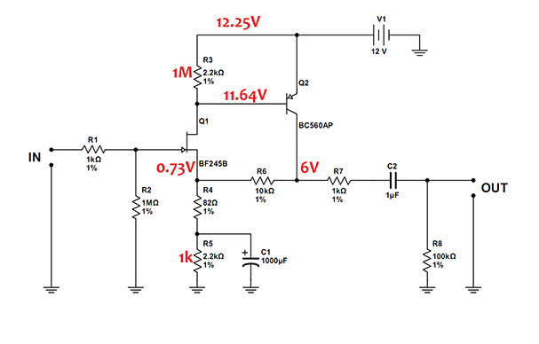

Thanks for the reply and explanation. I swapped R3 with a 1M trimmer which only gave me 4.33V on Q2 collector. I had to use a trimmer on R5 also and dialing that one down to 1k got me to 6V Q1 source. Will post my voltages in a couple of minutes.
The voltages look good, but I can't make any sense of the 1M resistor. You should have been able to get the 6V collector voltage with far, far, far less resistance than 1M. 😕Here are my new voltages
Did you by any chance measure that 1M trimpot before installing it, to see if it is actually 1M? (Don't bother measuring in-circuit, the base-emitter junction of Q2 will almost certainly make nonsense of any resistance measurement.)
At any rate, despite the mystery of the 1M pot, your circuit should work now, so happy days!

Yes i did measure all of trimpots before soldering them in R3 position (i have tried everything from 5k-1M). 1M measured on my multimeter 0.944 so it is 1Megaohm. It was also very strange to me that i needed that high resistance as opposed to the schematic and per your suggestion only to squeeze out 4.30V total.
During the trimpot swapping i did test the circuit and it was interesting to see how it reacted like a valve cathode bias would. At 1.5volt it was funcioning but the sound was so forward and dirty as hell and as i stepped up the voltage is started to get tight. Almost like when i bias my valve amplifier.

The problems all come from the fact that Q1 is very different from the originally specified 2N3819. The BF245 wants much less DC voltage between source and gate to turn itself off, and also flows much less current to start with.It was also very strange to me that i needed that high resistance
Reading through your newest results, I underestimated the effect of R6, which raises the voltage at the source of Q1. With a 2N3819 you'd have been fine, but with the BF245, that voltage is enough to turn off the BF245 completely when Q2 collector is at 6 V!
So that's why you ended up lowering R5 down to 1k. That reduced the DC voltage fed back to Q1 source from Q2 collector, and that in turn allowed Q1 to just barely start to flow the teeny-weeniest bit of current. So little current, that you had to increase R3 to a crazy 1 Meg to get Q2 to turn on properly.
So now your circuit is working, but Q1 is still almost completely shut down.
If you're happy with the way it's working now, no need to change anything. But if it's overloading too easily, or distorting more than you want, we can make more changes to get Q1 to flow a bit more current.
If you do decide to change things, I would try replacing R4 with 270 ohms, and R6 with 33k. These changes will keep the voltage gain about the same, but drop the DC voltage at Q2 source, and allow Q2 to flow a bit more current. That in turn should allow you to reduce R3 to a more reasonable value. R5 should still allow you to set Q2 for 6V on the collector.
