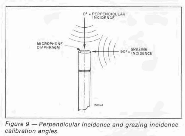

Again, when you use the ecm8000 make sure the sound is 90 degrees/grazing to the tip of the mic, see the diagram below. That mic is flat at 90 degrees, and hot in the treble at 0 degrees.
