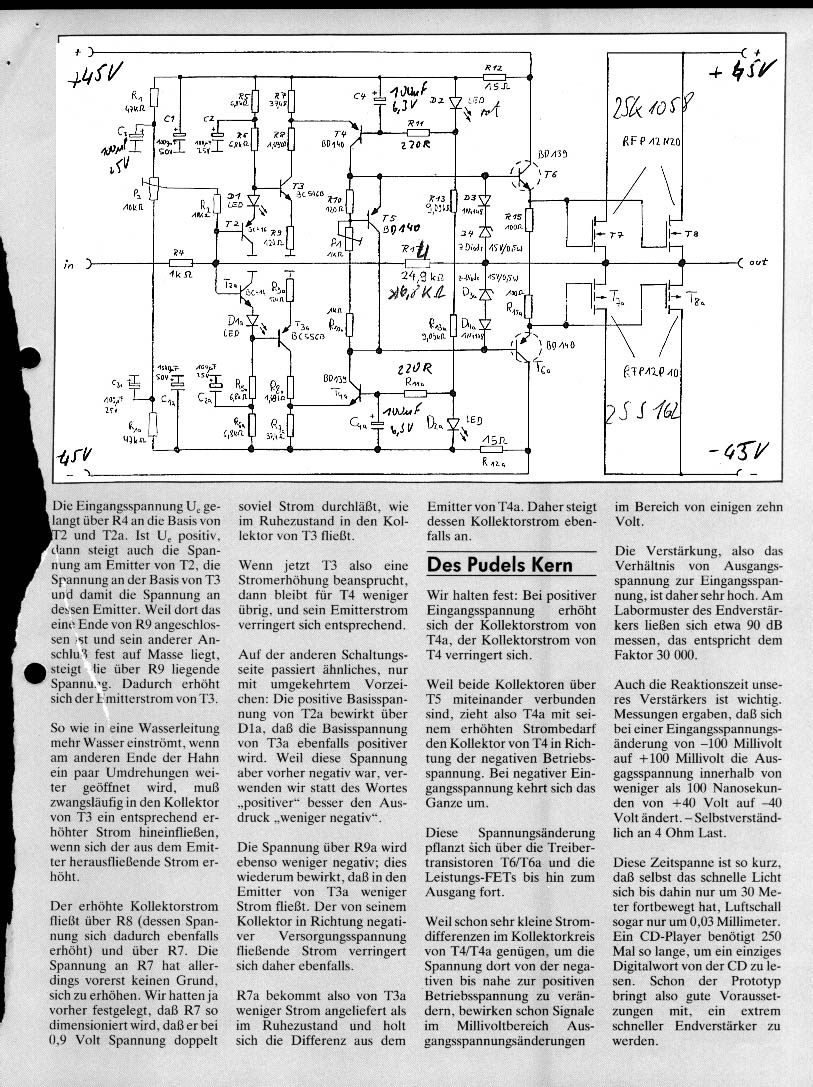

1987/1988 article series schematic included a 5534 input stage.(this page copy is from the web, not a xerox from my Stereoplay mags, me build with original RCA FETs)
Later commercial model upgrade included a switch to BB OPA627.
Take note that the commercial stuff did have source resistors.

Thank you for posting this schematic. I like this topology, because there is only one VAS stage in the signal path and thus no Cdom is necessary.1987/1988 article series schematic included a 5534 input stage.(this page copy is from the web, not a xerox from my Stereoplay mags, me build with original RCA FETs)
(Burmester gear has been copied as far back as the late 70s.)
http://www.diyaudio.com/forums/solid-state/42259-zero-feedback-impedance-amplifiers.html
The power amp with lowest possible active devices in the signal path !!!
I count two, which is twice the minimum.

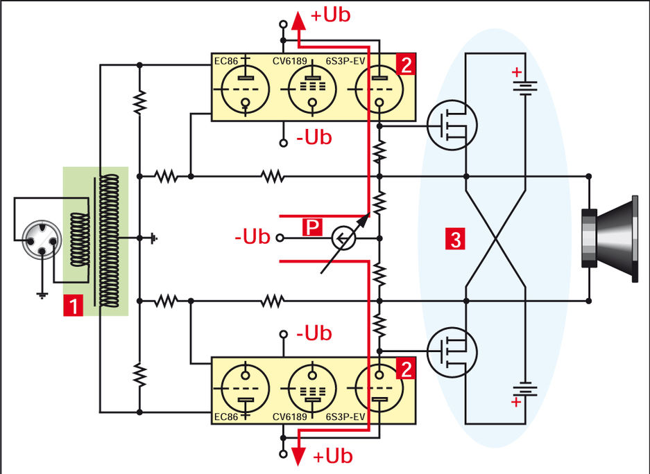

The Thorens Circlotron TEM 3200 is interesting. It is totally DC-coupled, has tubes in the driving stage for higher characteristic curve or gain and it has only one trimmer to set the operating point for the output transistors. The output transisors are power hexfets. They were tested in Stereoplay December 2005 I think. Here is the test of Stereoplay in german with an simplified schematic:
Thorens TEM 3200 - Stereoplay

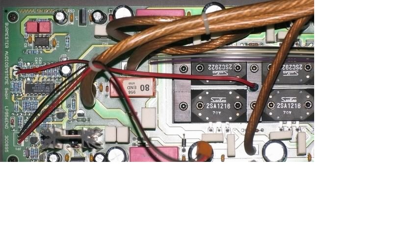

Burmester 909 Power Amp - Schematic wanted
Who can upload a schematic diagram of this amp?
