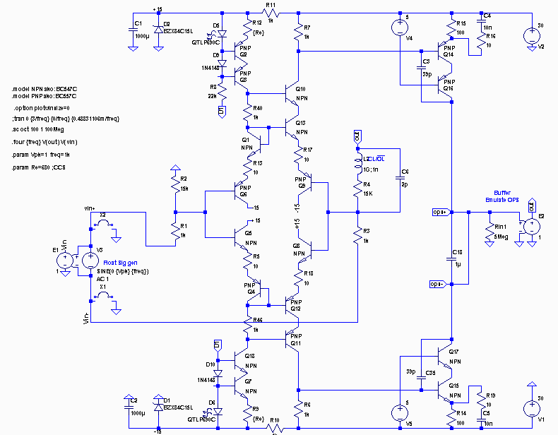

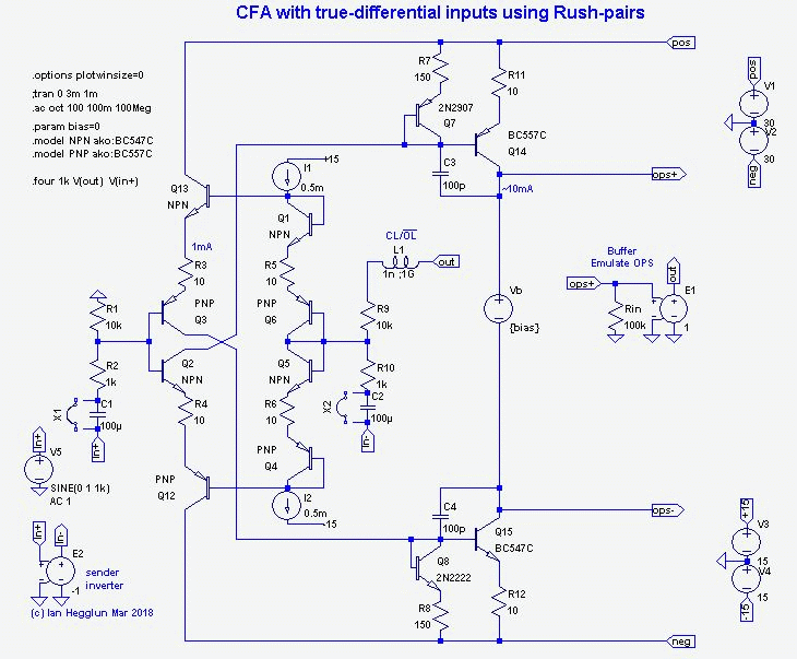

See attached.Hi Ian
That looks like fun, perhaps a bit optimistic with output transistors perfectly matched for BF and, less plausibly, for VAF.

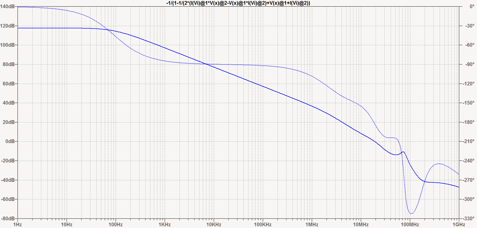

I am curious about the stability, the Tian probe placement in the thumbnail may not be fully informative.
What does the Return Ratio look like?

Perfectly matched transistors are used to see what causes the remaining distortions. Most of the distortion seems to be nonlinear loading of the VAS by the output stage. Adding buffering could reduce distortion. I haven't tried that yet.

Hi Bimo!
Did you miss Ian's outputstage? Probably the goal of this design is not in the input stage, and VAS,
connecting it to double EF, like your sch/sim showed, will not give the benefit.
You have lots of HF harmonics from switching, which are neglible in Ian's circuit.

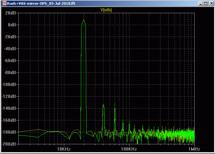

See attached...
...from Ian's web site and perhaps look again the earlier one you are referring to above for a comparison of their output voltage levels?
Like for like seem more or less similar at ~20+dB?
Cheers, ian

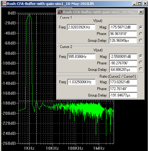

I am thinking about this one, 20kHz, 21Vpp

I was looking...
...>here< on Ians 'Foxtrot' page.
The link you made resolves to an FFT in post #12 which looks like ~1 Watt?
Where's that one from?
Cheers, ian

OK thanks...
... this is interesting.
It seems that your results which were produced under even more demanding conditions are somewhat better than Ian's own published data obtained at a lower output level?
I wonder what could account for that given the same circuit, components and loading etc?
Cheers, ian
Ian published it in the post I linked
I sent the results of sim the same circuit but with higher voltage output

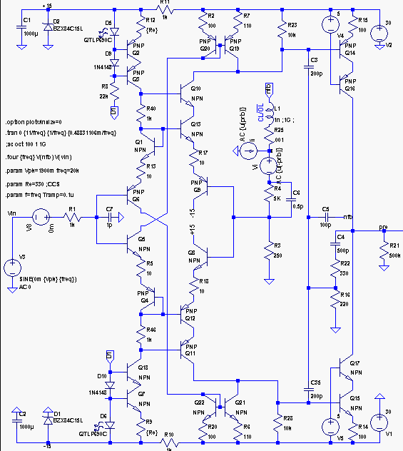

But the title of this thread is about input stage
May be I will change the output stage.

Thanks for the Tian plot, the probe is placed as shown in post #12?
I think this may be inaccurate since it doesn't capture the feedback from NFB via C5.
I don't know how much difference there will be in your particular circuit but I think it should be placed at NFB before it splits.

Sorry, I should have reverted to realistic Beta and VAS mismatch before posting.
Re C5 and Tian probe plots.
I haven't read the Tian paper(s) on his probe but after some thought I figure that C5 can be left as is in my circuit. My reasoning is that C5 alters the forward path transfer function (G), and it's effect will be accounted for as part of the combined feedback transfer function (1+G*H) with the probe. I looked again at Ed Cherry's analysis of his NDFL's and his equivalents to C5's get absorbed in his math's analysis into the forward 'G' parts.
I tried as you suggested and put C5 to the other side of the probe and got less gain and it improved the GM by 2dB and PM by 4 degrees. So as I used it it gives slightly lower (worse) readings than the way you suggest.

I compared CFA with and without Rush cascode input in simulation. Both using same VAS and same output stage. I used two pole compensation like Damir's with slightly different implementation.
Rush cascode input have slightly higher THD at 20kHz about 2x. But DC Offset like Blameless topology, not much change with temperature. I think it save without DC servo or without DC Offset adjustment. Feedback resistor can be higher because high impedance at feedback input. Slew rate did not affect by resistor feedback value (?).
PM and GM.

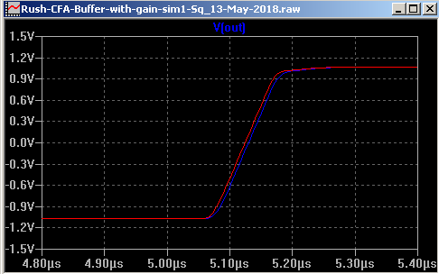

I have now compared the VFB Rush input stage (like the one for keantoken earlier) with a CFB Rush input stage. To convert it to CFB I connect the inverting buffer transistors to trans-diodes and lower the feedback resistors by a factor of 20 (now 500R and 12R previously VFB 5k and 250R). Then trimming R6,R7 for the original VAS current of 12mA. I also changed the OITPC capacitor (C9) to after the Tian voltage source as recommended by Dave Zan in posts earlier because large errors arise with the CFA version. I added a HF pole to the output stage buffer which is essential for tuning OITPC.
Keeping all other things the same the CFB version has half the loop gain and twice the THD of the VFB version. This is due to the 12 ohm CFB resistor (R3) which degenerates the inverting input by 3dB that the VFA version doesn't have. 12 ohms is about the lowest practical value due to the power rating of R4 to be under about 3W (eg two 2W MF or four 1W MF).
This shows CFA distortion in practical power amps can be slightly higher than a buffered CFA (a.ka. VFA) due to the degeneration effect of the resistor on the inverting input that the VFA version doesn't have. This is when all other variables are matched like I have tried my best to do.
There are slight differences between the CFB and VFB versions when compensating. The VFB version benefits from capacitance across the feedback resistor whereas the CFB version is best with bypass capacitors across the VAS emitter resistors.
These CFB and VFB input stages were then used with my Class-AB+C output stage. The CFB version also had twice the THD of the VFB version (FFT plots attached).
I'm not sure what you mean by "regular CFA". An example might help me. <snip>

Hi
I don't believe the first schematic in post-1 uses Ruish pairs; rather, the input device emitters are simply tied to a voltage reference.
Look at Cherry's NDFL amp.
I used Rush pairs before I'd heard of them in an amp I built in 1985. The amp worked but had problems and I didn't have any decent test equipment to figure it out back then.
- Has anyone seen Rush pairs used this way? For a CFA with true differential inputs
