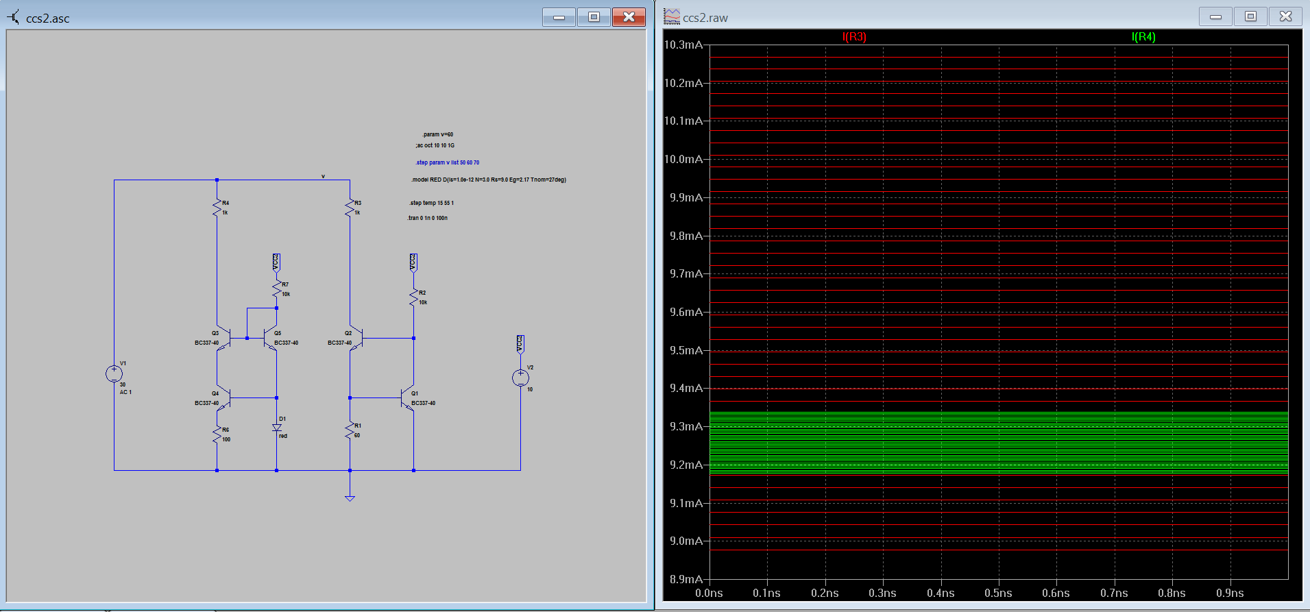

D1 R4 Q18 is a CCS.
D3 Q17 adds a cascode to the CCS.
It is a cascoded CCS.
D3 defines the Vce across Q18.
Using a red LED, or two diodes, increases the Vce across Q18
This may make no difference to the performance of the CCS, or it may improve the performance of the CCS.
I don't know which.
I am suggesting you look into the change and after informing yourself you decide to leave as is, or change it to a red LED.

Have you now accepted that it is not a current mirror (CM) and it is actually a constant current source/sink (CCS)?
My last attempt, this is from Sergio Santos, comparison between two CCS type (from the link you did not want to look at), one with two transistors in a feedback configuration and other with red LED transistor and current mirror.
I did not say that what Roender used is not good, just different. Open your eyes.

I looked at the schematic and also expected it would benefit from more V across the transistor. But I tried it in simulation and it doesn't seem to.
This is a surprise to me, perhaps you could sim it and we can both try to understand it better? Maybe in a different thread so as not to hijack Edmond's.

I looked at previous posts. Dadod, a diode and BJT are only a current mirror if the diode is across the B-E of the transistor, and any extra degeneration is equal for both junctions. Otherwise, it does not function as a current mirror. In your CCS the current through the diode does not change the current through the BJT, so it cannot be a current mirror.

Most of us have an inbuilt reflex to worry about transistors with less than 1Vce. I've found however in my Kmultipliers that for transistors without an obvious quasi-saturation region, they behave well right down to Vcesat. So more than 0.6Vce on a cascoded BC5xx won't do much good.
In a cascoded CCS it is actually the C-B leakage of the cascode transistor that is dominant in the output impedance. So the best way to get higher impedance is to choose a very high-gain cascode transistor (if Ib is low then B-C leakage will also be low) with low Cob.
If you think that a current mirror should have equal current in both legs than you are right. There current mirrors with unequal current with different degeneration ratio, why not with other transistor and LED in its emitters?
This has more to do with semantics than anything. By technicalities the bottom diode and transistor could be considered a current mirror. But I would never use it as a current mirror because it would be a very bad one. I think this is true for most of us, which is why I don't consider it a current mirror.
The top diode and transistor don't function as a current mirror, only as a cascode and bias generator, because the Vf of the diode does not change the Vbe of the transistor and so cannot have any direct current mirror effect. The bottom transistor and diode act as a very nonlinear current mirror with a ratio that rises logarithmically with current. I don't consider it a current mirror because it is not linear and can't really be used as one.
