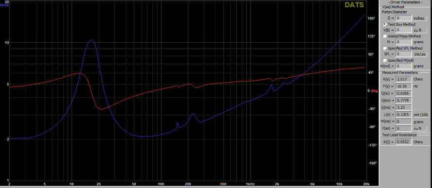

150 watts at 8 ohms is only 34volts.
At 25Hz, your series speaker impedance is ~40 ohms, ~29 watts from the amp.
Even without running a simulation, fairly sure 29 watts won't drive a pair of 500 watt speakers to 14mm excursion 😉 .

Post #1 shows the impedance of the ripole.

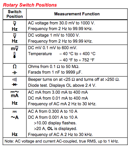

I have some amplifier questions. After just a little investigation with my Fluke 179, strapped across the Crown XLS2500 amplifier terminals, I see I'm only reading 2.4VAC rms, on max/hold, sine wave 50Hz, dual 15's in parallel creating this 2.13 Ohm load:

There is no need to use the hold function with a sine wave.I have some amplifier questions. After just a little investigation with my Fluke 179, strapped across the Crown XLS2500 amplifier terminals, I see I'm only reading 2.4VAC rms, on max/hold, sine wave 50Hz, dual 15's in parallel creating this 2.13 Ohm load:
Check an AC outlet (60 Hz 120v nominal in the USA), it should read between 110V (old 220 volt transformers) to near 120 volts (the more usual 240v single phase transformers) between the hot (smaller blade) and neutral (larger blade).
If it reads ~12volts, you know you have made an error in your reading.

I might be wrong but I doubt the meter is able to measure anything the common 50/60Hz power grid frequency.
Yes, you are wrong about that.I might be wrong but I doubt the meter is able to measure anything the common 50/60Hz power grid frequency.
Brandon's Fluke 179 is a particularly good true RMS multimeter, can read any AC or DC source one would be likely to encounter, and can also read the frequency:
That said, it has enough functions that it could easily confuse someone like Brandon, yourself or myself unfamiliar with a specific type of measurement.
Any common AC volt meter can measure the voltage of 50/60Hz grid power, I do it before plugging an amplifier into an unknown outlet.
I also check mains voltage before testing an amplifier's output, they can't reach rated power when the voltage drops.
I also have made plenty of measurement mistakes, especially with auto-ranging meters 😉

Something is wrong with your voltage measurement - check the settings on the Fluke. Maybe you had it showing min voltage rather than max?I increased the amplifier / LineOUT level until I smelled the voice coil, and the output level was 103dB at the listening position (roughly 3 m away).

Quite right, the leads weren't reliable. I am getting much more "correct" answers now. I noticed a 120V reading when I plugged it into the outlet, until I wiggled the lead a bit, then it was reading between 4-10V. So, I replaced the leads with new ones, and now I'm getting reliable, consistent readings...even with my shaky hands...lol.
20VAC at the output of amp gives me 96dB SPL, 34 Hz sine, 2m. That's somewhere around 150W at 2.6 or 2.7 Ohms. This seems to be in line with expectations. Whew! Hopefully the math is mathing now 😳 (sometimes my ADHD brain grabs values from another problem, like 3V instead of 2.4 yesterday). Lovely varnish smell too 🙂.
Okay At 2m, 17 Hz (impedance peak 10.4 Ohm)
16.5VAC 87dB ~26W
20.8VAC 89dB ~42W
26VAC 91dB ~65W
Based on the air chuffing, I'm hesitant to push further at that frequency, also because of the energy exposure. I'd rather not speculate on their actual excursion, but it's further than I'd ever push them, just aerodynamically. I'll be applying a HPF at 25Hz in the end.
