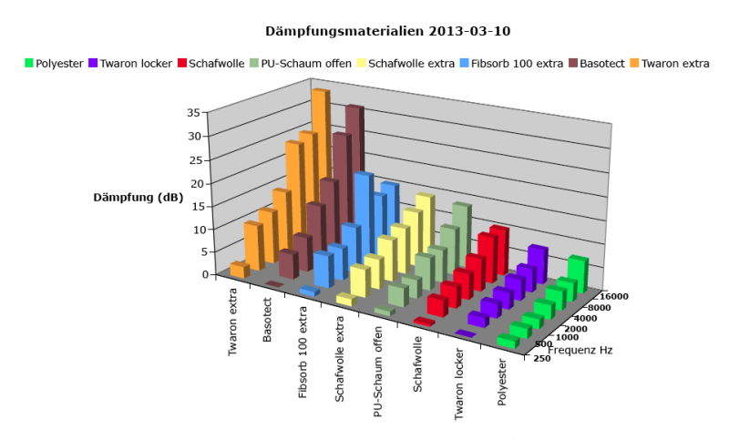

Here are some measurements of different damping materials, see also the previous pages for more detailed measurements.
Google translate can help if German is not that understandable.

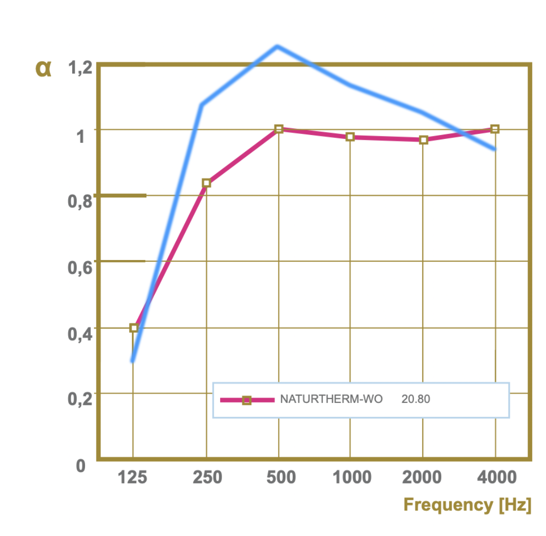

Comparing the 80mm thick wool batt which I'm looking at (in red) with 76mm thick 703 (in blue), the 703 does come out ahead above 150Hz. However, the wool measurements are using UNI EN ISO 354 whereas the 703 measurements use "ASTM C423; Mounting: Type A–Material placed against a solid backing". I have no idea whether these standards produce comparable results. This wool is only 20kg/m3 which is not particularly dense so perhaps a higher density would increase performance.
I could also simply use more sheep's wool to match the performance of 703 but thin panels are much more appealing in domestic rooms. I would like my panels to be barely noticeable.

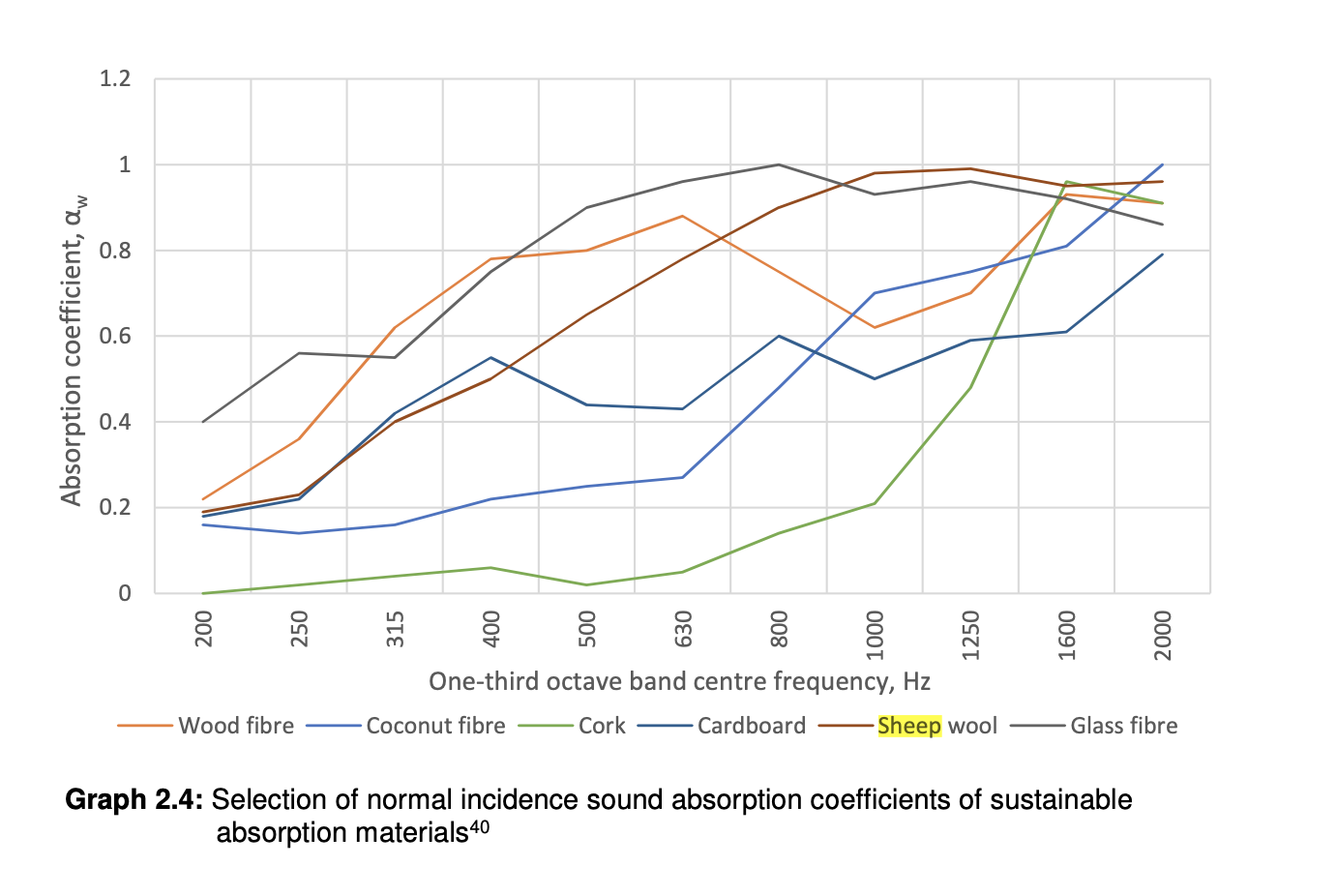

I found this chart in "The acoustic performance of suspended ceiling systems" by George van Hout. Interesting to see how well wood fibre performs, though it sounds like a potential fire hazard (and adding flame retardant material defeats the purpose of looking for natural materials). Sheep wool comes in third:
Interesting chart, thanks.
Is it the cardboard that does so well?

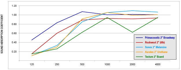

Anybody have the curve for Tectum? Really hard to get control below 200 Hz, yet that's where we need control.
B.
Yes, always astute.Of course, I just might be astute. ;-)
Thanks for Tectum data. While so-so in absorption (it is just shredded wood fibers), the frequency response is flatter... and that may be a primary factor in acoustic design for a music room, not HF control. So you can use more Tectum and get better results and flatter tone compass.
Not always straightforward reading data (esp from commercial sources). While Tectum sheets may look so-so, their normal mounting is like drywall (since they are strong panels), with a few inches behind while other panels lay flat on the walls. So a 2-inch comparison may not be quite illustrative.
