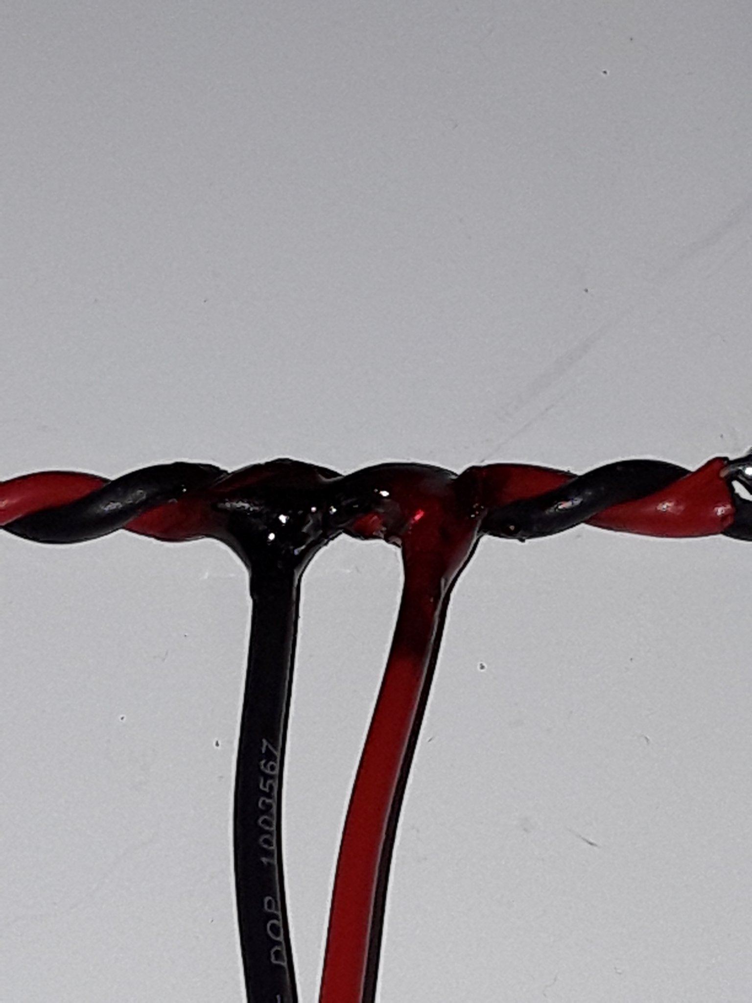

What is not understandable is why to bear heavy currents from socket to socket and not keeping the heavy currents away using separate leads with necessary currents for each only ? This is what I do, as simple as can be without no wiring complication:
The whole method I used to do a simple straight 'T' wire conection and keep the heavy currents rail away here: https://music-electronics-forum.com...amps/build-your-amp/979103-soldering-question
![20230315_203523.jpg 20230315_203523.jpg](https://www.diyaudio.com/community/data/attachments/1223/1223098-622285b61e4b786ca9dcabfbd53a042e.jpg)
