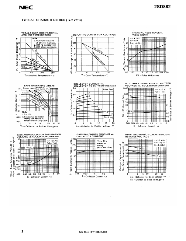

Interesting possibility.2SD882?

That looks like a 30 volt version of the D44 (Right down to the poor DCSOA, which is of little concern). I think they used to make a 30 volt version at one time.
Curves in the center figure says it all - gain stays high right up till it clips. Exactly what is wanted where the power supply voltage is low.

Unless the Hfe @ 120mA comes in at the high end of spec, I don't see the SD882 offering a significant improvement over the TIP41C for this experiment. The Chinese Fairchild-branded 41C (who knows if it's 'genuine') is really not bad, outperforming the OnSemi data sheet in many respects, and amazingly consistent unit-to-unit.

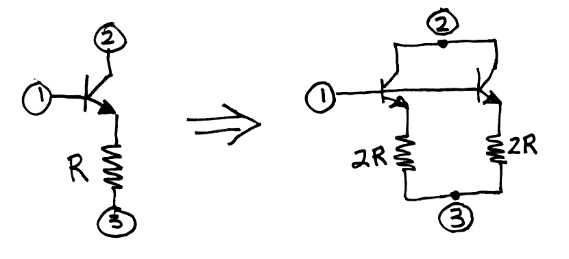

Although there is no line item for Thermal_Resistance_Junction_to_Case in any of the TTC004B datasheet tables, with a little ingenuity you can extract it from the plots. It's between 70 and 80 degrees C per Watt.
And of course you can use two of them in parallel to cut the per-device dissipation in half.
_
_
