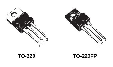

Have you considered the 2SC6144SG / 2SA2222SG already?
I got the 2SC6144's in today. They too are fully encapsulated. Not what I expected.
The datasheet says 2SC6144 is a TO-220F package (sometimes denoted as TO-220FP) meaning the package is fully insulated and don't need any additional insulation and so can be directly mounted onto the heatsink, but due to the insulation being same material as the rest of the black plastic encapsulating the die the thermal resistance is very poor, for example STP12PF06 and STF12PF06 (datasheet attached) are both the same MOSFET but the power rating is 225W for TO-220 and 60W TO-220FP due to Rthj-case difference 2.5 VS 5.35 °C/W.
The encapsulated transistors are likely 1 to 2 watt packages.
Be better to use a 7 to 15 watt packages that have thermal pads.

I'm really sorry for that. I didn't have the package in mind when I recommended the transistor. I haven't even had a close look at mine, kept the bags sealed.I got the 2SC6144's in today. They too are fully encapsulated. Not what I expected.
Since you only dissipate 1.4W, poor Rthjc is not a big issue in your application.
In case the Rthjc is 5 K/W and you have a small radiator with say 20 K/W, the silicon is at ~50° then.
Higher temperature also increases hfe, which is what you are looking for.
When I bought mine, I had ~1A bias in mind and 12-15V supply so I need to reconsider the application.
Does anybody know what is inside the fully encapsulated packages? I guess that the silicon is still mounted to a slab of metal that is then encapsulated? If so, could it be an option to just sand away the plastic at the rear in order to expose the metal slab?
It’s the same lead frame as a regular TO-220. I suppose it’s possible to sand away the encapsulant, but flatness and surface roughness may be a problem and you’d be back to poor heat transfer. Sand then polish, maybe. You may be just as well off buying a surface mount version and soldering a copper heat spreader (with a mounting hole) to it. Either way a lot of work, probably best off just buying something else and hanging on to these to use where they are suitable. In the case of 1.4 watts, they would be just fine.

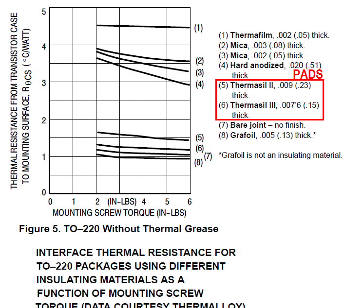

I generally use Bergquist Sil-Pads, without grease, on TO-220s. They correspond to plotted lines (5) and (6) in the figure below, lifted from ON Semi appnote AN-1040/D.For not fully isolated packages, you need to add an isolator and additional grease layer, easily another 1°C/W.
_
Interesting chart. How much does grease change the equation with mica?I generally use Bergquist Sil-Pads, without grease, on TO-220s. They correspond to plotted lines (5) and (6) in the figure below, lifted from ON Semi appnote AN-1040/D.
I used TTC004B/TTA004B as driver in 120W/4ohm amplifier to drive 2xTTC0002/TTA0002 outputs. It is fine, runs since approx. one year, with no problem. The drivers are mounted directly to the heatsink, without additional insulator. Bias is 25mA for the TTC004B/TTA004B pair.
That's the very next chart in the On Semi app note, whose identifier I mentioned in post #33Interesting chart. How much does grease change the equation with mica?
The answer is - LARGE impact. The Sil-Pads would make a lot of sense in a production environment, though.
