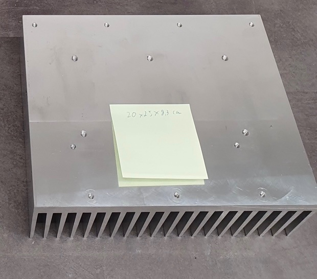

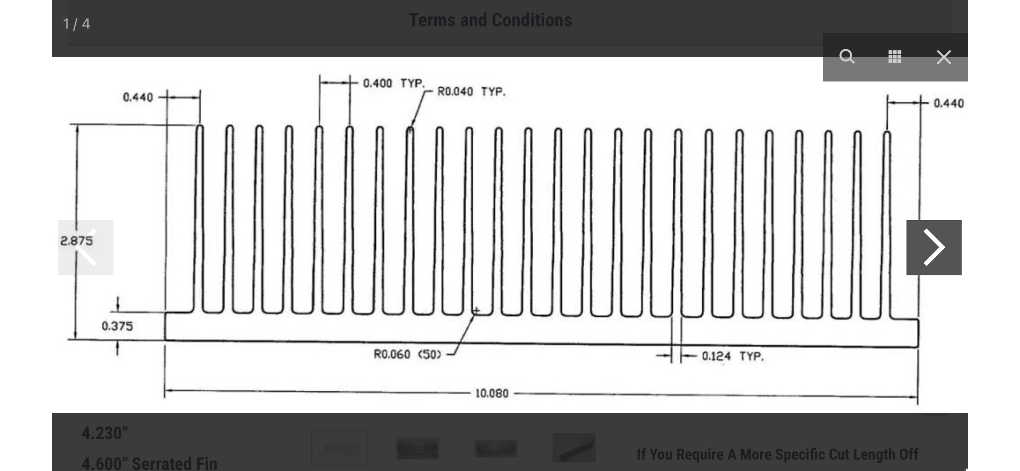

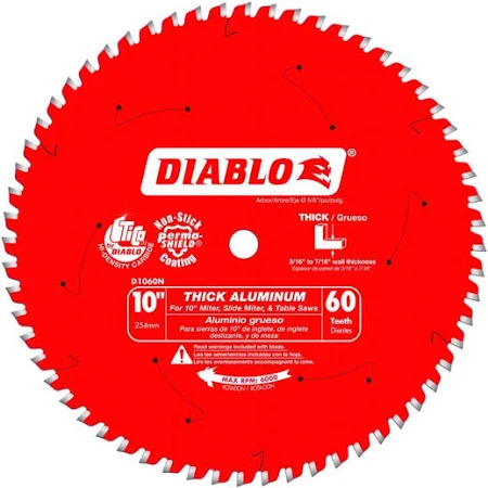

I was recently given a few massive heatsinks and looking for recommendations on how to cut them (it’s DIY isn’t it 😀) since a few are too tall. They are similar to the Heatsink USA stuff but slightly more robust.
Heatsink USA :
Mine are also about 10” wide but the rest is different;
Heatsink USA plate is 0.375” (9.5mm) thick , mine are 15mm thick. Heavy like hell 😀
Heatsink USA total thickness with fins is 2.875” (73mm), mine are 83mm.
Based on hands on experience, how would you cut such an aluminum piece so it’s usable, imperfections isn’t an issue, ugly side would be at the bottom, no problem.
Picture below;
Thanks for your help 👍

Yes, use a bandsaw blade intended for metal cutting, like carbon steel or bimetal types.

Bandsaw will require refinish with a belt sander or better a mill if you want to have decent and STRAIGHT finish, a hacksaw will destroy the heatsink and whoever does the sawing. The suggestion is ridiculous.

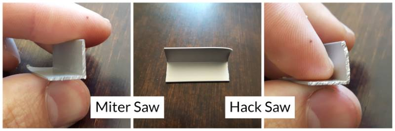

How do you want to cut it exactly? Along the fins or across the fins? I have done such cuts using a miter saw with Al blade and it came out nearly as nice as if milled BUT it's a dangerous 😱 operation and requires some equipment and setup. If you want to cut across you will need to insert wood shims in between the fins so they don't vibrate while cutting. The miter saw is the type needs to be able to run horizontally so you can take passes. Take it to a metal shop I would say.Hello,

I have a chop saw fitted with a 10" non-ferrous blade, so that's an option. As a plus, the chop saw gives a relatively smooth cut.

I did this type of aluminum cutting all day long on a table saw with a carbide blade.
In an ideal world, I’d set up a magnet coolant mister under the saw to spray a water soluble coolant/lubricant on the blade.
For one or two heatsinks you just need to take your time feeding the material slowly and keep your hands far enough away from the cut to prevent heat build up from affecting your grip…luckily, it’s a heatsink and will dissipate a lot of the heat.
Wear a snug long sleeve shirt and protective glasses to shield yourself from hot chips.
If your uncomfortable with machinery…find a metal yard and pay them to do it.

The OP has clearly stated that surface imperfections do not matter.Bandsaw will require refinish with a belt sander or better a mill if you want to have decent and STRAIGHT finish

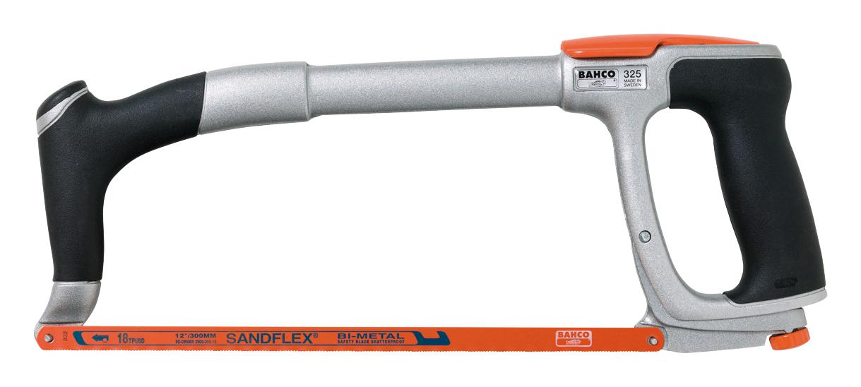

Are we talking about the same kind of hacksaw? I have cut heatsinks in the past with this:a hacksaw will destroy the heatsink and whoever does the sawing
Yes, it took some elbow grease, and the cut edge required sanding afterwards, but I wouldn't call the end result terrible. Just make sure that you have a relatively coarse multi-material blade, otherwise it gets clogged all the time.

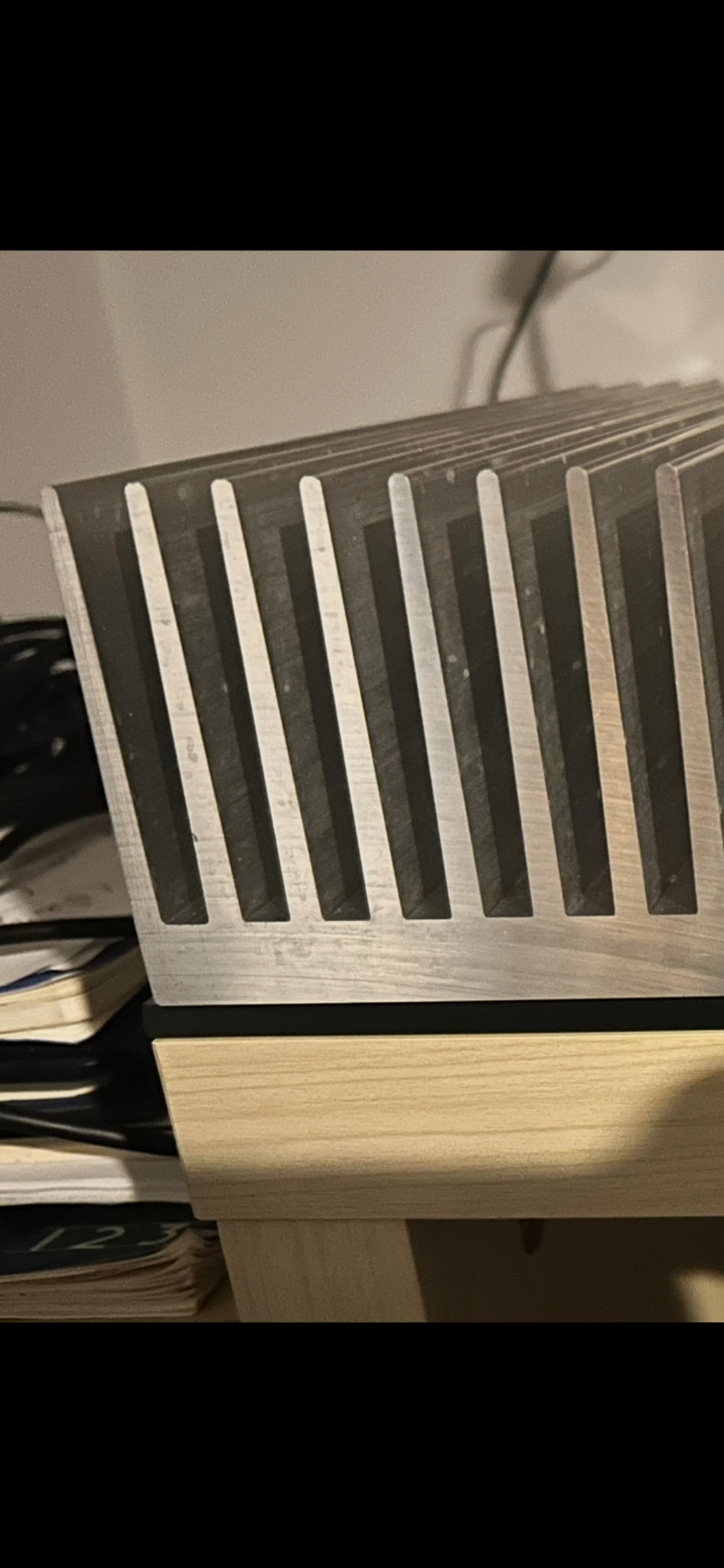

I have used a chop saw with a TCT blade to cut a large heatsink in half. Since my saw does not slide, I had to do two cuts, one from each side, carefully aligning them. The little step that remained was sanded down with random orbital sander.

My chop saw slides... I also have a bigger saw with a 12" blade that also slides. I have the option of fitting the larger saw with a metal cutting blade
