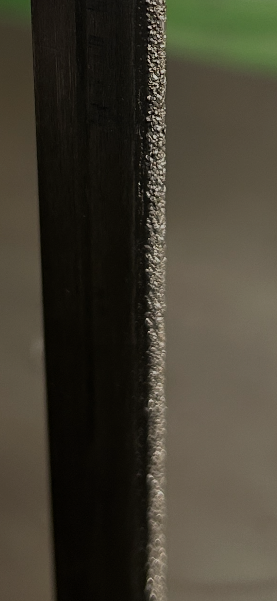

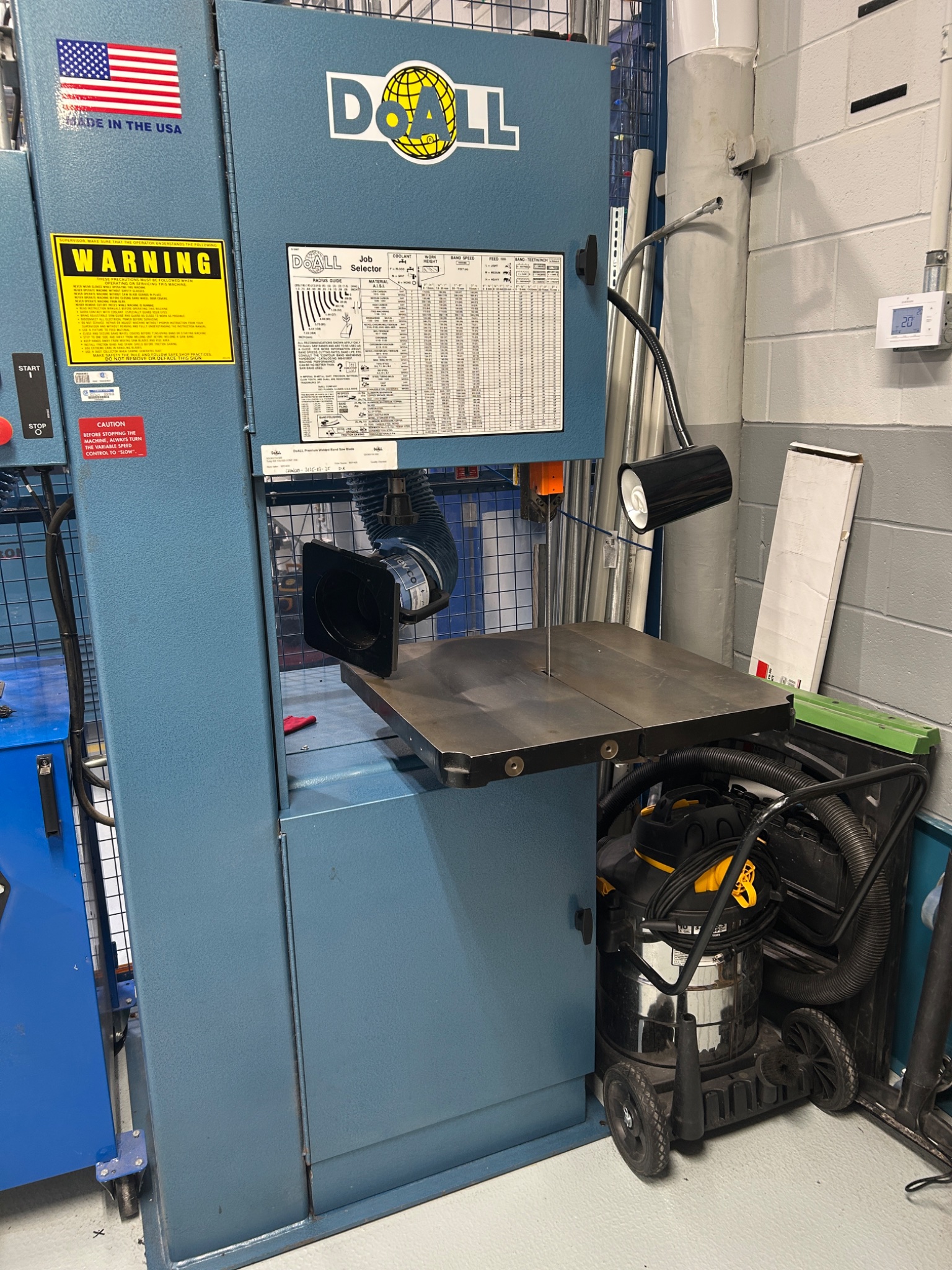

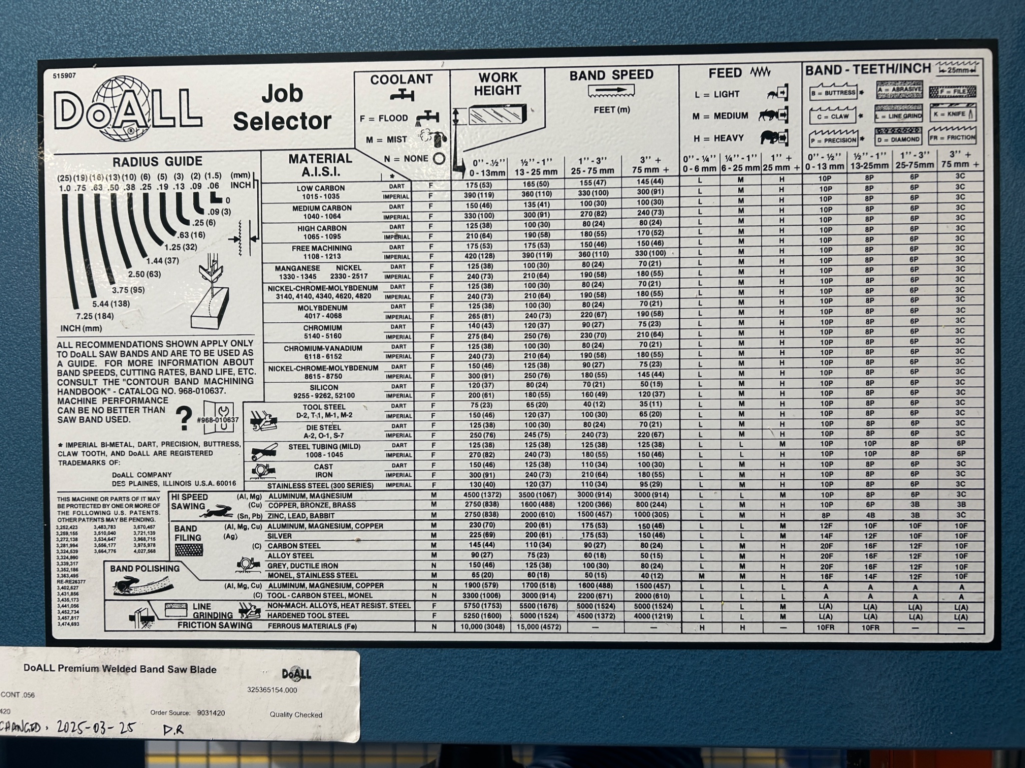

I have just found out that I have access to a sturdy bandsaw for metal at work. It’s about 7’ tall and massive. I’ll have a talk with one of our technicians so they can adjust the machine properly. I’m so thrilled although feel kinda dumb I wasn’t aware we had that nice unit (I work in the office, not the lab so that’s my reasoning…😂) I’ll show you pictures once they’re cut.
I’m wondering about the blade, what is it?View attachment 1473453View attachment 1473454View attachment 1473455

I would steer clear of that for aluminum as you won’t make any friends with the people who have to replace the blades.
That blade you’re going to destroy costs more than you hobby project likely.
https://www.doallsaws.com/406-94215...ENZJO5Kvepg4-CoFF3mNEATDDrzivlCl8QDbj1S9pkAil
It sounds like you got your current job done, but for future reference you might want to take a look at portable bandsaws. With some ingenuity they can be turned into small versions of horizontal and vertical bandsaws. Before I got my 4 x 6 bandsaw from Harbor Freight, I used a portable bandsaw to rough out steel and aluminum parts -- it's MUCH faster than a mill when it comes to removing large amounts of metal, and less wasteful (important if the waste bits you end up with are useful sizes).

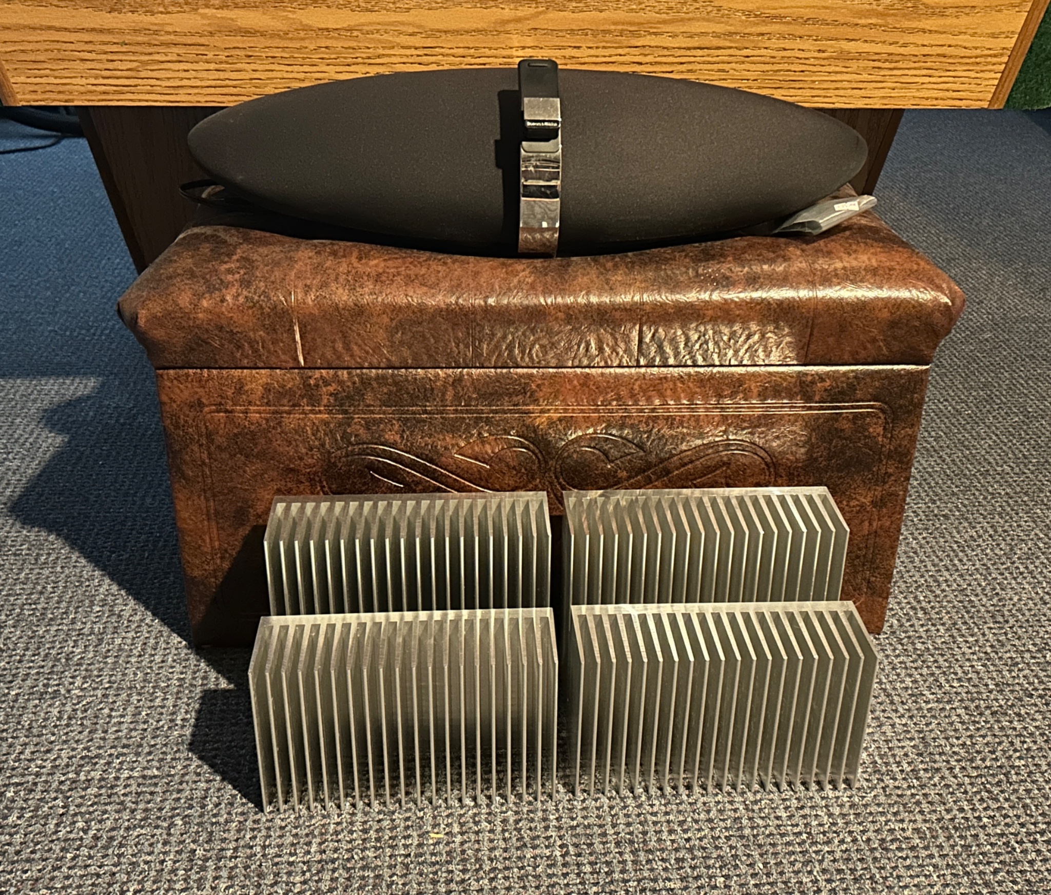

e_fortier,
The heat sinks look splendid - the workshop did a good job with the cuts.
This was done with a band saw, right?
With the long fins and thick base, these should be a good choice for your planned Class A projects. 🙂

Looks like Eric got a decent job done in the end. Well done.
