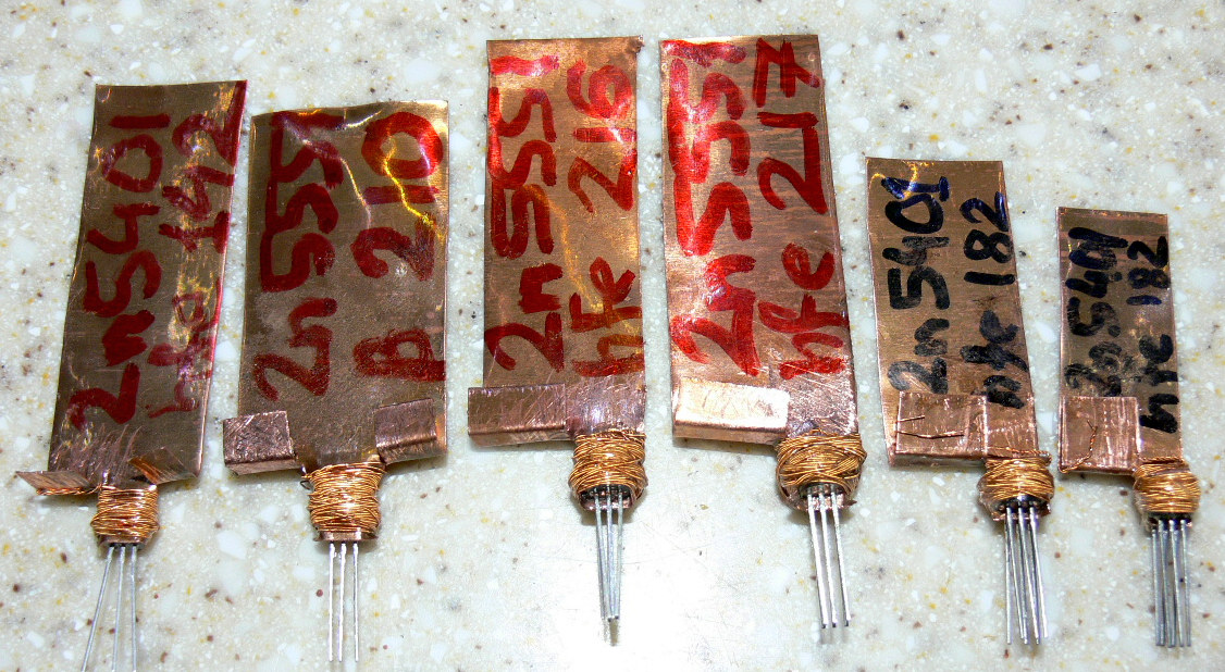

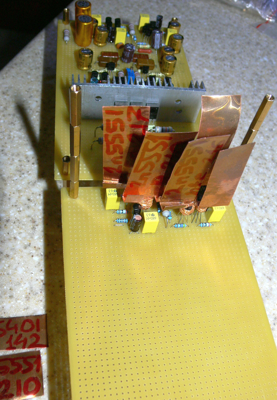

Any sense in lavish radiators for the TO-92 input stage transistors ?
I'm kind of like considering driving them rather hard ... The "singles" are for current sources / sinks. The "pairs" are beta matched (~0,6%) and thermally closely coupled ...
...The "pairs" are beta matched (~0,6%) and thermally closely coupled...
They look wonderful! Nice to see such a creative, low cost solution.
Certainly should help stability to have them thermally coupled, and lower temperatures can't hurt.
Op amp designers like to increase the LTP current for several reasons.
They say to turn it up until the silicon smokes.😉
The heat-sinks/radiators will provide you with a bit more flexibility or safety factor.
Many kind thanks for appreciation. Just trying to squeeze the maximum juice out of those tiny, high beta, high voltage, small pF, high transition frequency TO-92 toddlers.
Indeed, I firmly believe that "good sound" need not cost a fortune, to be discernible as such. My two basic principles are: KISS + BF. (Keep It Simple and Stupid + Brutal Force). Whatever knowledge I do not yet possess, I tend to catch up on with BF & KISS. Such "green grass" strategy has proven me very lucky in my tinkering till date. The down side is the kilograms. My last amp is c.a. 70kg. BF comes at a price of "kg". Till recently fiddled only with tubes and otl's; this is but my very first transistor based power amp. It may well happen that some rather basic questions may follow ...

That's thinner than I guessed would be useful.
Can you tell if 0.1mm thick is effective?
I use 10times thickness as effective radius for very good conductance of heat in an aluminium heatsink.
Copper being much better probably performs as well at 15times radius for very good conduction.
Accepting "only" adequate conductance at 30times thickness gives 6mm diameter for 0.1mm thick.
So I need guidance on effectiveness.
Too early to say. Not in the "real testing" stage yet. But should be OK. These are very small TO-92's. Copper is a good conductor. This thickness allows you to "model" the shape of the copper "around" the transistor. After glueing the "central" flat piece of transistor to copper, I use the "side wings" of copper to wrap around and then press on with the additional wire.
Just a wild guess concept - feel free to modify as per your individual gut feeling and taste. I just happened to have that particular thickness avaliable from another project.
I could imagine that 0.2 would still be flexible / workable, but providing more heat conduction ...
