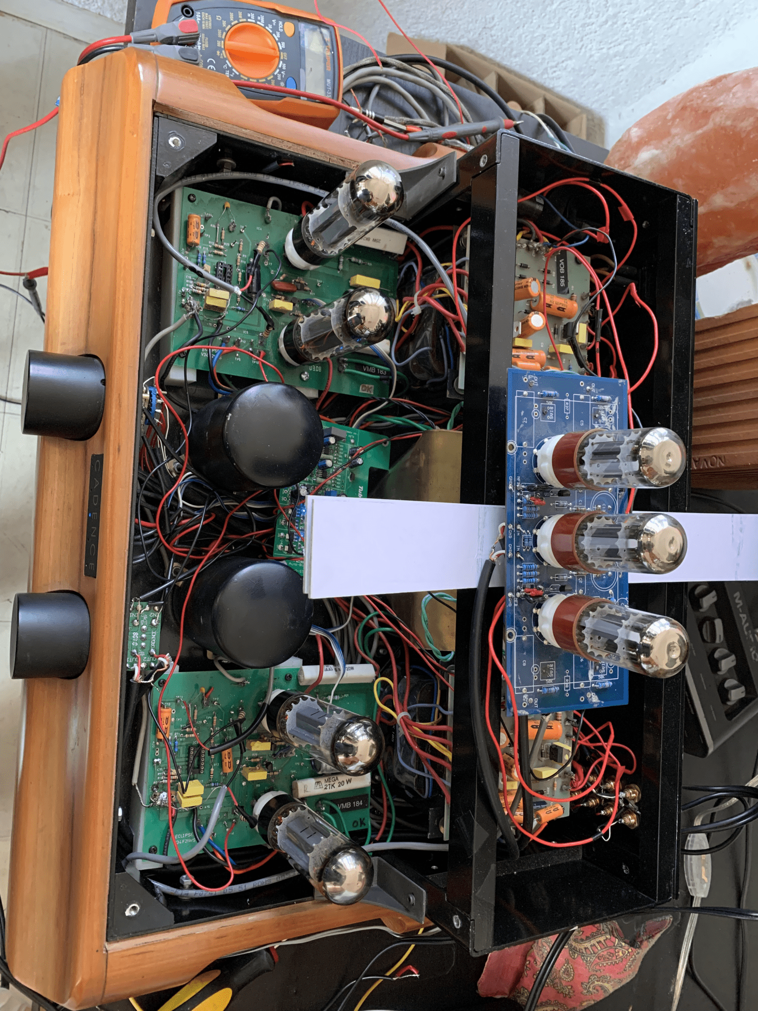

Thanks for the reply, I´m not at home now to take better fotos, but I had the following: one view of the whole amp, but with two modifications I was doing at that time: adding a 6SN7 preamp (which is in the top) and an automatic bias circuit (at the center behind the filters).

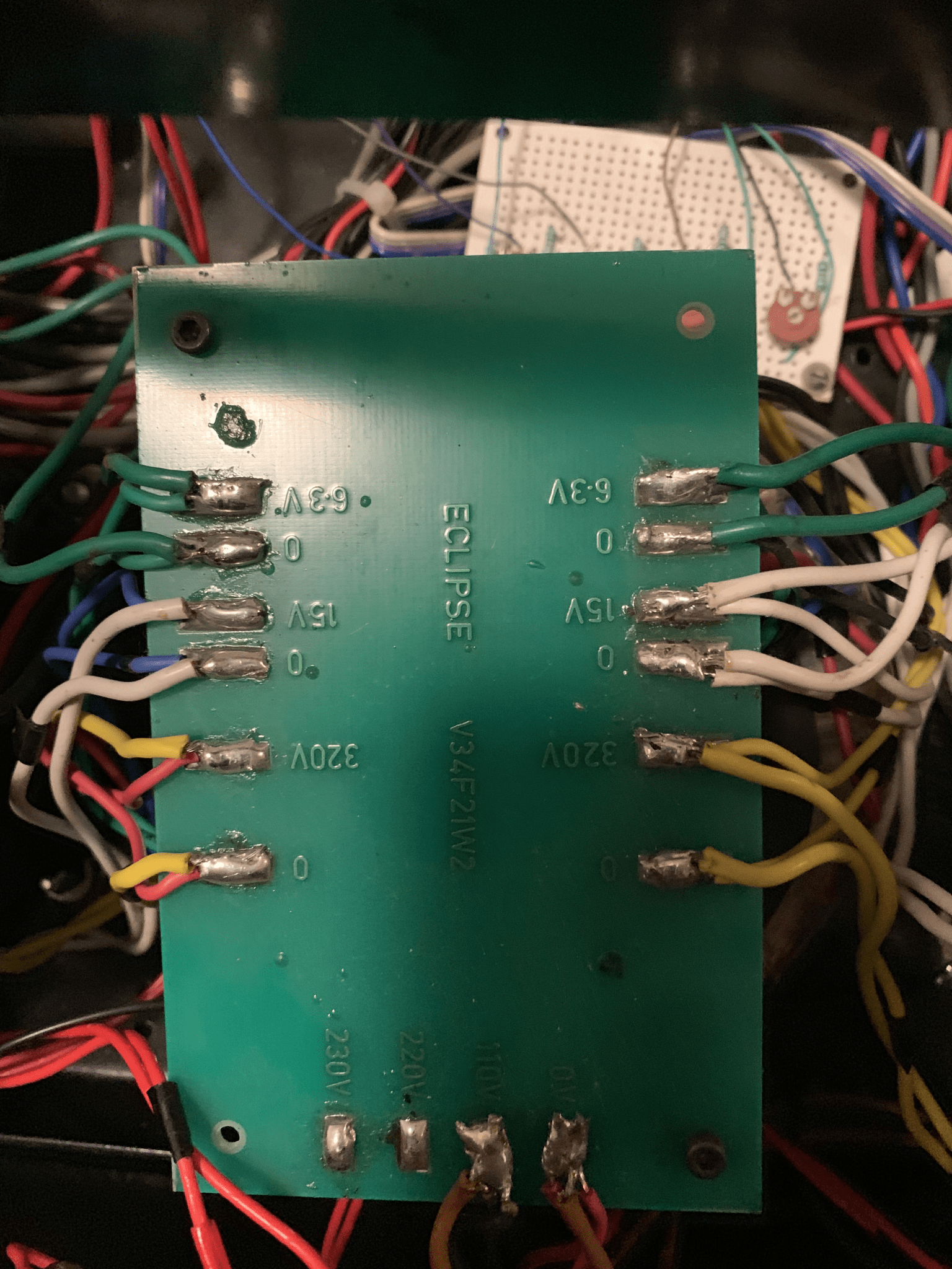

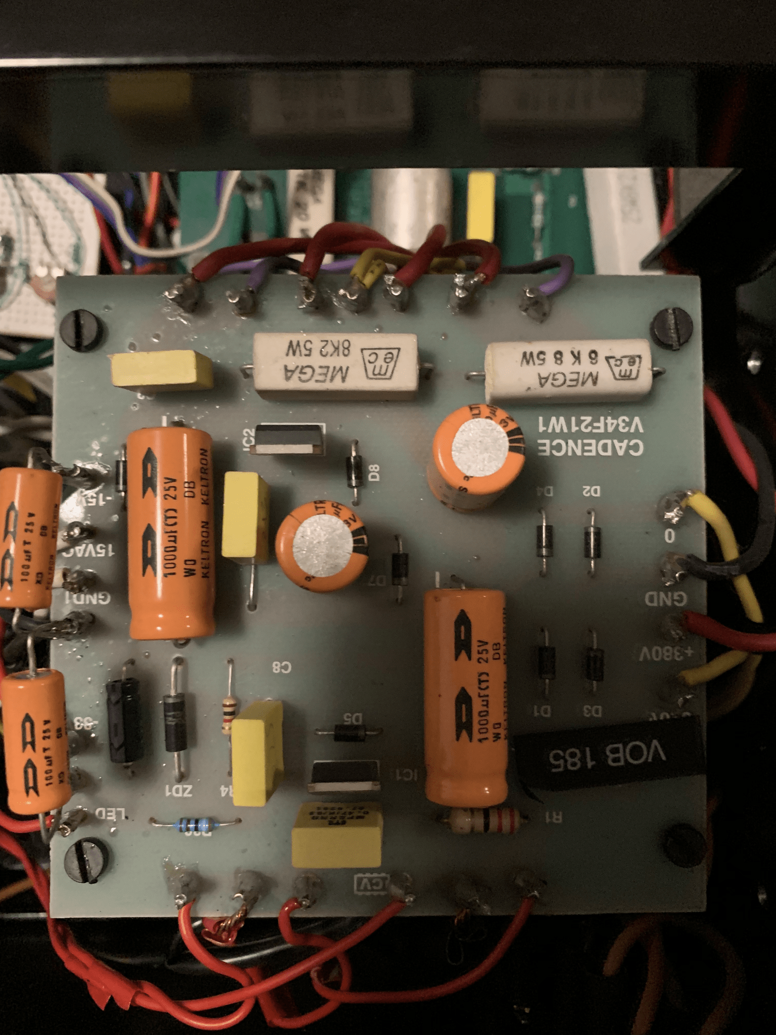

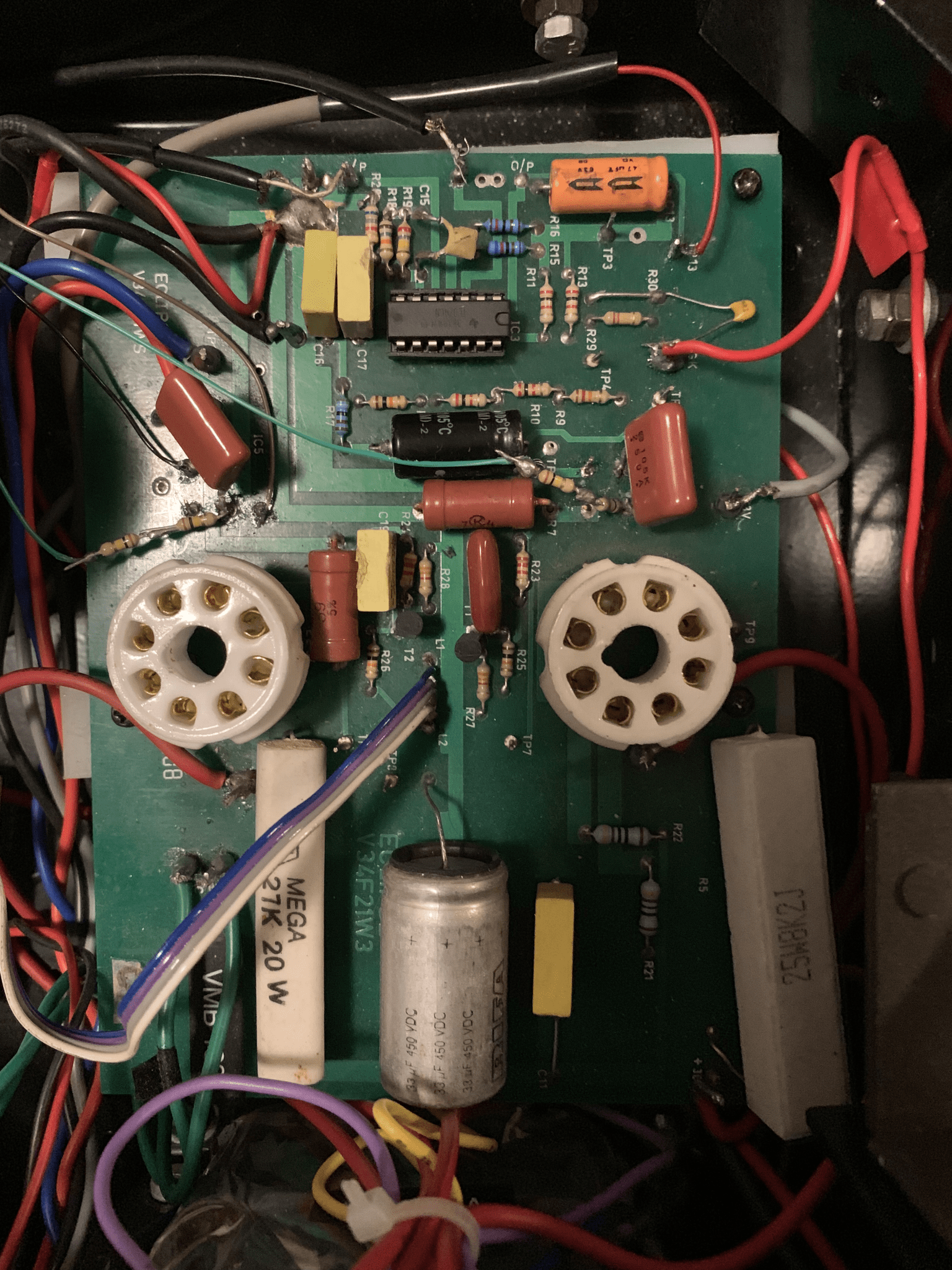

The second phot is the pcb for two EL34 tubes and the other two are the PCB of the one channel power source.

No schematics, even of the modifications that you've done? You're not giving us a lot to work with. Is there an actual problem or fault with the amplifier, or or are you just generally interested in improving/ modernizing it? Either will require a schematic, which you can draw out for yourself, unfortunately by hand, the old fashioned way. Worst case.
