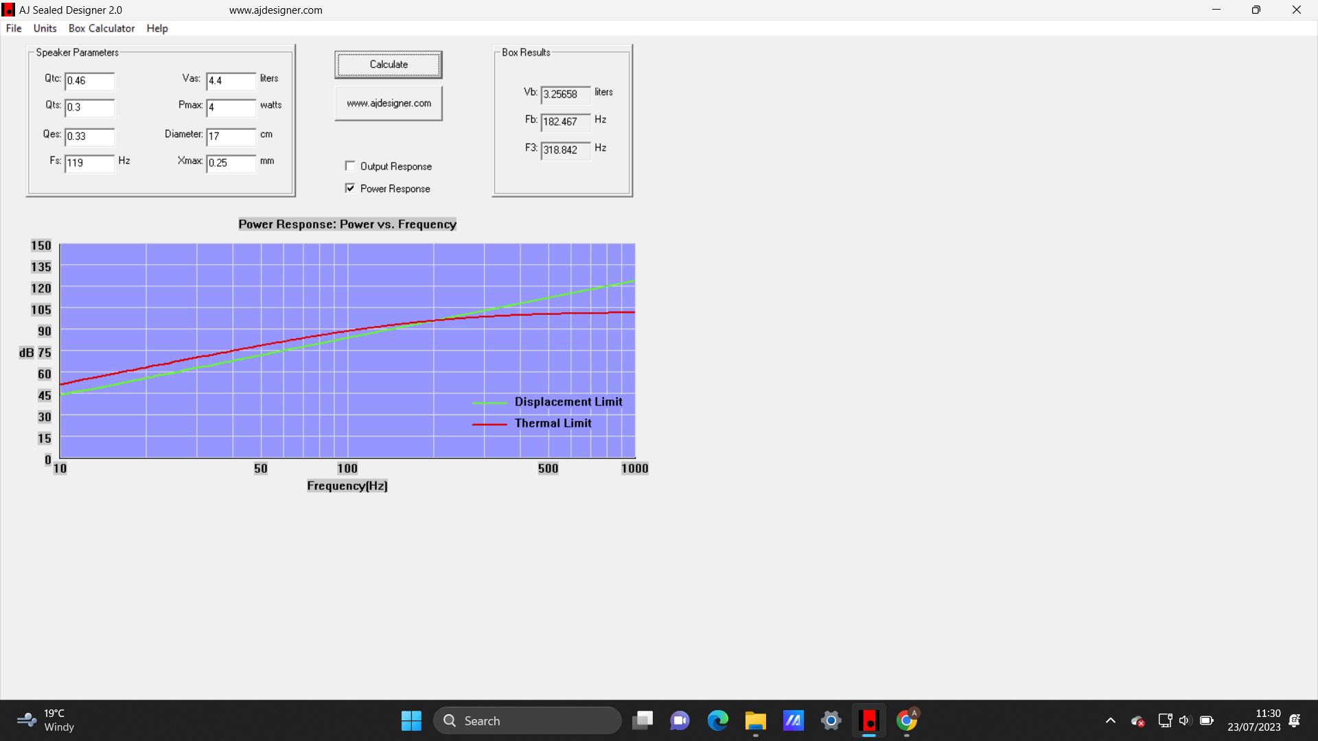

And hence I posted the simulation of the 18 inch bass driver in a sealed box, also explained in a following post a brief explanation of why sealed box/ time domain accuracy is superior to any port/TL/delayed resonance system... As James says "Its hard to fill a glass that is already full" and clearly Tim your cup is overflowing...😉

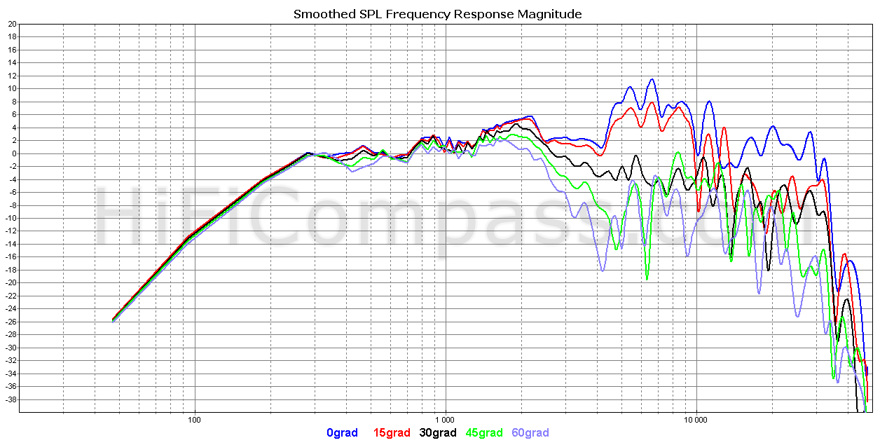

Frequency obviously and in turn obv step&impulse. Here an example between a Seas W15LY001 and 2 pa midwoofers from hificompass:View attachment 1195666

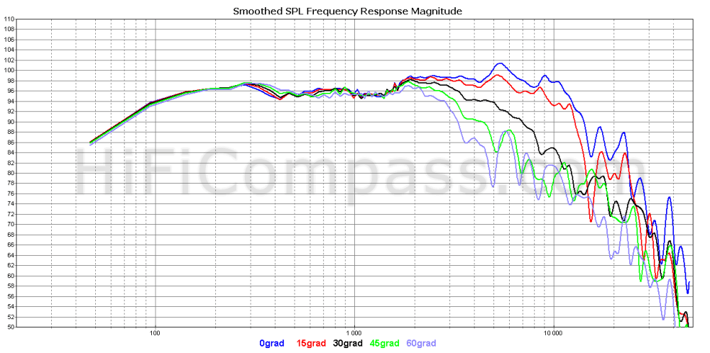

And a Beyma 5G40Nd;

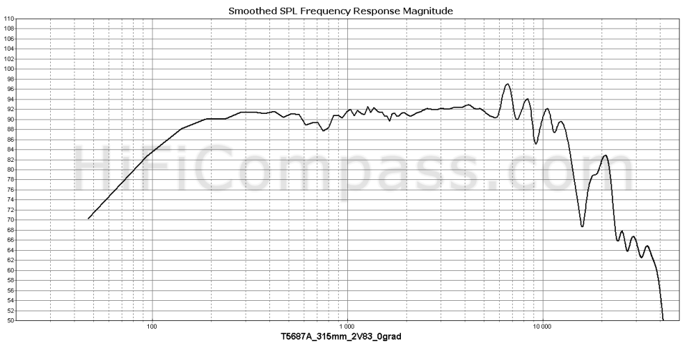

And a Celestion T5687A with only on-axis as HifiCompass doesn't have off axis sadly.
You clearly see much more smooth high frequency and breakup as I claimed and rolloff also looks relaxter and less steep on the Seas.
Damn, that Celestion is one sweet driver when used as I suggest ie sealed box covering 300Hz to 2Khz or maybe 3Khz. But its still only 5 inch driver and the 6inch or 6.5 inch drivers are way better... Why is bigger better in this case? Here is why:
Becausea pair of the 6.5 inch PHL drivers will hit your 100dB in room SPL with under 0.25mm (!) of cone travel and do this with just 4 watts in a 3 litre sealed box!! If you dont understand the significance and fundamental advantages of this... Well as I said earlier, I am happy with that situation.
As you can see what I said were/could be problems is actually reality, so please again tell me why I should, with facts please not just opinions, use pro drivers if I want only 80-96db max spl and have a 400 watt amplifier to power them and where they are supposedly supperior?
