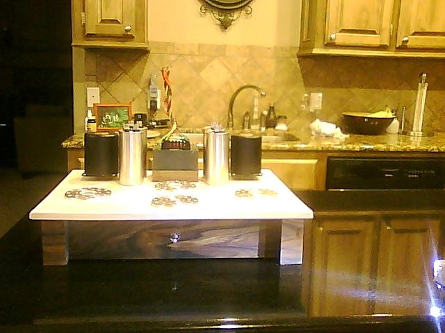

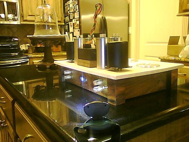

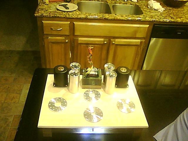

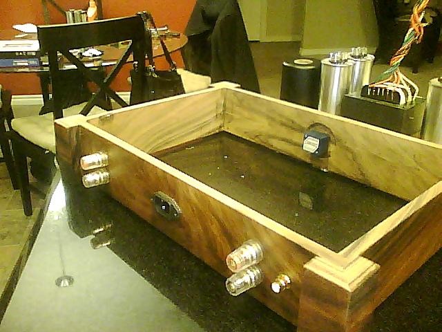

Here is a few picks of my layout. I just finished the chassis today, still need to drill the top and bolt the top to the sides but all in all it is basically complete.
The sides are Spanish Modena, a very dry, brittle, and light weight hardwood I found at a specialty hardwood store in Dallas, TX. The top is strips 1"x0.5" and 19" long of White Tiger Maple laminated together to make a 1/2" thick plank. I did the lamination like this to bring out the multiple stripes that are best seen on the cut edge of the Maple. the grain has a 3D dimension to it not seen in the photos at all.
Binding posts are from VT4C and James. The IEC filter is a Tyco and the pot is a Alps Blue Velvet (will be shunt moddded).
Hard part is almost over, just need to drill the plank and wire it up!
Next pics will be upon completion, hopefully with some traces.
Jeff

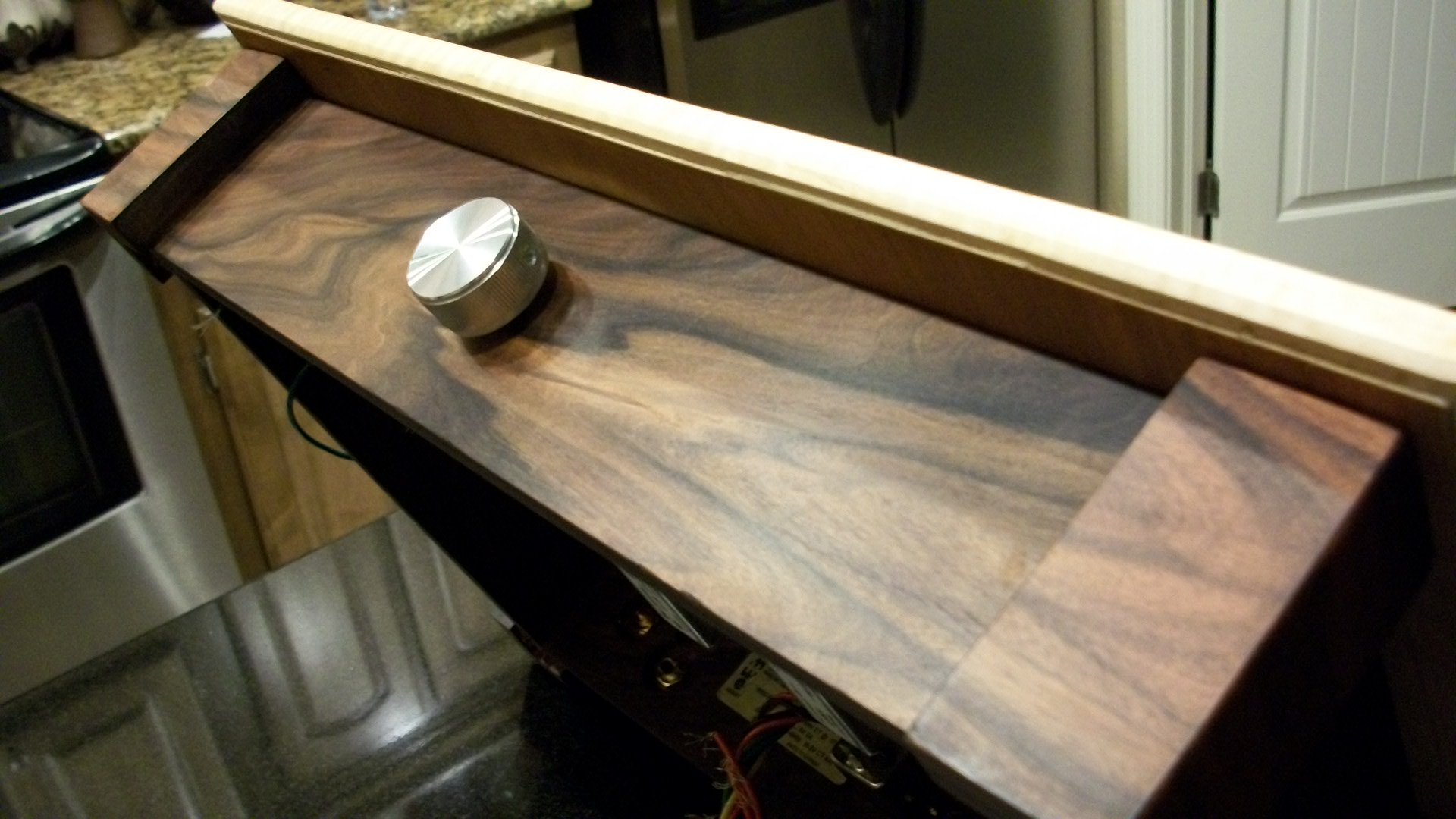

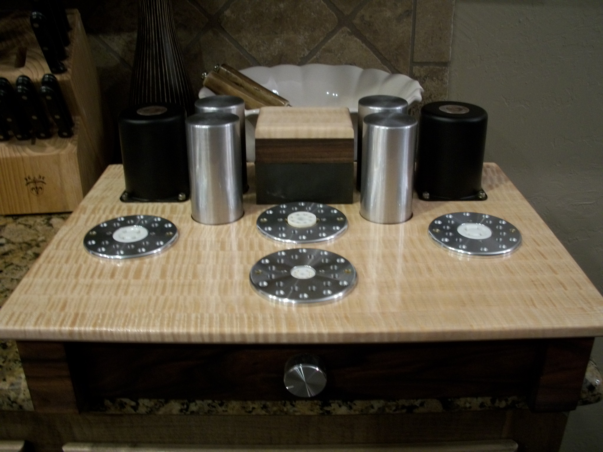

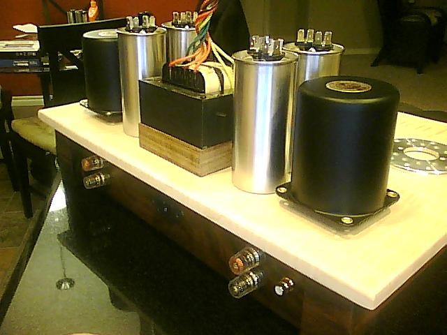

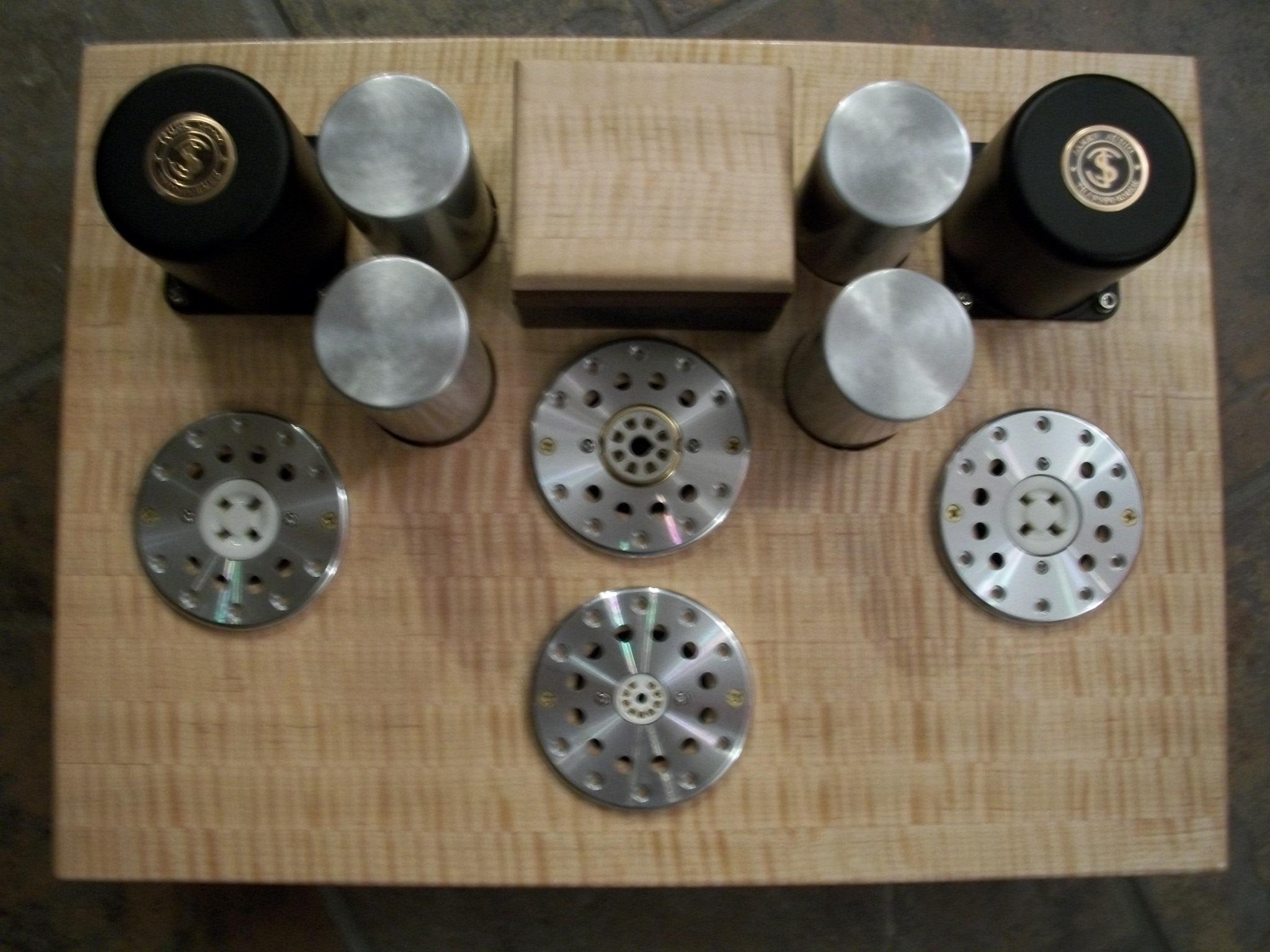

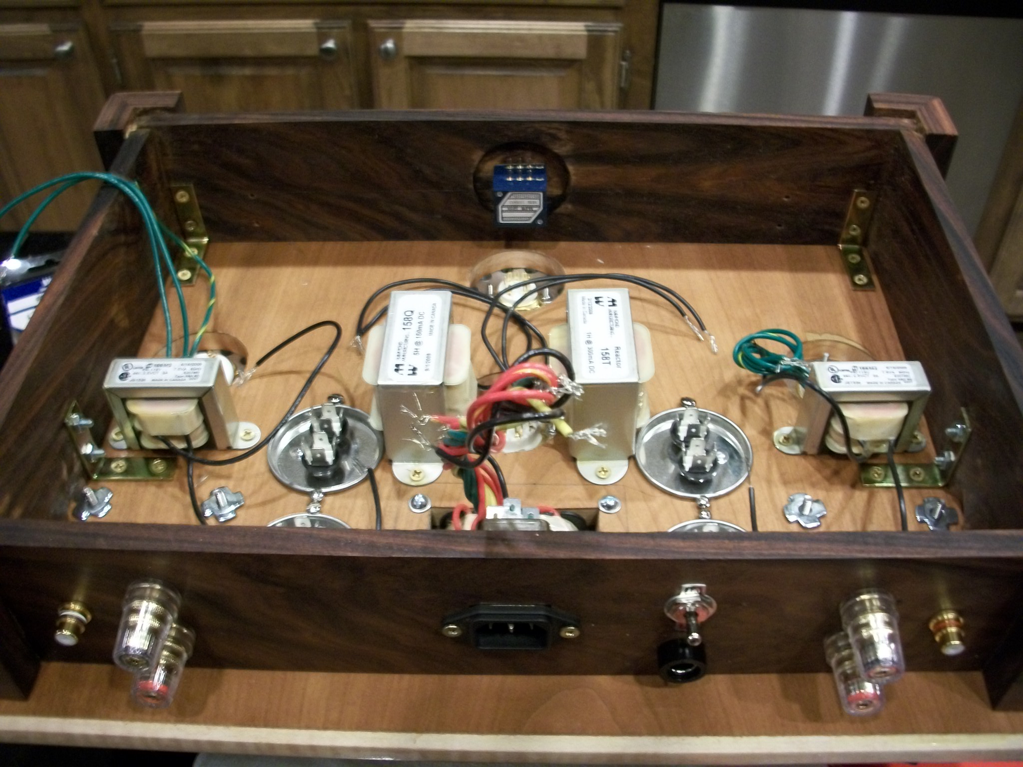

Just completed the chassis. It is all hand built from scratch. Again, the sides are Spanish Modena and the top is laminated White Tiger Maple. These are better photos and the 3D like appearance of the grain is now seen. On the bottom I used some Cherry veneer ply (3 layer) and glued it down to give it more strength across the laminations.
Seen here is all the connectors (Vampire and Connex) and x2 chokes and x2 2.5vct filament transformers. The vent plates for the tube sockets were purchased from VT4C.com. The James 6112HS output transformers are from TCTubes.com (best deal I have found with s/h included). The power transformer is Hammond as well, disassembled ans mounted sideways with a hand built cap out of the same wood as sides and top. Caps are ASC 45uF 370vac. I will parallel these with a 10uF Solen on each side for a total of 100uF as the last caps before the output stage. The 200uF between the 2 chokes will be a combination of Nichicon and Solen as well. I haven't decided on the 100uF called for at the driver stage, depends on how much real estate I have under the chassis as I get going. Either Elna Cerafine or a combination of Solen and ASC.
Hard part is done, the rest is a piece of cake. Should have it done by tomorrow afternoon if all goes well.
Remainder of parts are PRP resistors, Silver 18 & 22 gauge wire, Black Gate bypass, and Copper foil in oil coupling caps. I also will be using the K&K audio CCS on the drivers for plate load.
Jeff

Wow! You have some skills! Great woodwork and layout.
Do you cover the motor run caps, or just shine them up?
I use some stuff from Home Depot, it is a 440 grit sanding product that is purple foam, about 2.5inx5in sheets. I go around them with these sanding sheets until they sparkle then I shoot a coat of clear lacquer over them.
Sorry I cannot remember the exact name for these sanding sheets but look for purple at the sand paper isle, I am sure you will be able to find it. If your caps are particularly rough, start with the 220, then graduate to the 330 then 440 grits. I am not exactly sure what the cap cans are made from, some sort of alloy that appears to have aluminum. It makes a very fine black powder when you sand it and this stuff will stain your clothes. Didn't come all the way out after 3 washes on my white t-shirt.
Be sure to use real lacquer. I used enamel once but it causes a cloudy white appearence to the finish as you get it to a good thickness. The lacquer does a better job of getting a thicker coat without clouding. Multiple thin coats with a 440 sand in between is best. Lacquer is pretty thin and will run easy so go light.

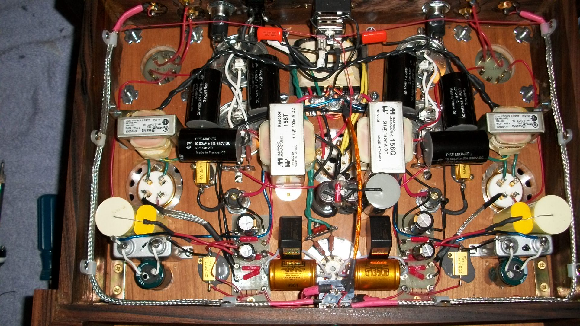

Just finished wiring it up

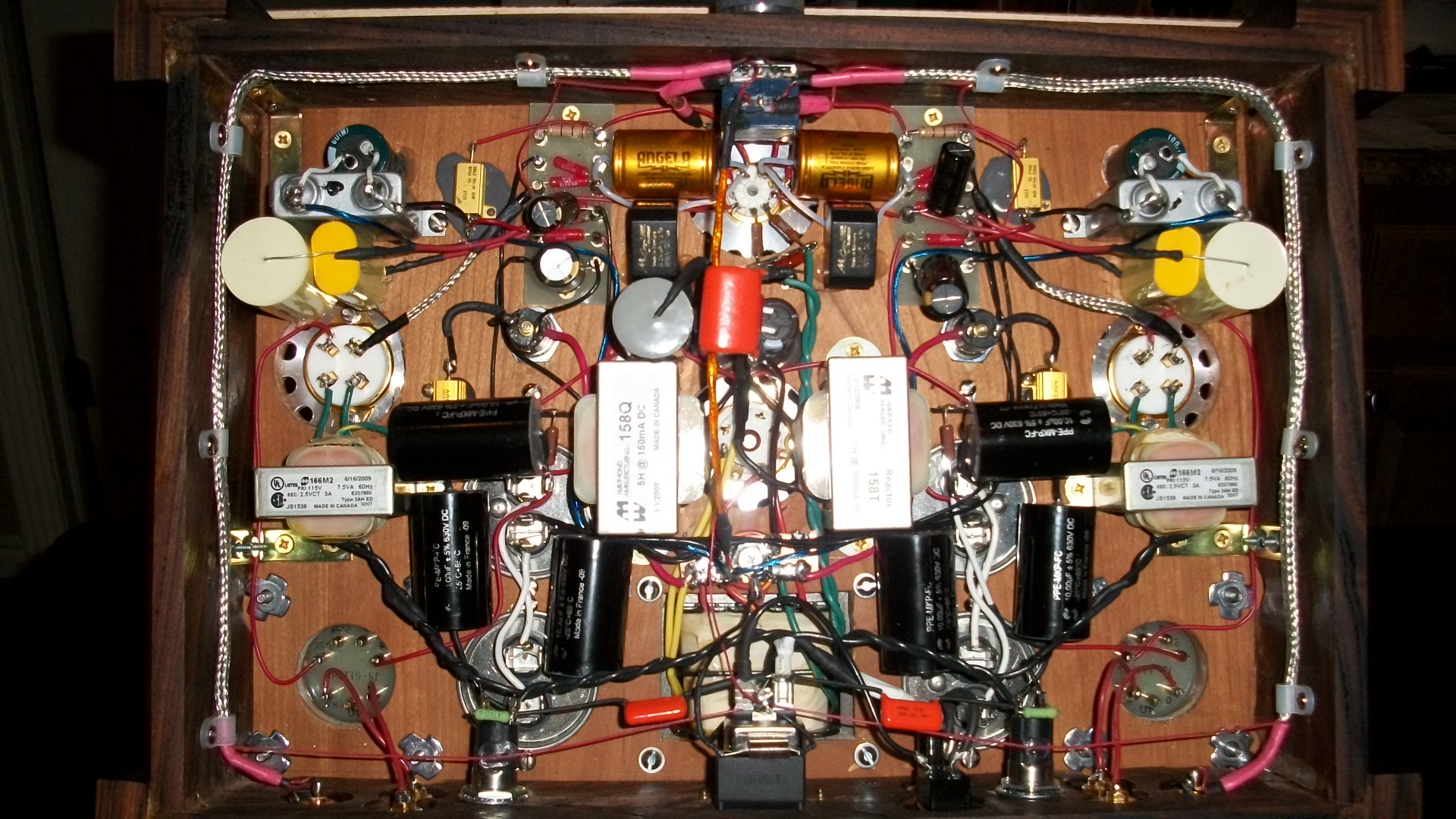

I just finished wiring it up. Haven't tested it yet, will do it in the morning. Here are some pics of the underside.
Jeff

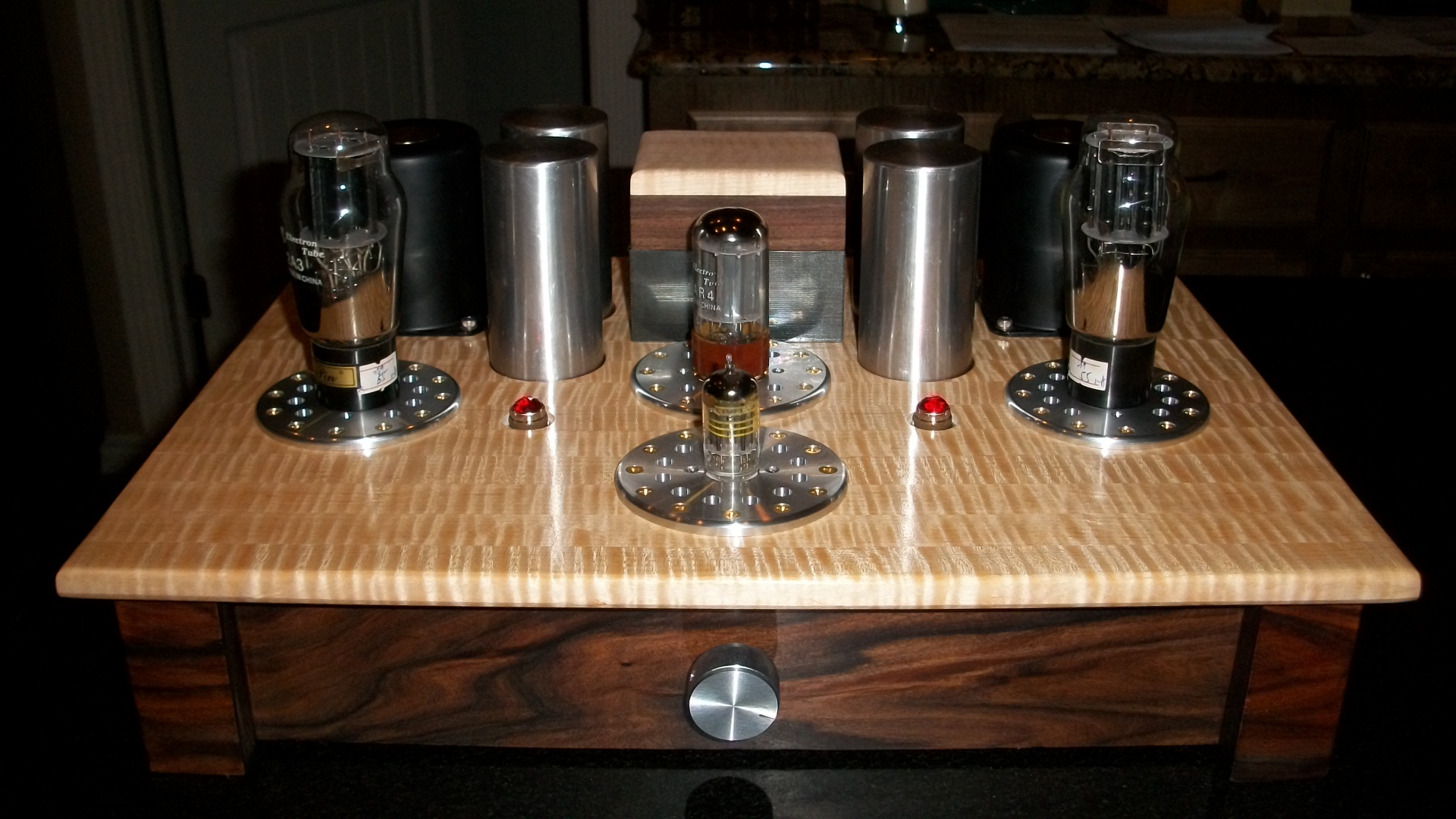

Running for a week or so now
I haven't posted on this thread since I got her up and running. I had some problems at first that ended up simply being a bad 5687 tube. I had another used one that worked and it sounded great. Since then I ordered some good NOS 5687 tubes and also got a pair of NOS NIB RCA 2A3's too. It is up and running with these "upgrades for about a week now and I am really likeing it more and more as it gets broken in. The first batch of K&K CCS were actually bad and I had to send them back for replacements so I just went with a 10K plate load resistor and a bypassed cathode. It has enough gain to get some decent volume but it will not drive to clipping. I will have the CCS on it in about 2-3 days and I am hoping for a little more "ooommpphh" from it. All in all I like it very much though and I can achieve good listening volumes the way it is just fine.
It actually has more bottom end than I expected, about as much as my S5 502-K kit amp 8wpc amp did! (I think that amp was more like 5wpc though in reality).
I built this one as my first DHT with intentions to sell it eventually but now I am having a hard time imagining that.
I will try the CCS soon and will report back on how it works. As far as the D3a, I ended up getting 4 of them and now I have to build something that uses them. I might try that "New 2A3" posted earlier on this thread, nor sure yet. Also thinking of a 2A3 Self inverting push pull (SIPP) like the Oddblocks use and use the D3a to drive them. So many choices out there and so little time!
Jeff
