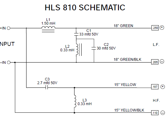

I checked the crossovers and there is a polypropylene capacitor in series with the tweeters, so I am not worried about that being a problem anymore.

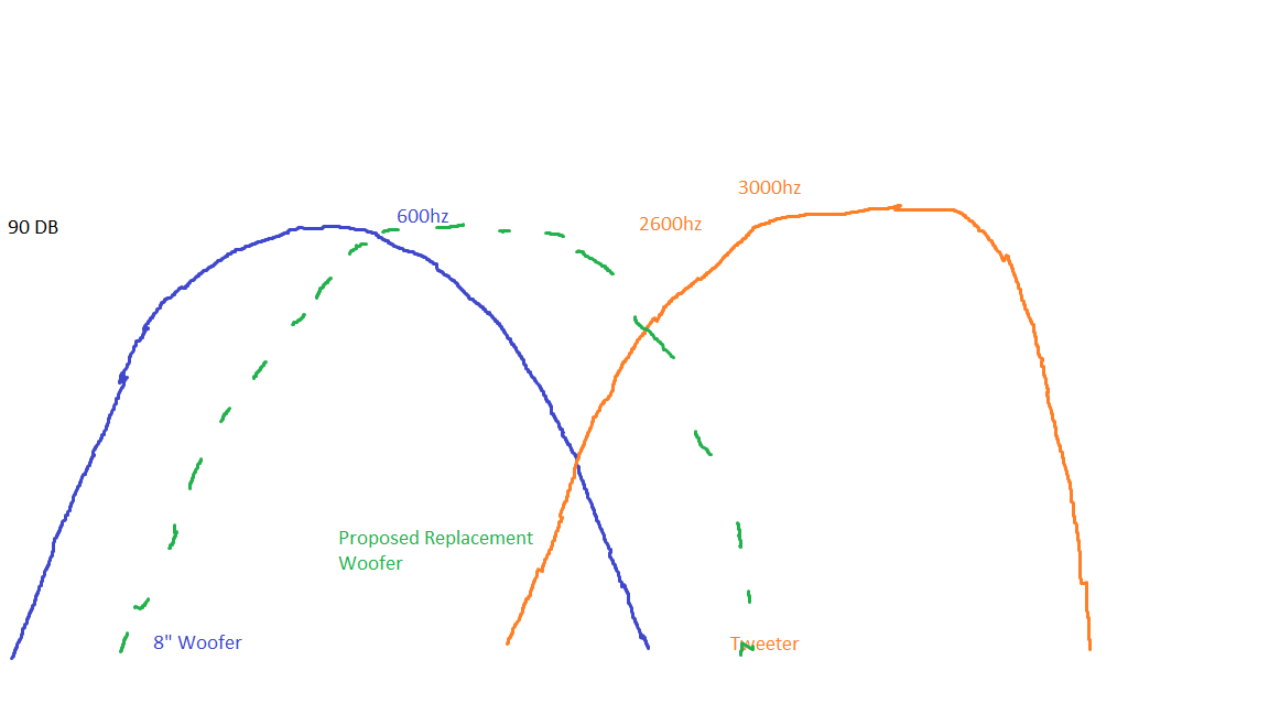

The woofers on the 810's on the other hand are rather poor. From about 100hz to 600hz, the 8" woofers work efficiently, however anything between about 1000hz and 2600hz (where the tweeters come in) is just not represented well. I would say that there is a 1600hz gap in which the speakers are not representing my audio faithfully and where overall volume diminishes. Even at 2600hz, the tweeters are beginning to break up a bit (I do not believe that they should be crossed at 2600hz for an optimally-flat frequency response). I have had multiple people confirm this problem.
Therefore, I propose the following: Since the same exact tweeter is crossed over at 3000hz in the JBL 410's, I would raise the crossover to 3000hz and replace the woofers with more competent (better) woofers that are able to maintain a flat frequency response up to around 2600-3000hz. I don't mind sacrificing a bit of low-end since I have a Paradigm SB-90 subwoofer that will cover anything between about 30hz and 90hz well. Thus, I might look for a woofer that will respond well from between about 120hz and 3000hz if possible.
This SHOULD fix my problem. What do you guys think? Do you have any woofers that you would recommend and could I just raise the crossover frequency by changing out the poly capacitors that are in-line with the tweeters? Finally, since these woofers are not part of horns, am I correct when I say that I shouldn't have to worry as much about their interaction with the horn component?
I could leave the crossover point at 2600hz if you believe that the larger plastic horns in the 810's vs the 410's are somehow optimizing these tweeters for a lower crossover frequency, however I don't see how raising the crossover into the tweeters' "sweet spots" should harm anything.
Here is a rough frequency response graph that illustrates what I am talking about:
Post the measurements so we can see whats going on
I'm struggling to follow this, but it seems JBL have fitted an 8" 4.4 ohm polypropylene woofer to a horn-loaded puny 5.5 ohm mylar tweeter. I get a crossover around 5000Hz on the 5.5ohm tweeter.
That shunt 0.33mH/30uF trap is an odd thing to fit. It seems to boost output around 1600Hz. If it was like a bextrene KEF B200 bass, you'd probably fit a simple shunt 7uF capacitor across the bass filter and do without the trap and the 33uF.
What is odd, is that you really shouldn't be expecting an 8" bass to cover up to 5000Hz. That and the plastic horn must sound horrible! 😉

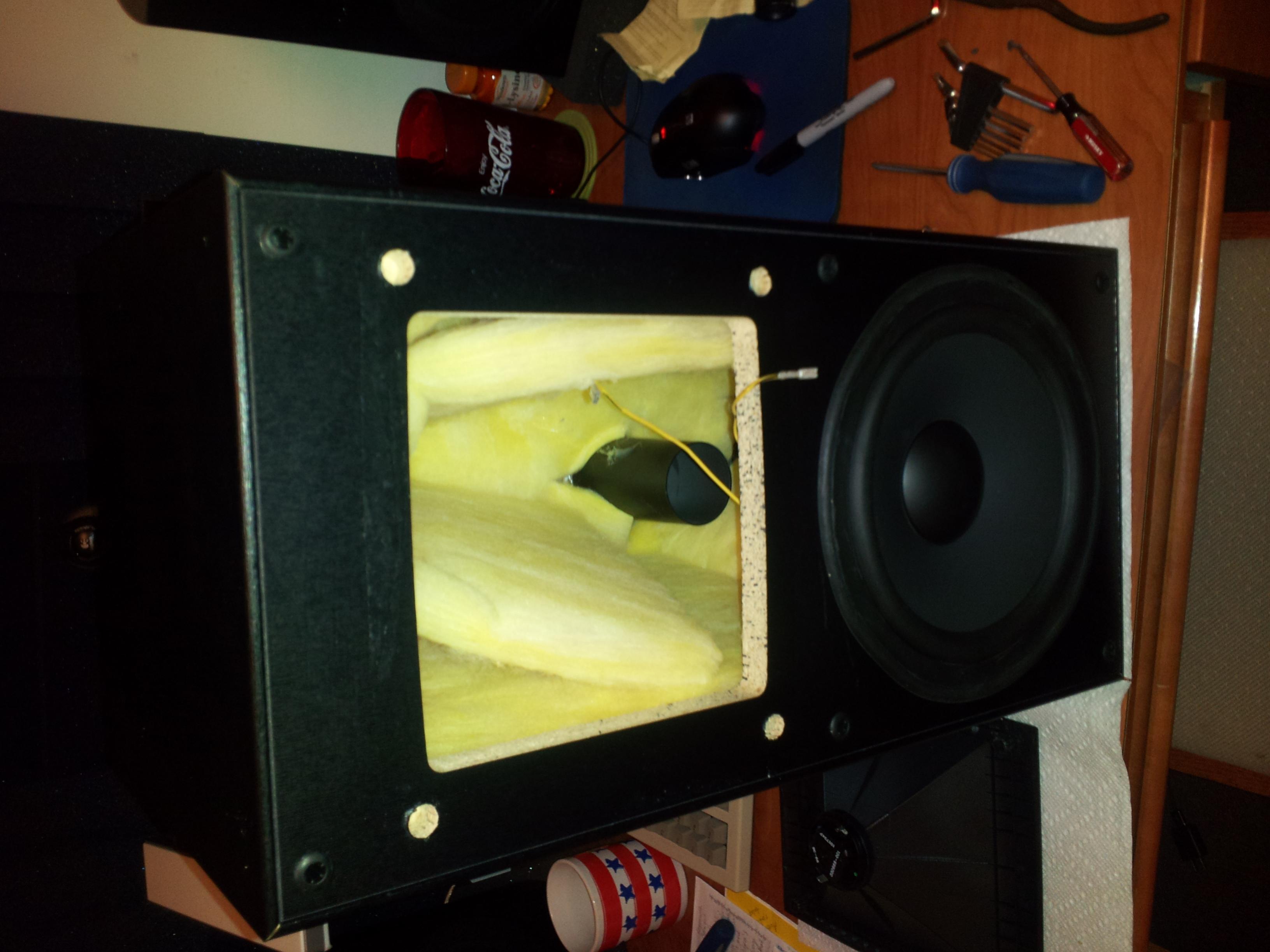

I have both good and bad news... I was able to remove the plastic horn and tweeter from one of the cabinets REALLY easily! It was simply attached with some thick tape. Also, the cabinets look plenty thick and well-built.
The bad news is that I'm left with another roughly-square hole where the horn was. The space measures approximately 164mm side to side and 224 mm diagonally... I could probably fit a 6.5 inch woofer in there with room to spare. The Monacor with wave guide is only 169 mm side to side, so I do not know if I will be able to screw it in without cracking the MDF cabinet.
I'm left with a couple options I guess. I could purchase some MDF cut to size and glue it to the existing cabinet as a mount for the Monacor DT300. I could also look at purchasing a regular horn-mounted tweeter that would fill up the entire gap. Also, if there is such a thing as a tweeter with a larger waveguide, I could mount that in the existing hole. While I'm in there, I could also separate the woofer's compartment from the tweeter's compartment (if you think that matters).
What do you think?
What do you think?

That space is begging for a horn, especially if you want to use these for home theatre.
It looks like the RCF H100 would fit perfectly.
Or if you're on a budget: Pyle Pro PH715 1" Bolt-On Constant Directivity Horn 292-2576
Connect a good cheap compression driver and youre good to go, with potential to upgrade to a higher efficiency woofer in the future.
